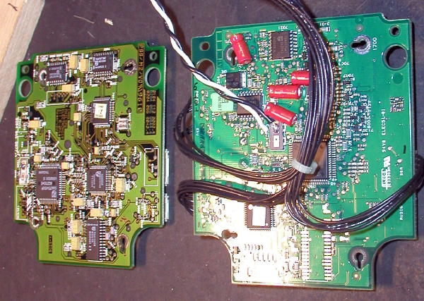

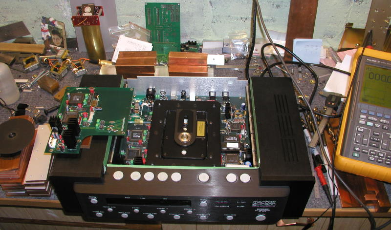

I'm trying to replace the transport mechanism in ML31.5 . Originally there is CD 12 Industrial mechanism in that transport and 33.86 clock replacing the crystal on Philips board. There is another clock for reclocking the output.
Yesterday, I swapped mechanisms (using CD-Pro2 with 33.86 clock connected in a same way), but the transport has problem with reading CDs and there is an error message.
Anybody knows if direct replacement is possible, or do I need to take care of software/clock as well? I will be surely contacting Madrigal as well, but from what I heard so far, dealing with them is not particularly easy.

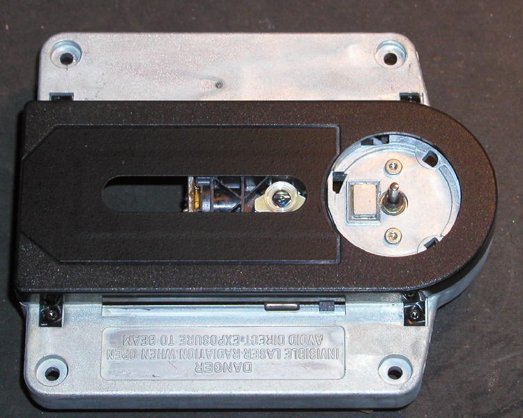

Thanks for the info. I checked how it's done with CDM12 IND, and SELPLL pin on SAA7376 is not connected to ground, so I'm not sure if I should be proceeding with that. I contacted Madrigal and I'm waiting for their instructions.
In a meantime here's how the magnet for the clamp is attached.

I must admit that I'm impressed with a support I'm receiving from Madrigal. I made a phone call today, and within an hour an almost complete schematic of LM31.5 transport was sent to me, together with detailed instructions for mechanism installation and modification. The actual mod says:
"CHANGES NEEDED TO USE CDM PRO2 IN NO.31.5
Remove df80 and attach a 28 or 30 awg jumper from tp2 to df80-3 on the SVI board."
which basically means that 33 Mhz clock is disconnected and another clock signal is supplied directly from DSP.
