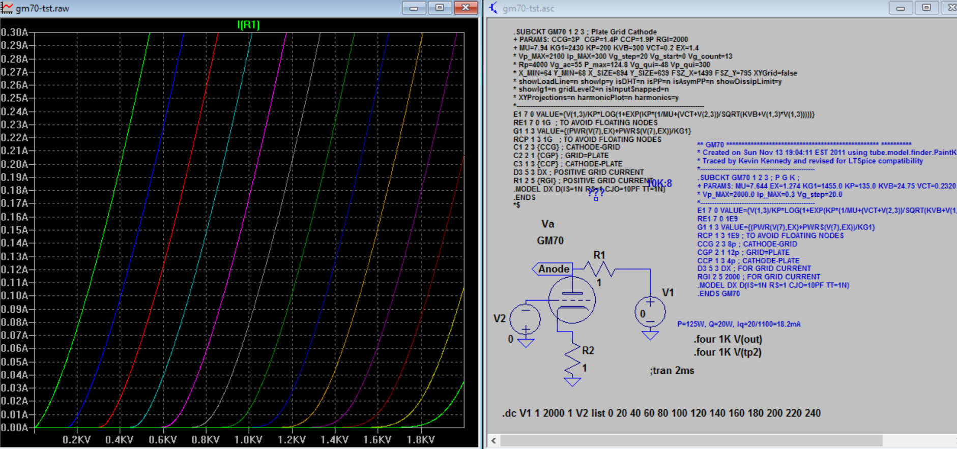

Does anyone have an image of triode curves for the 310A? I've been hunting online, but haven't been able to find anything.
I saw that in there.. Is there a way to draw the curves from the text representation of them? I like a graphical view of the curves to help me with them.
Yes, to reproduce the curve you use a test circuit and DC sweep analysis you need to set the display scale after to suit, refer to the original for scale setting.
Eg dc V1 1 2000 1 V2 list 0 20 40 60 80 100 120 140 160 180 200 220 240
This one sweep anode from 1 to 2Kv and grid 0 to -240.
310a same as 801: 801, Tube 801; Röhre 801 ID15409, Transmitting Triode, air c
curves for 801: http://frank.pocnet.net/sheets/049/8/801A.pdf
Awesome! LTSpice is really quite amazing 🙂 Thanks.
