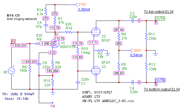

The driver stage , 6SN7 direct coupled to 6FQ7 LTP , is taken by coqsncoqs (a driver stage that he is working with arnoldc for an amp with EL34).
It has around 39.5 db gain . So with 0.5 Vrms input I’ll have 47 V at each output of the phase splitter , right???
Here I have a newbie question. The above means : 47*2=94 V rms from grid to grid ????
According to , Svetlana’s data the SV6L6 PP output stage needs peak 70 V grid to grid voltage or 49.5 V rms . So with an input about 0,25Vrms and without FB I can drive the output stage at full power and have 30W .

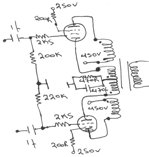

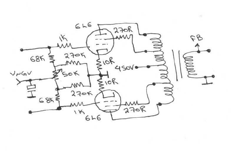

The output stage is designed by me trying to obtain a 6L6 PP UL AB1 at 450V ( Geek’s suggestion) to have Po about 30W.
I’m saying “to obtain” cause ,as a newbie , I don’t know if it’s correct ( Geek haven’t seen it, yet ).
Maybe I’ll do fullish things so don’t freak out!
I have attached the schem , hoping the gurus out there will help me!

Hope the schem is clearly enough.I don't know how to make good attachments,yet!! 🙁

I find it like it is in the attachment file.

If you keep in mind that some of the 6SN7 variants are spec'ed for a plate voltage of 250VDC you'll be fine.
Doing it the other way, using 6CG7/6FQ7s throughout would be the easier way, probably cheaper too.
Arnold_C's input and splitter stage should drive the 6L6Gs without problem.
I didn't redo any math, but at first glance it should be O.K.

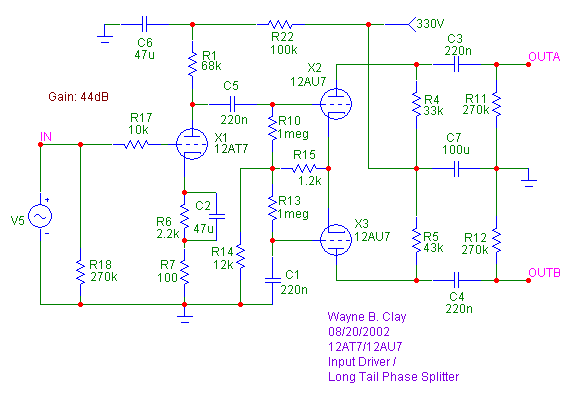

Me neither 😀 . arnoldc wanted (did?) to use a 6SN7 into a 12AU7 LTP. Don't know for sure if he had to do it that way (already had his chassis laid out that way?). My thinking on going with a 6SN7 into a 6FQ7 was if you were stuck into using an octal into a 9 pin noval, a 6FQ7 or a 6GU7/12BH7 would be better than a 12AU7.
See: www.diyaudio.com/forums/showthread.php?s=&postid=473984#post473984

Plenty of DRIVE! More than enough for a 6L6! You'll see basicaly the same circuit in some EICO's and H.H. Scott amplifiers.

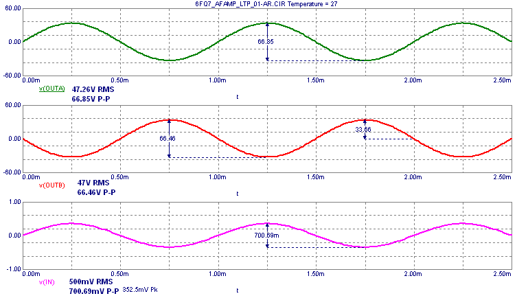

Yup! 66.5V RMS at each output (OUTA, OUTB). 188V P-P, 133V RMS between the two, that's at 500mV input no feedback. That's if my math is correct!

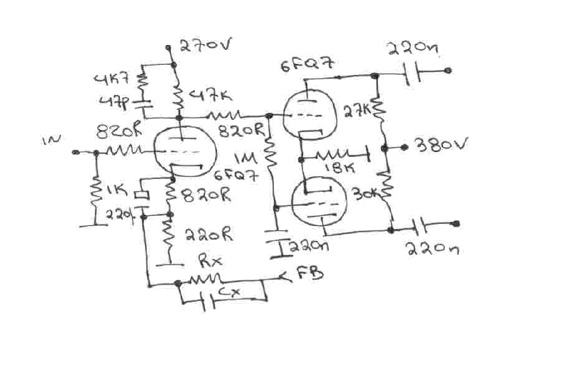

My calculations aren’t the same. Please see again mine ‘cause I’d like to know if I’m thinking right.
With 0.5 Vrms input I’ll have 47,2 Vrms ( gain 39,5 db or 94.4 -as it is in arnoldc’s schem) at each output of the phase splitter . So 47,2*2=94,4 V rms from grid to grid .
The SV6L6 PP output stage needs peak 70 V grid to grid voltage or 49,49 V rms . So with an input about 0,25Vrms and without feedback I can drive the output stage at full power and have 30W .

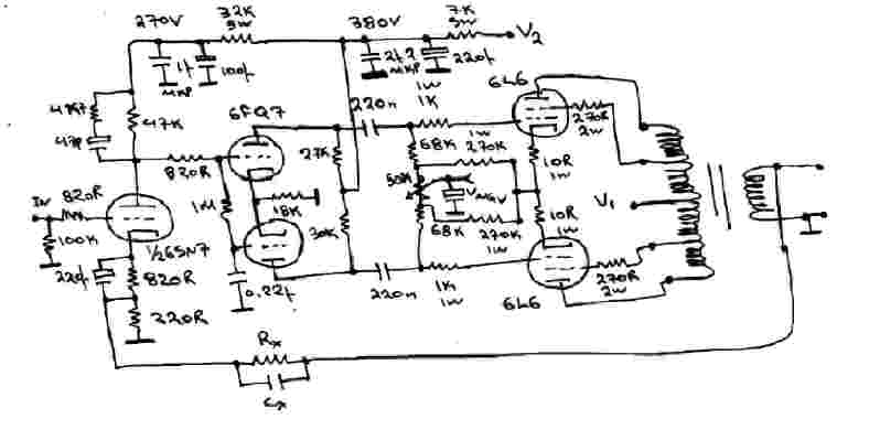

I have redrawn the schem into two separate sections to be more clearer .
Please see the values of components if they’re correct.
Any tips and hints is acceptable!!
I don’t know the amount of FB ,yet. That’s why I’m writing Rx and Cx. I’m designing the PSU write now .Hope to post it today , to have your opinion.

The bias circuit for the output stage doesn't look right, swap (juxtapose) the 68k and 270k resistors on each 6L6. The way it is the driver stage will see about 91k, should be closer to 270k-300k when you swap them around. And make sure the resistors are matched to within 2% or better.
The driver stage... Change the 220nF cap that goes from the grid of the cathode driven stage to 470nF, up to about 2uF max. Too high of value here will cause what's called blocking distortion. This cap will influence the sound of the driver stage more than any other componet, so use the best you can afford at this spot.
Also you have a 1k grid leak resistor at the input of the 1st stage (typo?), should be 100k to 270k, 470k max, depends on what you're planning on driving the amp with!
Oups...
Yes ,typo! 🙂
What about Audyn MKP?

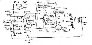

I woke up this morning with an interesting idea. :idea:
What do you say to try an OPT with CFB configuration???Like the famous QUAD??
And bias the 6L6 with CFB??
A first approach on 6L6 P-P CFB output stage. 🙂
I'm reading and reading and...any help?
As a newbie I'm not sure on what I'm doing. 🙁
I'll do some more searches on internet ,books,mags,e.t.c. and I'll post more details later.
I don't know if this schem is correct. 🙁

@resident
You pob don't want to hear this butt... as being a noobie I'd stick with a much easier to impliment (and cheaper too...) PP Ultralinear as a first project. Or maybe even a SE 6BQ5 or 6AQ5!
ooops! My math was right but I somehow forgot that when you put in 500mV for the sine gen, the voltage say 500mV, that's 500mV above and below zero or in other words 500mV pk or 1V pk-pk or 707mV RMS!
So I corrected my mistake and here in this graph explains it:
Wayne 😀
