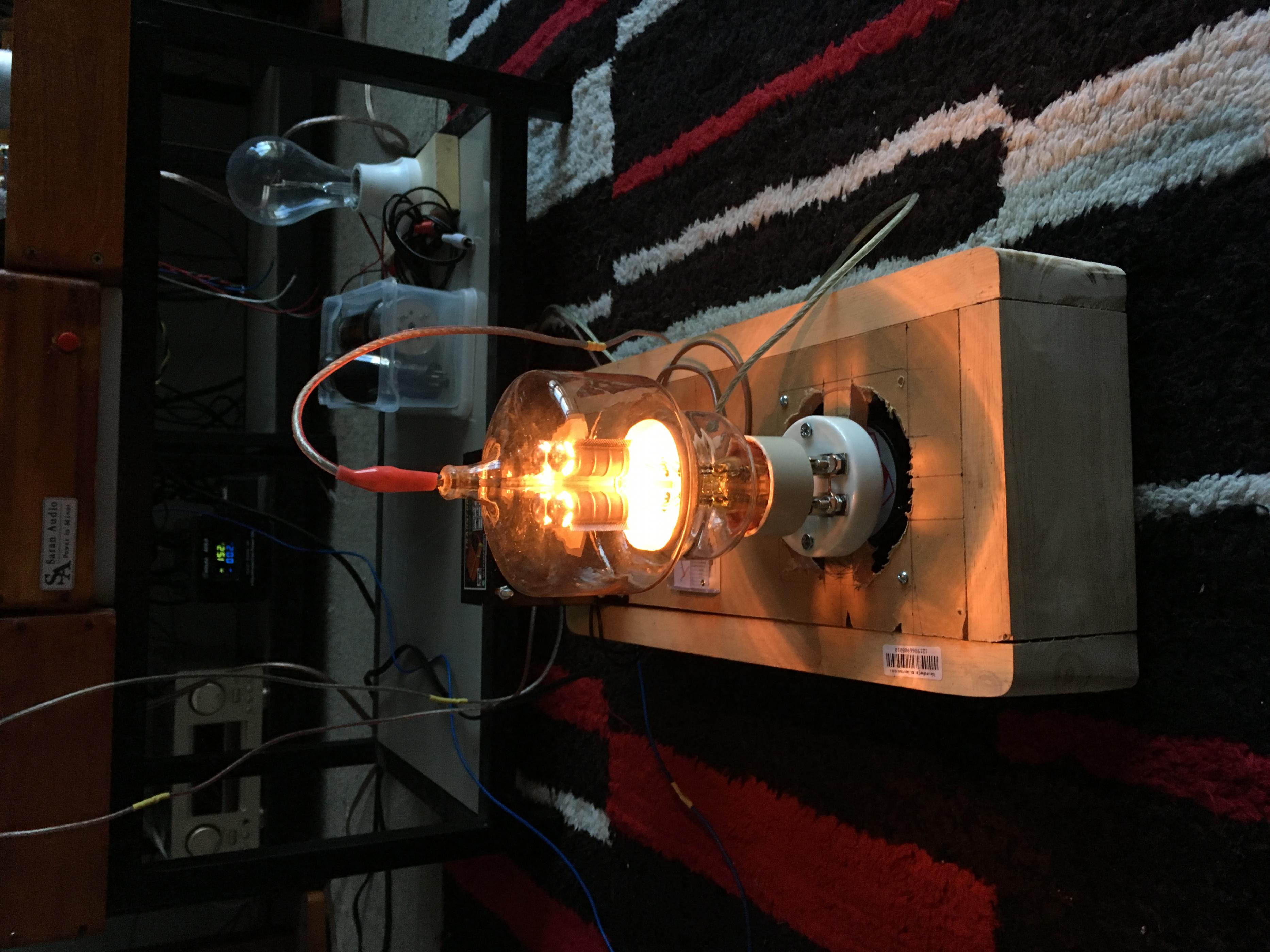

304TL under test

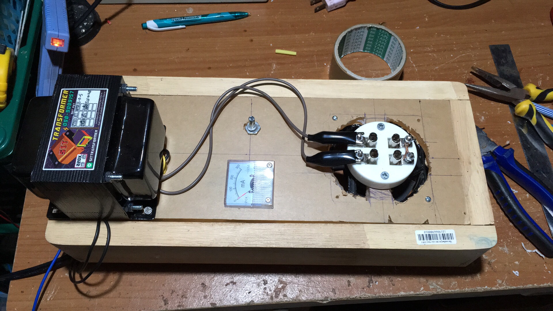

Type 304TL is gettered by coatings on the anode, so the beginnings of a 304TL project need to include a procedure to exercise the getters at red-plate while observing grid current. (I hope that's good enough.) My build partner Iain and I are currently making a dedicated chassis with a coupla meters (for smash) to refresh-getter and test these great valves.
Type 304TL operate amazing linearly into a 5000 reflected Ohm load with the same drive voltage as a type 211 (same mu = 12, but 3 times bigger, and made to win the War).
