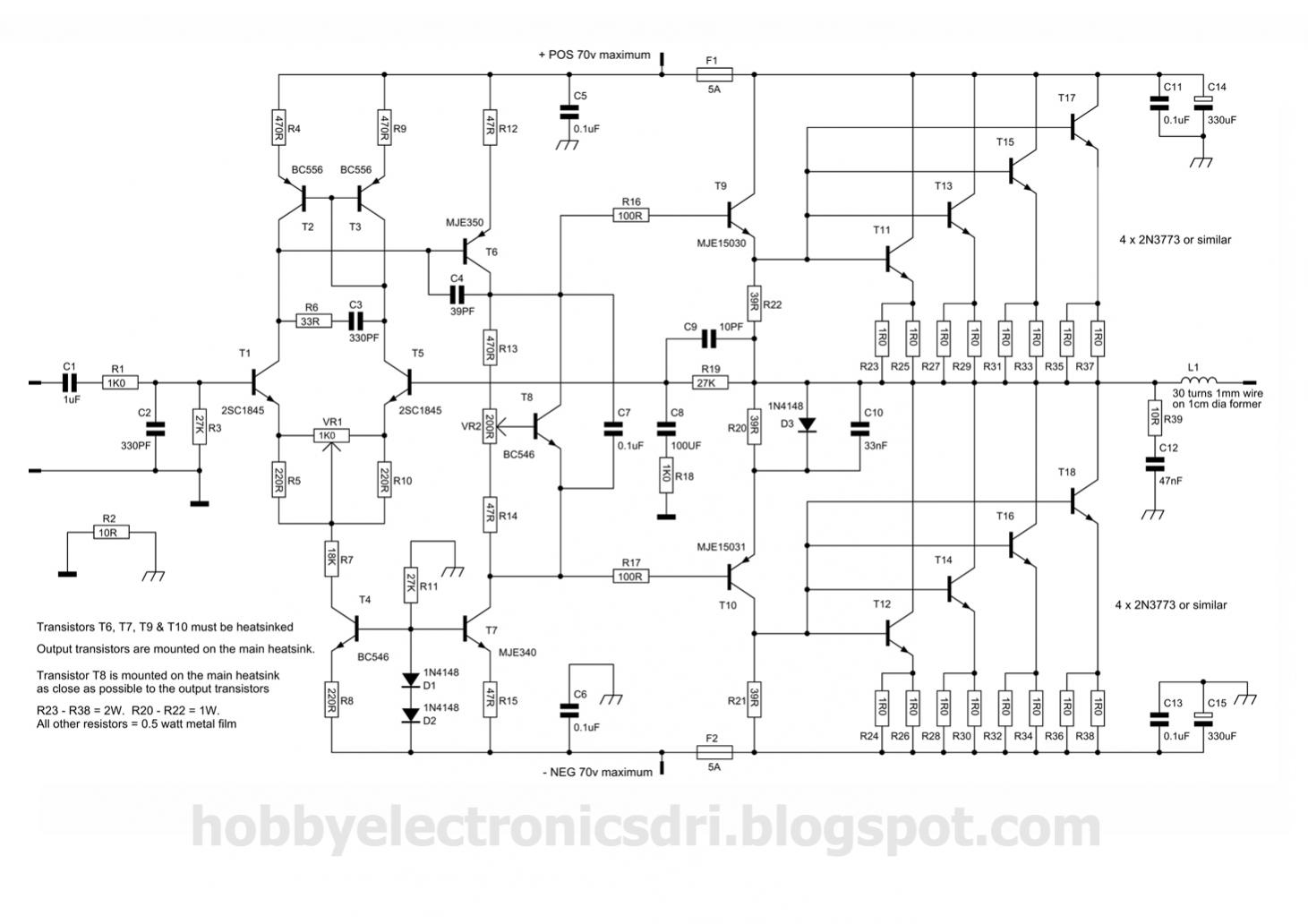

Is that a copy of either of the Quasi's on this Forum?
Refer to the Thread and we can tell you.
It does look like the BJT version of Quasi's

I dont know whether it is belong to this forum or not
but i found this in the website
300 Watt Quasi with 2N3773

Yes Andrew it's "brother of Quasi" or "Nbip" called drawing.

I found this in the website
Emmi, here is the dedicated topic : http://www.diyaudio.com/forums/solid-state/88258-brother-quasi.html and Quasi web page : http://sites.google.com/site/quasisdiyaudiosite/nbip-series/nbip300

OK Well
Now tell me if this can work?

Read the about 50 pages they tell more shurlyas i can.
