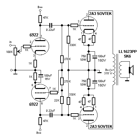

O.K....Here's the one we talked about before, with a paraphase input.
The basic circuit is kept simple, the PS and heater circuit is deliberately kept simple for "economical" reasons. A bit of a cost cutting exercise if you like.
Of course you're free to change that if you like.
Cheers,😉
Cheers,😉

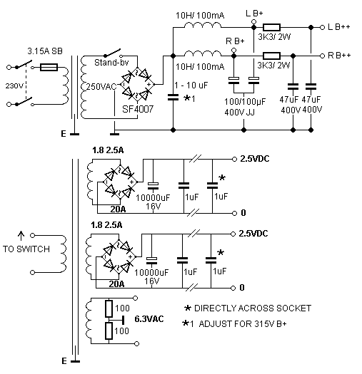

frank, i have that amp on breadboard, but before completing it i was trying to get a DC regulated filament for my other 2A3.
isn't it that the calculation for the DC out is ACV x 1.44 - diode voltage drop?
i have a 3.3V AC that passes through a bridge configured 1N5402 and 4,700uF cap. but under load, it is only 1.6VDC for the 2A3 filament.
now, you schematic has lower ACV for the filament. care to tell me how that works?
If we do the math using 1.8 VAC FWB rectified into a capacitive load we arrive at 2.592 VDC.
The bridge loses about 0.5VDC but I suspect my xformer is about 25% too high on current (not just the heater winding).
When measured I arrive at a little short of 2.3 VDC which is still fine for the 2A3s.
In fact I do have a little advantage here as my bias is more stable and the tubes will last longer this way as well.
3.3 VAC * 1.44 = 4.752 VDC - (2 * 0.6 VDC) = 3.552 VDC
Where you're losing half of the voltage I really don't know.
Did you measure the voltage without the load attached to the supply?
Cheers, 😉
Cheers, 😉
hi frank, without load it measures 3.6VDCfdegrove said:Did you measure the voltage without the load attached to the supply?
Cheers, 😉
what bridge rectifier did you use? i'm ordering BR81 from RS Components.
will i have higher voltage drop with 4 x 1N5402 compared to 1 x BR81? sorry for the newbie questions
ps. i just saw the BR81 specs, it says 1.1VDC voltage drop per element at 4A DC. what do you think of the "per element" spec?
Could you check what the voltage is when only the heater is hooked up to the 2A3 and nothing else?
Obviously something is not hooked up as it should be, I just don't know what.
Sorry to be of so little help, this puzzles me but someone else may see it straight away...I hope.

hi frank, that is the only load at the moment - one single filament and everything else is not connected to the circuit (wires up in the air 😀)

I suspect you're measuring 1.6 VDC at either pin with respect to chassis ground...If you put the pins of your DVM across the heater pins you should measure 3.2VDC.
I used a Philips BR150 or something similar.
In theory that should mean per output. The only datasheet I found so far says "low voltage drop"...Great...🙄
Cheers,😉
hi frank, that is the only load at the moment - one single filament and everything else is not connected to the circuit (wires up in the air )
Cheers,😉
fdegrove said:I suspect you're measuring 1.6 VDC at either pin with respect to chassis ground...If you put the pins of your DVM across the heater pins you should measure 3.2VDC.
unfortunately frank, i'm measuring across pins 1 and 4

Do you have completely separate transformers for them, or two separate windings? I've wondered if getting a separate winding for the driver stage would sound as good as a separate transformer.
I have two custom power transformers, each with a HT winding, a negative bias winding and filament winding for each respective rectifier. From ElectraPrint Audio.
Its more economical to use separate windings; but in my case it was necessary to keep things separate.
If I were to use two windings on the same transformer for two separate stages, I would have two completely separate secondaries with their own center taps.

I have a question about transformers for the 2A3 project. I may go with Hammond output iron, would there be any sonic advantage to using the 30W rated OPT to a 15W rated one? They both have 5K primaries and the price difference isn't much.
And another question: Is there an "optimum" choke inductance value for a given amp power supply? If so, how do you calculate it?
Thanks!
Thanks!
BHD, which hammond model are you talking about? 125ESE and 1628?
i have both and used them i various circuits. when the smoke cleared i ended up with MagneQuest DS-025 (2.5K) on my 2A3, Tamura F-475 (5K) on my Gemini amp (45/2A3 primarily 45), 1628 (5K) on my 807 amp, and now the 300B is left with the 125ESE (as has been bugging me to get him a Tango U-808 😀)
i don't have the equipment to make measurements, but i got best bass from the Tamura. but take this with a bucket of salt.
the 5K will not be optimal for the 2A3 but will give you less distortion albeit lower power. i think it is the 1627 that gives you 2.5K tap.
for chokes i have used Tamura A-395, a Hammond 193J and various custom-made chokes from a winder here who was doing transformer winding for Xerox when they are still here in the Philippines. sadly, i don't know how to compute
i'd leave that to the experts here 🙂
edit:
gee, you are making a PP 2A3 so the 5K is perfect. sorry.
