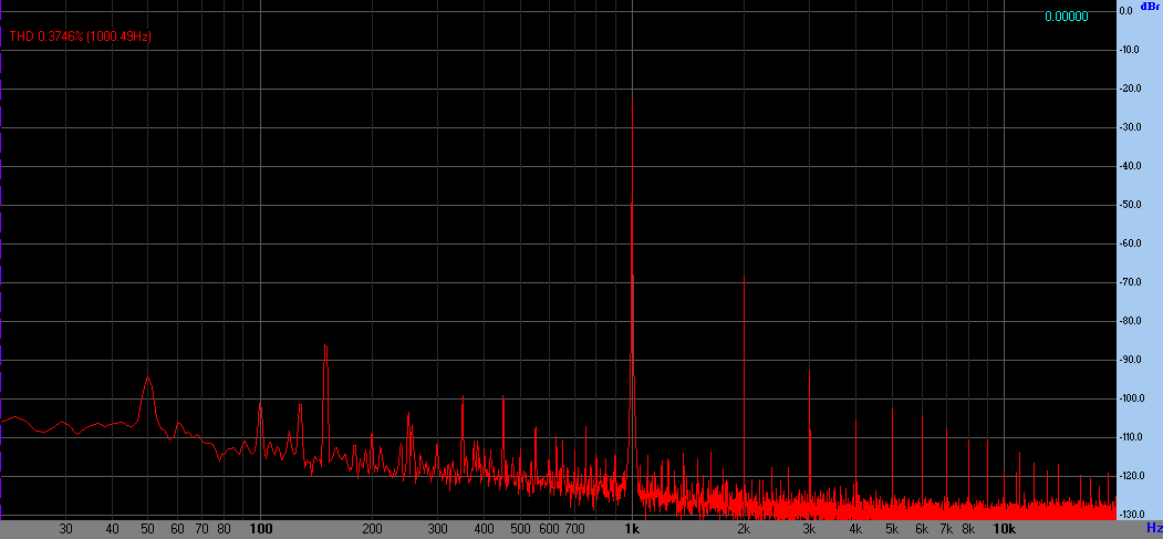

Ii my experience D3A is an excellent driver tube on paper but have some irregular harmonic distortion decay.
I have opposite experience.
D3a, LED bias, 10mA CCS, 70V RMS out.
Reactions: aroS3
5th, 7th, and 9th harmonic have an excessive level compared to 4th, 6th and 8th.
E810F triode strapped does not suffer from this problem.
But this I discovered a little too late, after buying several dozens D3A...
anybody loving D3A wants to buy some at a bargain price? 😀
But this I discovered a little too late, after buying several dozens D3A…
You're funny! The 5th is [(93 - 22) = –71 dB] lower than fundamental. This would be inaudible even with sine waves, let alone program music content. The 7th and 9th are even lower.
Do try to recognize the difference between an observation and a result, dear CiroMarzio. The 300B is an outstanding tube to build upon. Magnificent.

Take a look at my 300B SE with interstage. It works with a D3a as driver, but I changed to ECC88 with parallel triode units (sounds better to my ears). My unit has parallel 300B for more power, but the circuit will work fine with a single 300B if the OPT impedance is right (which will be the case for you, as you already have a suitable OPT).
Very Nice blog! you are in Zürich? I am in Thalwil. It might be interresting to meet and share ideas some time. 🙂
