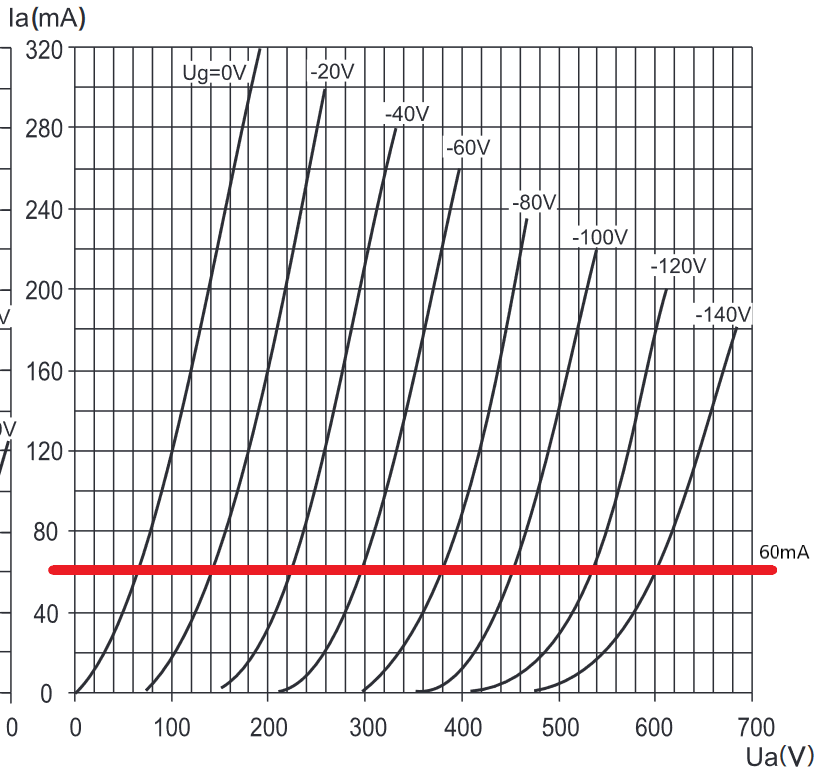

Here's the typical output characteristics of a JJ 300B.
The horizontal line means the plate current you'd like to use. The red line means 60mA.
And you can find the corresponding plate voltage and grid bias.
For example we select Ua=300V then the intersection point means we need Ug=-60V to meet the 60mA target Ia at Ua=300V.
With desired Ia=60mA and Ug=-60V, the correct resistance value for the self bias resistor should be R=|Ug/Ia|=1Kohms.
The main HV should have at least Utot=|Ug|+Ua=360V. Usually the primary section of the OPT will cause a voltage drop of about 10Volts, so the main HV should be 370Volts then.

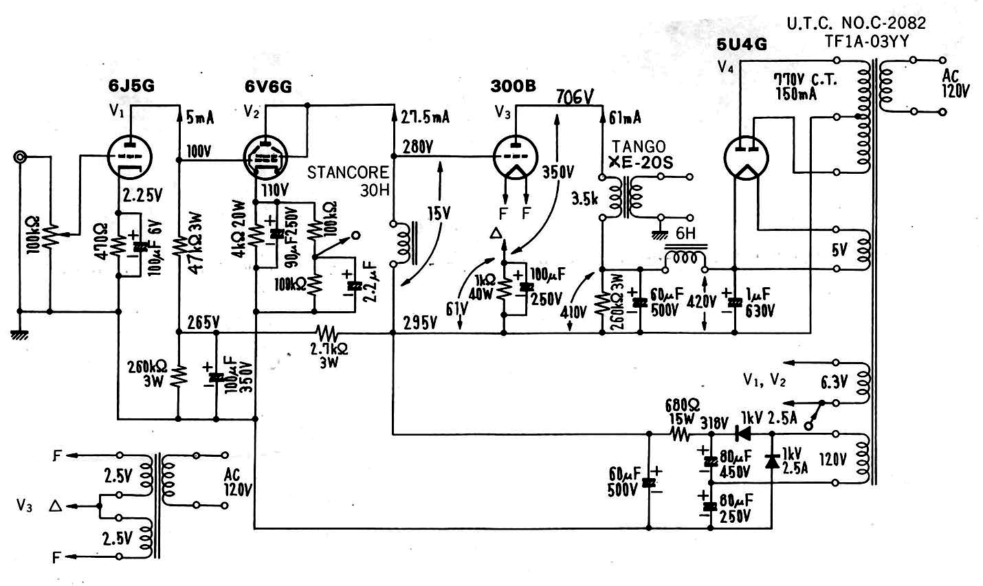

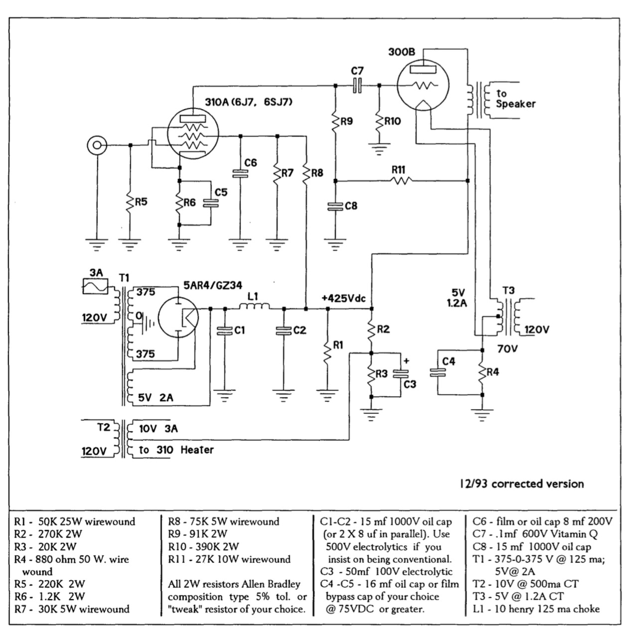

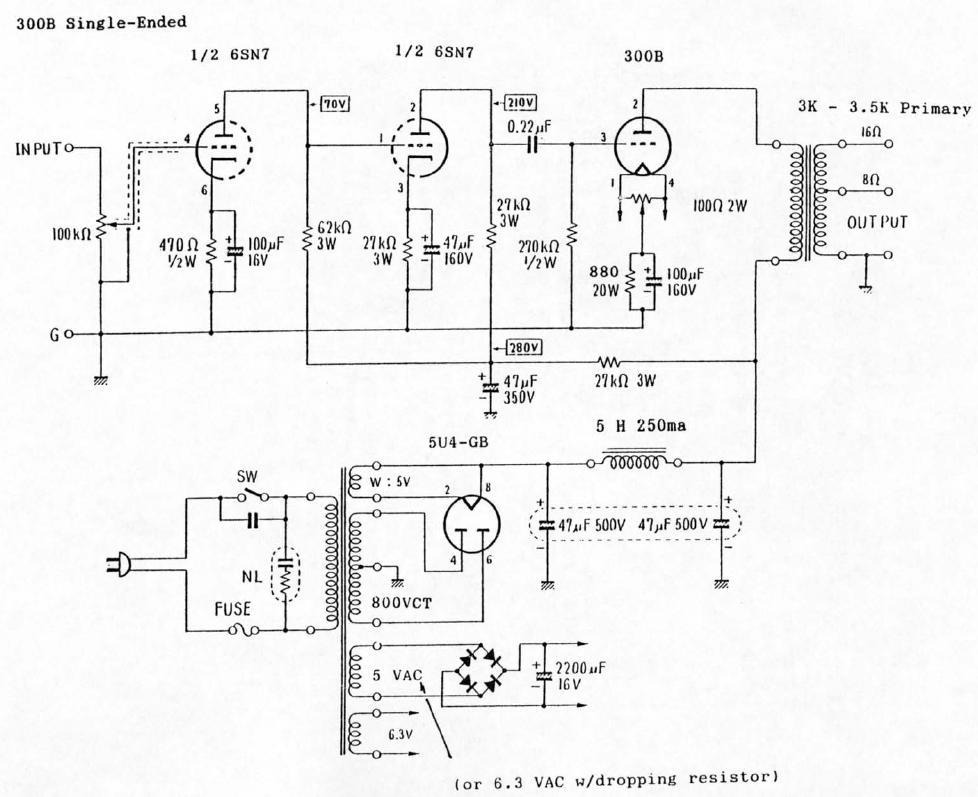

Attached is a schematic of a circuit taken from that forum. (for a different output tube I built the Komuro front end used in it using the two sections of a 6DN7 and it worked great.)
Also attached is the archived page from the Magnequest website in 2004 giving figures for those transformers being used well above 60mA. (SO don't limit yourself before doing some more research.)

Would you advise me, please?
Thanks in advance.
K.
The second schematic is the classic Joe Roberts version of the WE 91A from Sound Practices magazine. That's the first amp I ever built, with FS-030 output transformers. It's a great amp. That was almost 30 years ago, and my wife still talks about those monoblocks and why I didn't stop there. ;-) Wish I still had those FS-030's but I moved away from SE amps and "loaned" them to a friend. They're still doing service somewhere back East. ;-)
