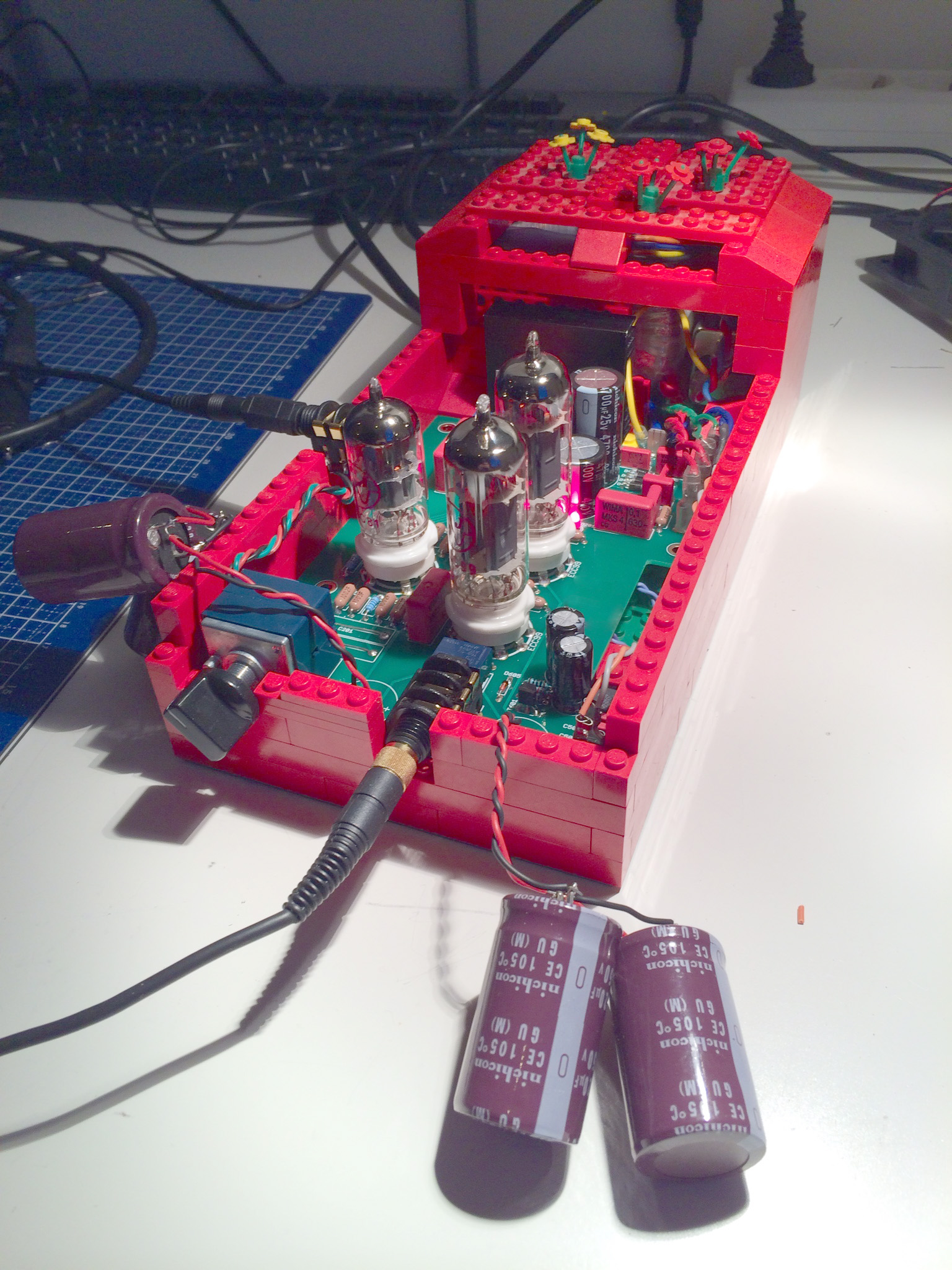

Even funk's Lego OTL looks better than the Velvetizer, might even sound better...😛
Thanks! I appreciate it 😀. And costs a sh#tload less too.
