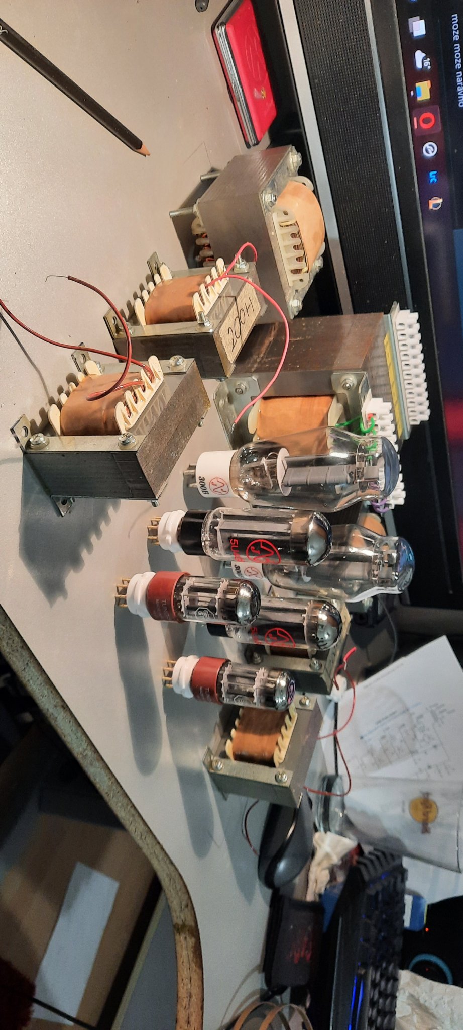

Hello!
I need some advice on building this 300B, I have made the case but need recommendations on top and bottom plate of my case for the electronics(I was thinking brass). Also would like your input on how I should do the wiring, I have made the layout for parts and wiring. In the attached files there are the schematics and layouts. Cheers!

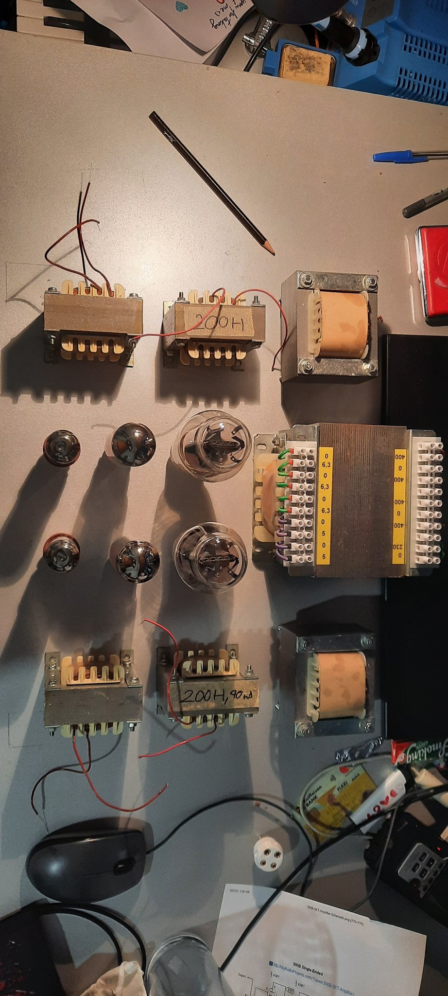

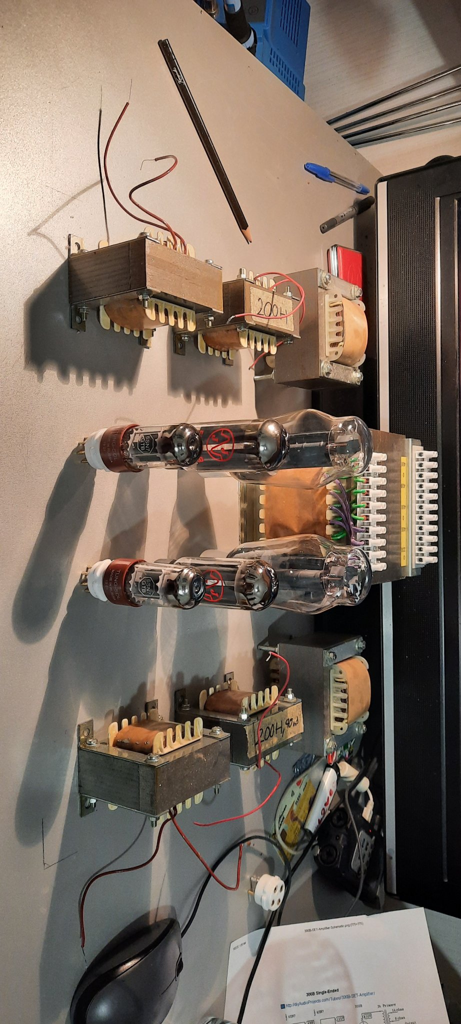

I have watched this but the problem is I have 4 chokes and my power transformer is bigger, Look. So do I put the chokes in the amp? How should I orient my chokes and where to put the tubes? I was thinking about putting the cokes underneath the top, put the 300B infront of the output transformers, put the 5UGB4 Infront of the power transformer so the AC circuit is as small as posibble and put the input tubes 6SN7 infront next to the pot. I just found so much information about the hum and don't wanna make a mistake here 😛
Well the schematic only has one 200H choke per channel, no I'm unclear as to why you have 4. And yes you can mount them underneath, but they should be rotated 45-90 degrees from any adjacent transformer.

The 5 Henry B+ chokes have the greatest magnetic field, Keep them far from the output transformers, and at right angles to the output transformers.
The power transformer is probably the next greatest magnetic field, keep them away from the output transformers, and at right angles to the output transformers.
The 20 Henry chokes need to be kept from the output transformers, and at right angles to the output transformers.
The video of Steph's amp shows a good example, and hopefully you can imagine the orientation of the coils of each of those parts.
It is the orientation of the coils that is the "at right angle" I am talking about.
Or, you can look at the laminations and see what is the proper right angle orientation I am talking about.
Good luck on having a low hum, low distortion amplifier that sounds great!

The lamination thing I want to ask you about. If there is a proper angle between them can they be closer?
