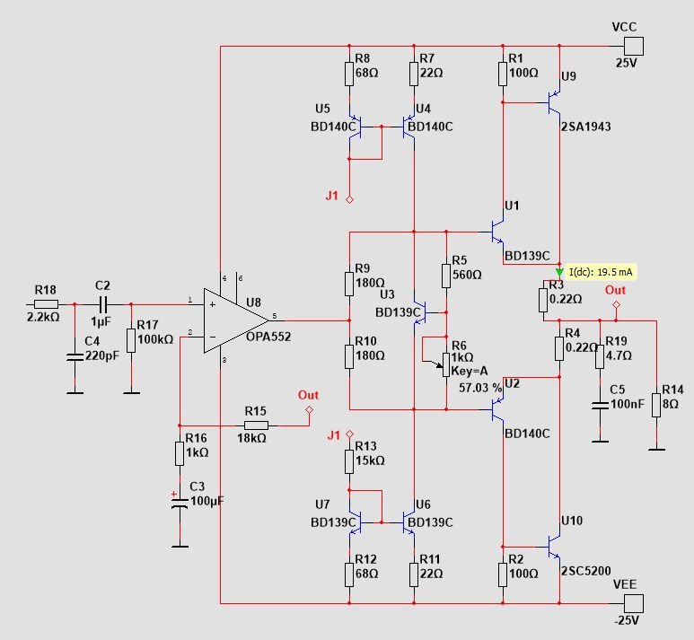

Bias should be like 19.5 mA for best results.
Then the simulated THD is 0.00013% at 1 kHz 1 Watt into 8 Ohm.
The output uses 2SC5200/2SA1943 in Sziklai configuration.

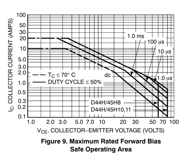

But datasheet tells D44/45 has max collector current 10 A.
And peak current 20 A.
These are high values.
30 Watt output is peak current 2.73 A.
So I have no fear D44/45 will be blown.

Transistors designed for high speed switching operation often have poor SOA's. These appear to share that limitation.
I speak from experience. I designed a very nice-sounding amplifier that used fast switching transistors. It sounded very nice but I got tired of replacing blown-up output transistors.
Look at the SOA graph. Second breakdown limits start kicking in (with a vengence) at a whopping 10 V. Tried +/-27 once, never again. Worked beautifully at +/18 as an upgrade of TIP41/2.

Ya, 10 Amps at about 3.5V. I learned about SOA and secondary breakdown about 50 years ago.
At 25 Volts D45H11s are good for about 800mA, but capacitive loads will draw peak current at zero volts out, ie ~3A@25V. I would not run any TO-220 over 40V total (+/-20V). Also remember that your OPs are going to get hot, even with a good heat sink so derate the 25C power rating by about half. Also, no OP protection is dangerous, unless you like constantly rebuilding your amp. If you don't want to add protection, use very large transistors. When I was young, these mistakes were common, and amps blew up all the time. Today, Silicon is cheap so don't waste your time on < dollar power transistors.

I have changed output transistors to SC5200 and 2SA1943.
See new schematic in post number 1.

Like I said, tweeter amp. A couple of good kick drum hits into a 30 degree load and poof.Look at the SOA curve for a 1ms pulse. A 1KHz signal fits that bill.

What is interesting is the low bias level in the Sziklai output.
Only 27.2 mA was found to be optimal for lowest THD.
I have updated with a new version in first post.
The emitter resistors in the output is now 0.22 Ohm.
