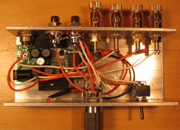

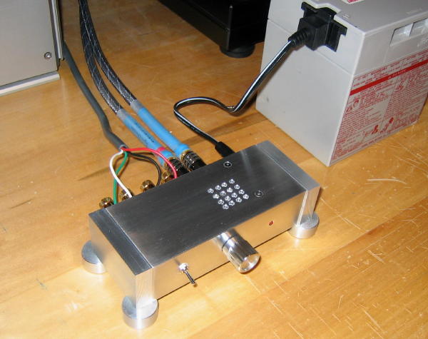

Well I moved this from the Digital section since this one didnt exist then. I finally upgraded the Sonic Impact and I must say Im shocked at the quality of sound. I replaced the plastic chassis with Al, used Cardas RCAs, decent binding posts, and hooked it up to a 9.5AH 12V battery. The original input was a mini-jack that routed the signal around the board until it got to some cheesy wires that attach to the pot. I removed the jack and ran the inputs directly to an RS pot (100k alps). I also removed the entire wiring mess that ran between the board and the pot/switch. And while I was at it, I replaced all the original wiring, except for the light.
All in all I must say this is a great sounding amp. Ive listened to it on my Stax headphones for hours at a time and never got fatigue that is often the case with SS amps. The sound is somewhat dry BUT extremely articulate. Crisp with zero sizzle. Metallic sounds are superb. Cymbels, cow bells, and percussion in general are great.
Im going to hook up the high efficiency speakers next and see how it fairs on them.

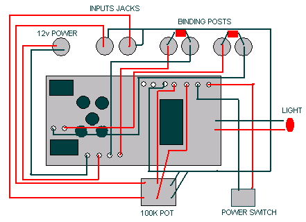

I finally have taken my Sonic Impact apart in an attempt to create a beautiful amplifier like amt has executed so well above. (This is my very first DIY project.)
I can hook up almost everything from the excellent internal photo amt supplied above, however:
I see that the Sonic Impact board has connections for the potentiometer/power on cable labled:
" V + R L G L R "
I'm guessing this is how the connections are made (in the order they appear):
"V" = (I don't know on this one.)
"+" = to one side (positive side) of the power switch
"R" = from the right input's positive connection thru the pot and into this R
"L" = from the left input's positive connection thru the pot and into this L
"G" = to the other side (ground side) of the power switch
"L" = from the left input's ground connection thru the pot and into this L
"R" = from the right input's ground connection thru the pot and into this R
Is this correct as I don't know how to hook these to the Radio Shack potentiometer? These connections are my only remaining obstacles.
Can someone tell a newbie like me how to wire the potentiometer and on/off power switch to these terminals?
Thanks,
Robert
Hi Robert
Heres what the wires are: ( V + R L G L R)
V and + = power into and out of the power switch
R = right signal input from pot
L = left signal input from pot
G = common ground to both channels
L = left signal input to pot ( abandoned)
R = right signal input to pot ( abandoned)
Heres a diagram that should help. One word of caution though: be very careful de-soldering and soldering around all those SMDs. Too much heat or stray solder will raise heck with the board and components.
Thanks for the complement on the chassis. Ive built three of these for friends and may produce some for sale. They are fabricated of architectual aluminum channel 6063 and 6061 bar and round stock. Ive put this on temporary hold since Im working on a CD-ROM transport chassis at the moment. I will probably offer it with or without inexpensive components and pre-drilled holes.
amt
nice chassis notwithstanding , .. how(if) did your mods change the sound?
I think that the sound was improved in that it was "cleaned" up . I have another SI on the way so I can do a side by side comparison but for now, memory has to suffice. I feel that the soundstage widened and that the bass response is deeper. These may be due solely to the big battery and "clean" 12v. The overall clarity was increased as well and that I attribute to being able to use good quality interconnects/jacks rather than a crappy mini plug to rca adapter cable and a slight pot upgrade. The mini plug ran the signal around the board, to the pot via micro wire and then back to the board, along side the power wires that also ran to the pot. And shielding by metal vs. plastic must have some effect. Once I listen to both together, I can give a more accurate and concise answer.
amt
