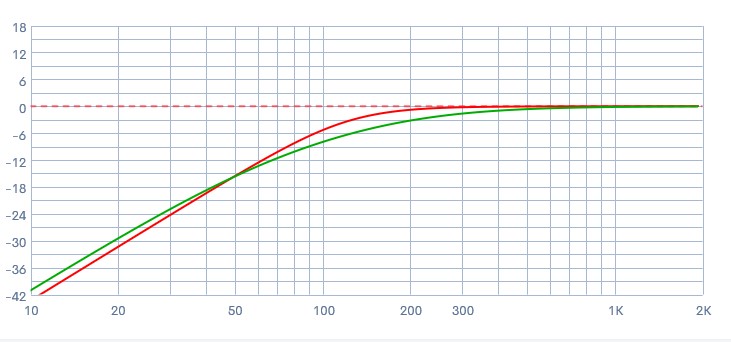

Looking at the sims, the Kartesian starts to drop quite early from 300Hz with -3db, it doesn't really fit into a sealed box or actually any reasonable box that I simulate.
It looks like a nice driver for small vented boxes, my bluetooth speaker could do with one if they weren't so expensive!

My Sica coax have almost the same thiele parameters and measures almost the same as your sim. I eq bass/mid centered at 700Hz, q=1 with 3.8db (dealing with rising response at the same time) and shelve it up 6db from 176Hz. I get them flat to 100Hz...
It's temporary due to limitation of subwoofer but it' works for now. I don't see why you wouldn't be able to use a smallish coax 2-400Hz.

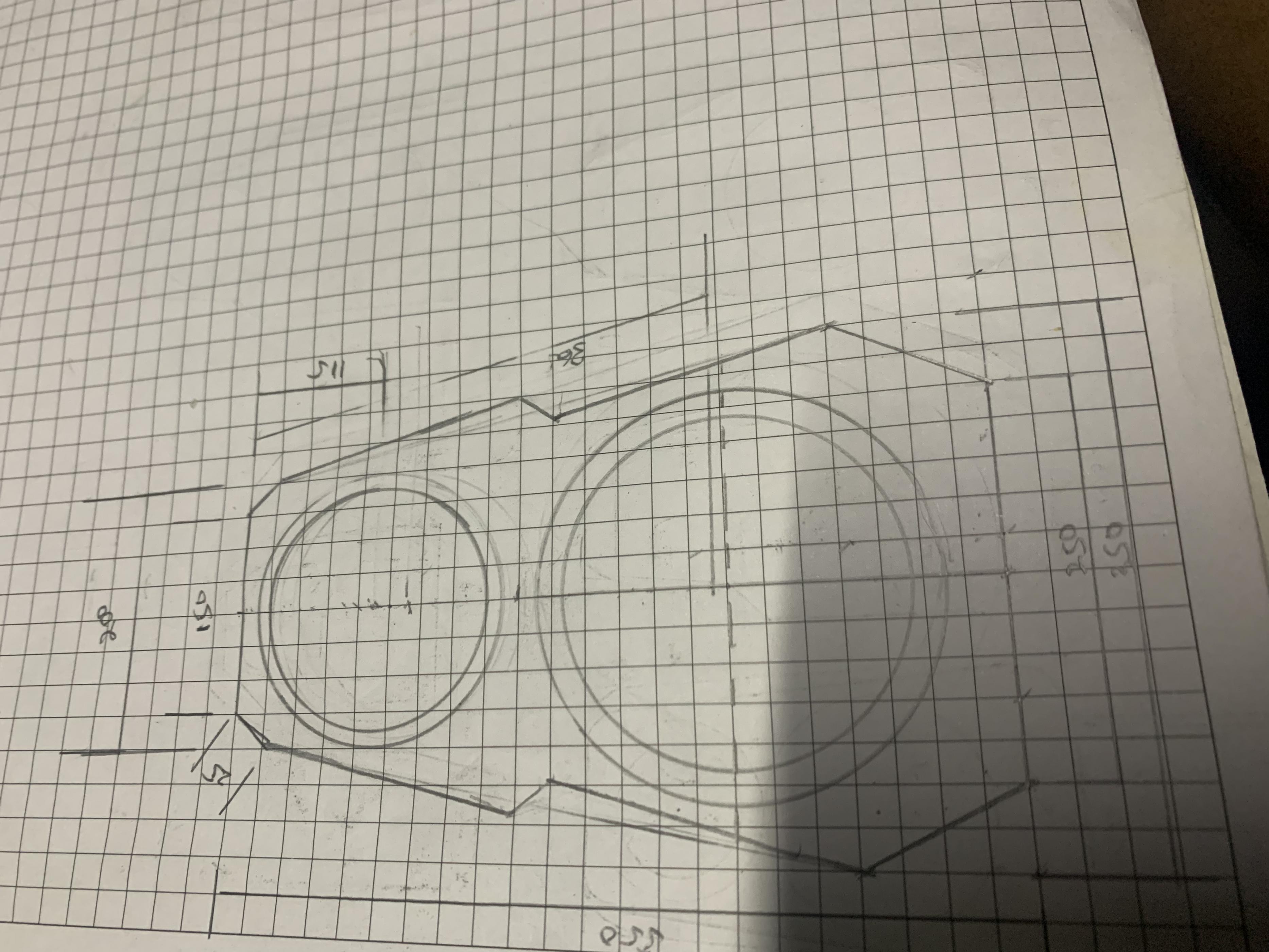

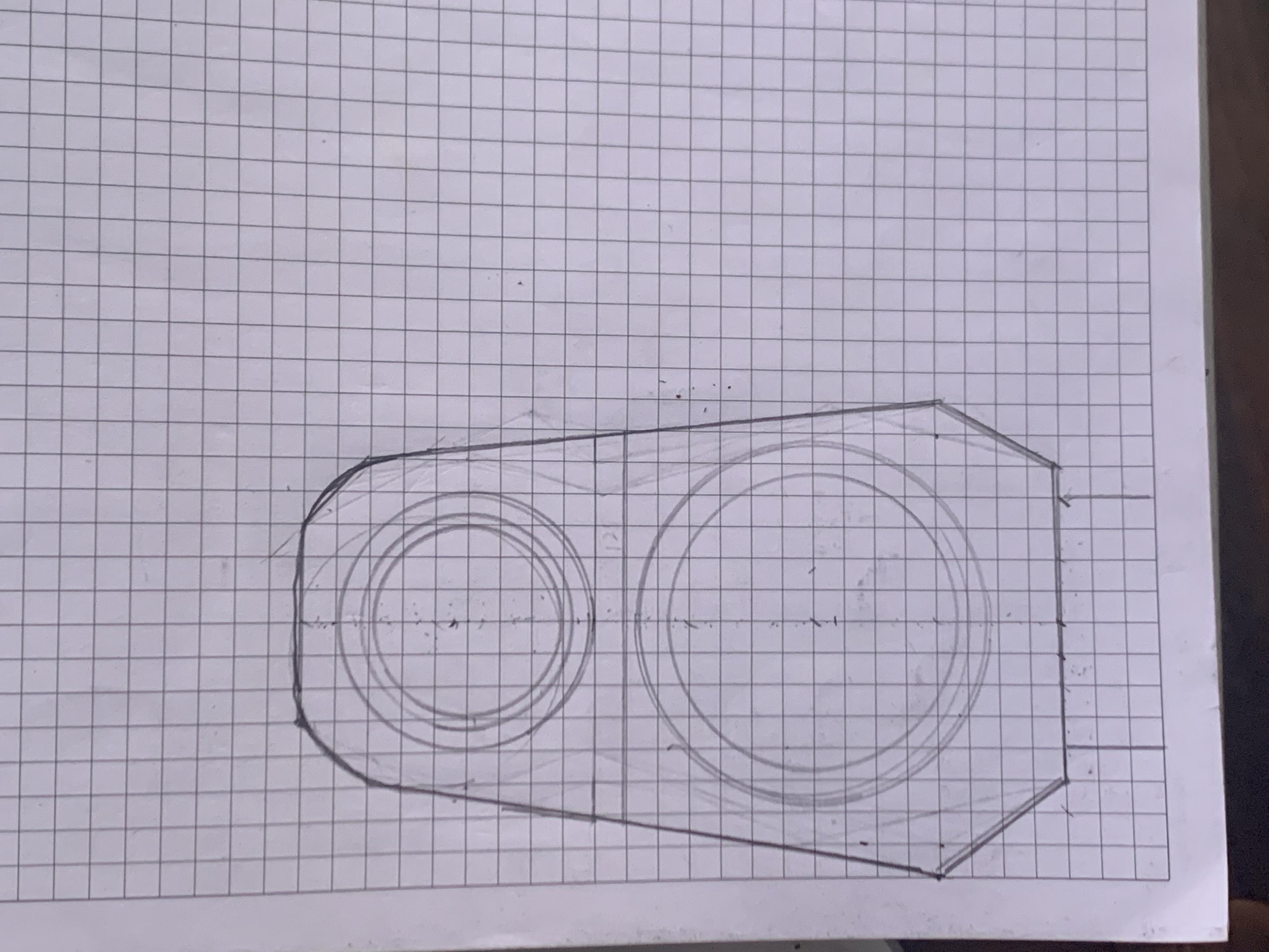

3ways active speaker seas c18en 002/ accuton s280-6-282
Hi I building 3ways speaker using seas c18en002 with accuton s280/6/282 .
I have own accuton s280 and hypex fusion 503.
11liter for seas and 39 liter for close box for accuton.
I need help for accuton and seas crossover point .
Appreciate for any input suggestions.
Cabinet design are 24pcs plywood sandwich and front and rear panel will be use solid teak .
Best regards
Jack

With Hypex FA503, you can easily try out different xo points and slopes. I think the main thing is to reduce the excursion of the mid driver. With a driver layout like in your sketch, you can achieve a desireable 1/4 wavelength distance with a xo point between 300-400Hz.
That would minimise the xo lobing and reduce the excursion of the mid (probably) sufficiently.
Also the Accuton woofer can probably deliver it's range very conveniently.
Thanks deni09 . Original kingRoy speaker cross 200 hz and I will try with 300-400 Hz .
