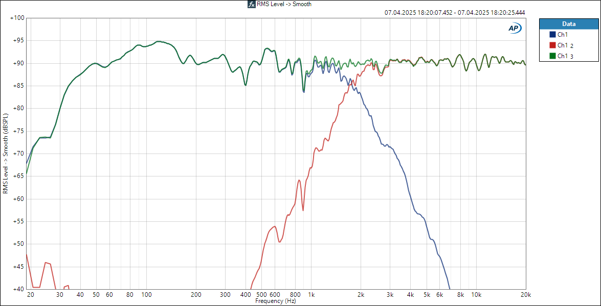

I just built a speaker with MW16TX and T25B for a customer. These Textreme membranes are great and "get out of the way" - but you don't get the sound of a 3" hard membrane midrange.I've just decided against to take a M74A as mid between 2x10" in CB and T25A tweeter I already own because I realized that I have no use of the available headroom and better save the money; bought a MR13TX now instead for half the price.
@paco de colonia I did an (active) crossover 2nd order at 2,5kHz with the T25B in this project - and got a perfect acoustical 4th order crossover point at about 1,8kHz! THD at 90dBSpl is in the 0,1-0,2% range in the crossover zone.
As you are SPL limited with your 10" anyways the T25B will have the best resolution and off axis behaviour and is probably to prefer over the T34B - until you really need a lower crossover frequency.
I have a lot of experience with these Blisma drivers and I'm located in Austria - write a message if you want discuss more details.

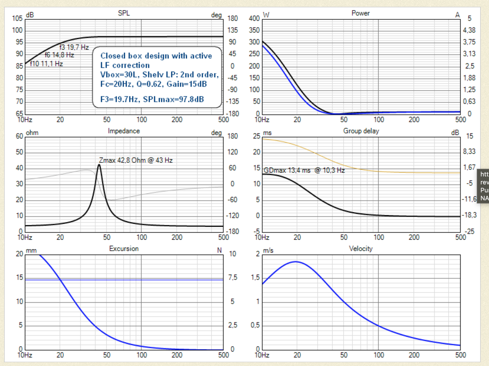

p.s.: If you have the chance to EQ or use an active DSP crossover - I would for sure recommend 2 closed 10"! How big is your listening room? Can you freely position your speakers? And yes, the Purify 10" should give the power of a good 12". That's why I use 12" for half the price ;-) but the smaller footprint of 10" has it's benefits.
Btw - these speakers go loud, the tweeter had no sweat to achieve these levels with music at 1,5m distance. It's crossed over at 2,5kHz electrically, no overload.

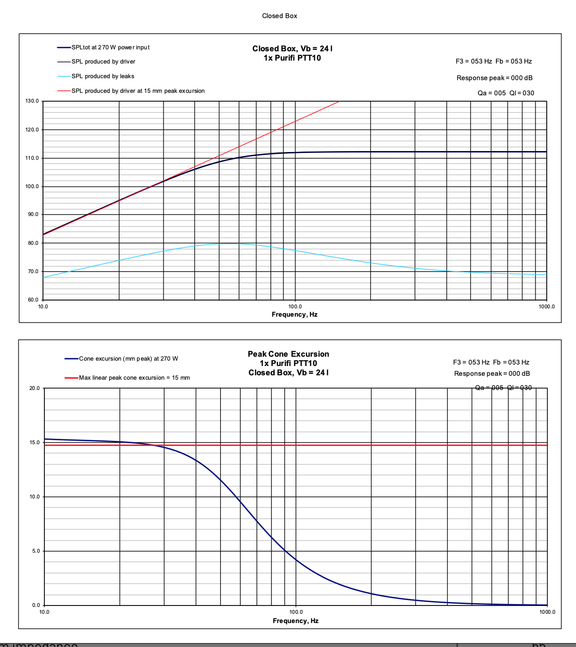

In @HiFiCompass review of the PTT10 he modeled a closed box (though with gain at the low end) as:
In my (rudimentary) modeling, it seemed (without low frequency boost) that 24L sealed gave a Qt of 0.5. My thinking was that I could boost from there (or not in the context of multiple subs):
So perhaps you could meet your volume goals.

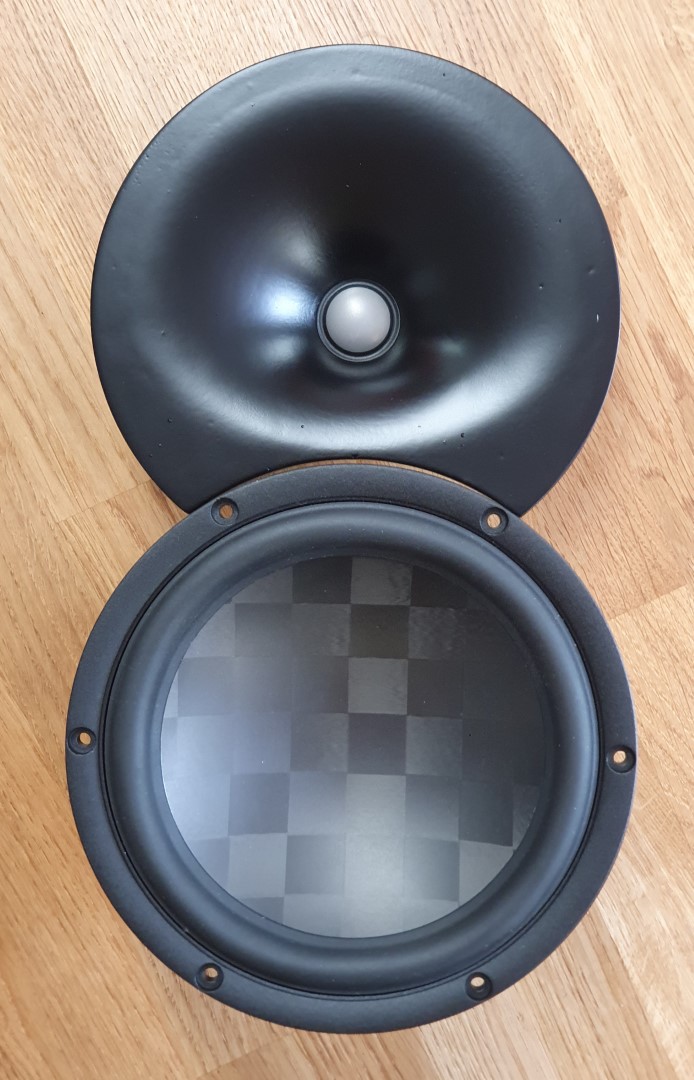

MW19TX and T25B in Waveguide here. Both should be able to do about the same SPL level (used in home cinema with subwoofer) and waveguide should fit off axis sound together. Now go WO24TX and T34B.
WO24TX has half the membrane weight as Purify 10". THD is really low but still 6dB higher as Purifi.
8R Version needs 36L closed with Qtc of 0,7- you should be able to put 2 of the WO24TX-4 in 60L closed.

Waveguide center to TMT is 53mm. Radius of MW19TX is 94mm. 147mm.I note that you cut out the WG to allow closer C-C spacing. Could you tell us the XO frequency and C-C distance?
