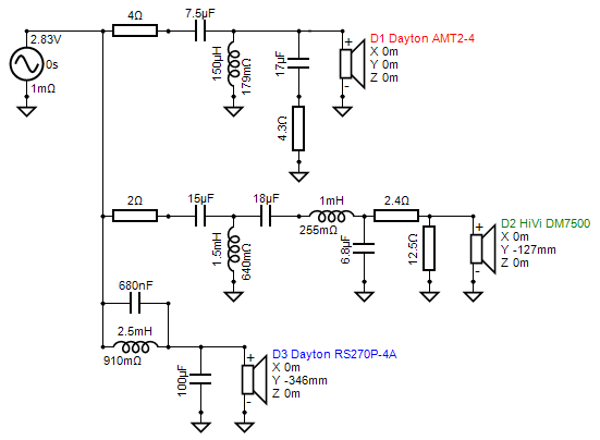

Greetings from India. I am planning to build a 3 way speaker in which mid duties will be assigned to a dome midrange. Here only HiVi dome midrange drivers are available as of now and the driver models are HiVi DM7500 and HiVi DMN-A. Here are the links

I have planned to cross the midrange with the woofer at around 700-800 hz ( which might be needed to be stretched around 1000 hz in case of HiVi DMN-A). The midrange to tweeter crossover point will be around 4000-4500 hz.
What are the difficulties which may come in case of dome midrange and crossing it over with the woofer and tweeter? My tonal preference is warm detailed midrange and smooth detailed highs. Please help me with your experiences and suggestions which will be much appreciated. Thanks in advance.

There are three things at least.
With passive crossover the peak at resonance reduce the slope of the crossover (can be fixed by inpedance corrections)
Try crossing over at 1.5 the resonance frequency so 1200 or 500 Hz for the 2" and 3" dome respectively
The small size of the domes compared to midrange cones (4"-5") make them have both a wider radiation pattenrn than a cone and the tend to run out of steam at their low range.
The crossover will not work if you use a textbook one. Try simulation software like Xsim and find out how tricky it is beforehand!

Yes definitely the drivers will be measured after mounting them on the baffle of the enclosure and then I have plans to simulate in vituixcad. Thanks for your response.

The HiVi DM7500 is pretty nice. (I'm sure the 2" is too, but haven't heard it directly.) It can crossover as low as 500 Hz (if you really need it to), I crossed it over around 680Hz to a Dayton Audio RS225P-4 10" woofer. It probably needs to crossover to the tweeter around 3.5kHz or lower but that shouldn't be a problem for the tweeters you are considering.

Thank you for your response. How is the frequency response and details retrieval? I was reading about the same driver in Midwestaudioclub and found that the experienced builder who also built a 3 way with an 8 inch woofer, didn't find it easy to work with. Which order crossover you used while crossing it to the Dayton woofer? Does it need any impedance correction near the fs while crossing it to the woofer?The HiVi DM7500 is pretty nice.

The sound quality is very nice and detailed. The builder at Midwest Audio Club liked the tweeter quite a bit, but yes it is probably harder to work with than a smooth 5 inch cone woofer.Thank you for your response. How is the frequency response and details retrieval? I was reading about the same driver in Midwestaudioclub and found that the experienced builder who also built a 3 way with an 8 inch woofer, didn't find it easy to work with. Which order crossover you used while crossing it to the Dayton woofer? Does it need any impedance correction near the fs while crossing it to the woofer?
I used something close to 4th order acoustic slopes. I did not do anything with regards to adjusting impedance around Fs but I crossed pretty high. I'm pretty sure the designer on MAC did, but he was also crossing over lower (around 500Hz if I remember correctly).

That's really informative. If there's no problem, will you please share the crossover schematics? You may omit the values of the components used.I used something close to 4th order acoustic slopes. I did not do anything with regards to adjusting impedance around Fs
