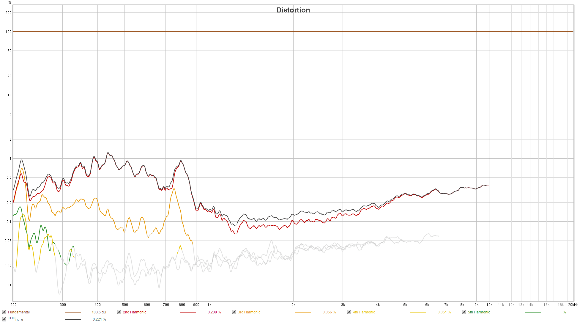

How is distortion?
Would you mind sharing how you simulated this in AKABAK?
How is distortion?
Copying what I wrote on audiosciencereview: "Due to the measurement distance (3 meters) there is substantial room influence, even for such a big room (REW cannot gate distortion measurements), because of this the distortion measurements are very corrupted below 200Hz (in fact you can see it in the measurement I will post here at ~220Hz). This is measured at a level of 95dB.How is distortion?
2nd order distortion is a little high from 300-600Hz, however this is perceptually benign, and still falls below the worst case masking threshold. All other orders are extremely low. The spike in distortion at 800Hz is a resonance in the midrange driver, I do not think it deteriorates sound quality meaningfully. Above 900Hz distortion is practically nonexistent."
Additionally, it seems there may be some QC issues with these drivers (or QC tolerances are not the highest), because I have had 4 pairs which all measured quite different in terms of distortion (and all varied a bit in exactly where the ~800Hz resonance was). The driver in the other speaker does not show that 3rd order distortion spike at 700Hz, for example, and has somewhat lower 2nd order distortion as well. In any case I think the distortion is low enough to not be worrisome, particularly at my 70-75dB average listening levels.
