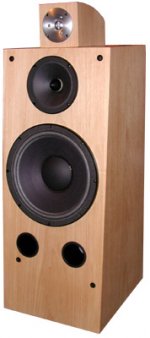

Hi, with MC115 it looks like you wont need any tweeter at all, or maybe only a supertweeter above 10khz, maybe even placed on the back - but it might not be wise to cross MC115 at 800hz with only 6db - Fs is very similar to a normal quality tweeter, but it is bigger and handles low frequencies better - but 6db/12db is not that hard
This maybe a little oversized but at least it's been designed buy a speaker shop in France so you don't have to worry about crossover issues :
Dimensions h x l x p ( cm ) 90 x 36 x 40
HP Grave Beyma 12B100R
HP Médium Beyma 6MI90
HP Aigu Beyma T2030
Pente d'atténuation filtre 12
Fréquence de coupure (Hz) 380/5000
Efficacité (db) 94
Bande passante ( +/- 3db ) 37 - 20000
Principe de charge BR
Puissance RMS 150
HP Aigu Beyma T2030
Efficacité (db) 94
Puissance RMS 150
