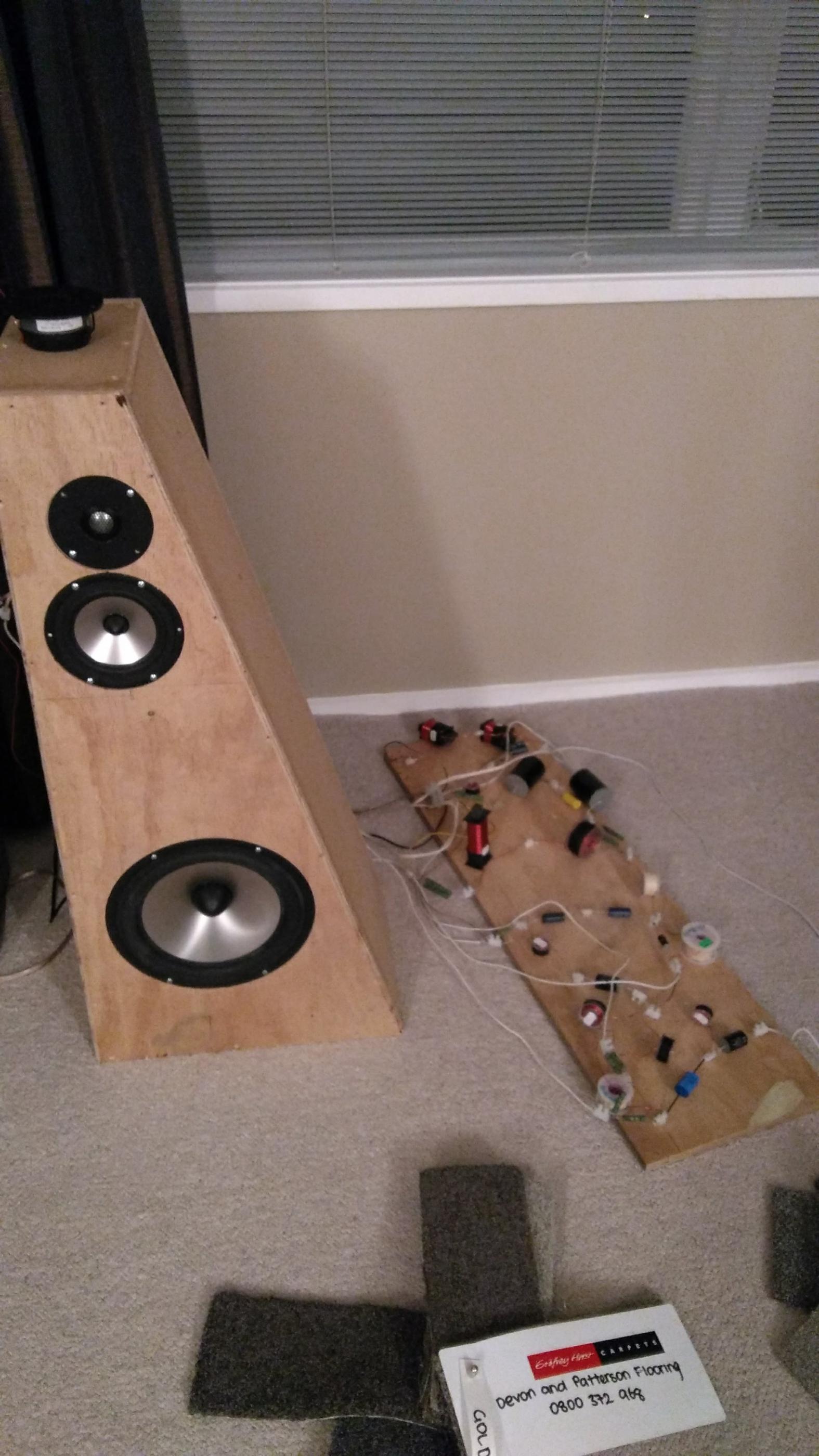

Interesting discussion. The mid-to-tweeter crossover here was one of the key challenges I had to tackle with the Darbari: The Darbari | DHANDANOUGHT.ORG | TCPIP which I built in 2014. Active xo with a MiniDSP 4x10HD. It's still one of the best speakers I've heard, as per my personal tastes.
I didn't have money for Seas drivers, but I used Dayton RS metal cone drivers whose breakup is as nasty. I used the RS150, and did a 48dB/oct crossover at about 1500Hz to the Peerless HDS soft-dome tweeter. It's worked out beautifully -- no distortion, harshness, glare. A lot of warmth, including when playing slightly hard pieces like strings, trumpets, violin, etc. Just a fourth order isn't good enough for this kind of cone breakup, IMHO -- you need to get the peaks down 70dB below the base line. I could do that for the RS270 woofer with a 4th order because I had many more octaves to play with before hitting the cone breakup. Not for the mid. I had read the 70dB remark in Jon Marsh' descriptions of his Dayton RS Modula MTM, some 8-9 years ago, and I've tried to be conservative about that cone breakup ever since.

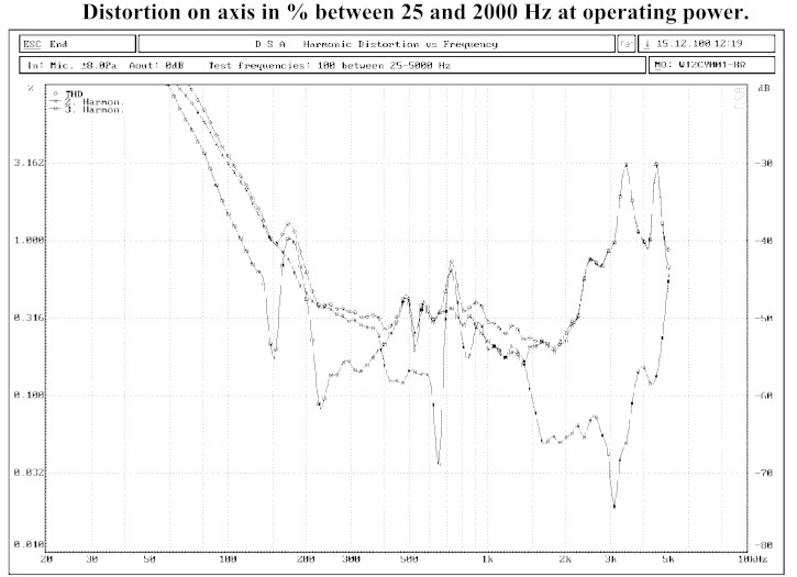

Strange there are so few who have made a TM of the Excel W18E001 and the Millenium tweeter. On my current Odins i have the upgraded xover by Jimangie, that made the speakers much better overall. I am now leaning towards remaking the Odins cabinets according to Seas specs with the upgraded xover i already have, and adding a 100 liter ported W26 sub for each channels also working as stands...
Long time ago SEAS published the THD figures on it's datasheets. I own several W12CY's and would not use them substantially higher than 2kHz. My own measurements are more or less the same like the ones formerly published by SEAS. Beware of THD's of metal domes at frequencies > f_conebreakup/4 ... this is not a select problem of this driver.... Seas Excel magnesium cone midrange for this 3-way, I'd suggest the 4.5" W12CY instead of the 6.5". The cone breakup immediately gets pushed out to much higher frequencies, and you can actually hope to use your midrange like a midrange. ...
On who's paper? Have a look at... The 5" Nextel cone midrange seems superb on paper ...
SEAS M15CH002 (E0043) | HiFiCompass
The H2 peaking @ 1.1 ... 1.2kHz does not really seem appealing to me
Yes, I learned a new term from Jon Marsh and gang over at HTGuide: resonance distortion amplification. Yes, you're right, a lot of the metal cone drivers show this problem.Long time ago SEAS published the THD figures on it's datasheets. I own several W12CY's and would not use them substantially higher than 2kHz. My own measurements are more or less the same like the ones formerly published by SEAS. Beware of THD's of metal domes at frequencies > f_conebreakup/4 ... this is not a select problem of this driver.
So, this means that even if I use the W12, I guess I'll have to cross over fairly low.
I hadn't seen this data. Yes, it seems strange and I'd hesitate to use it as a midrange.On who's paper? Have a look at
