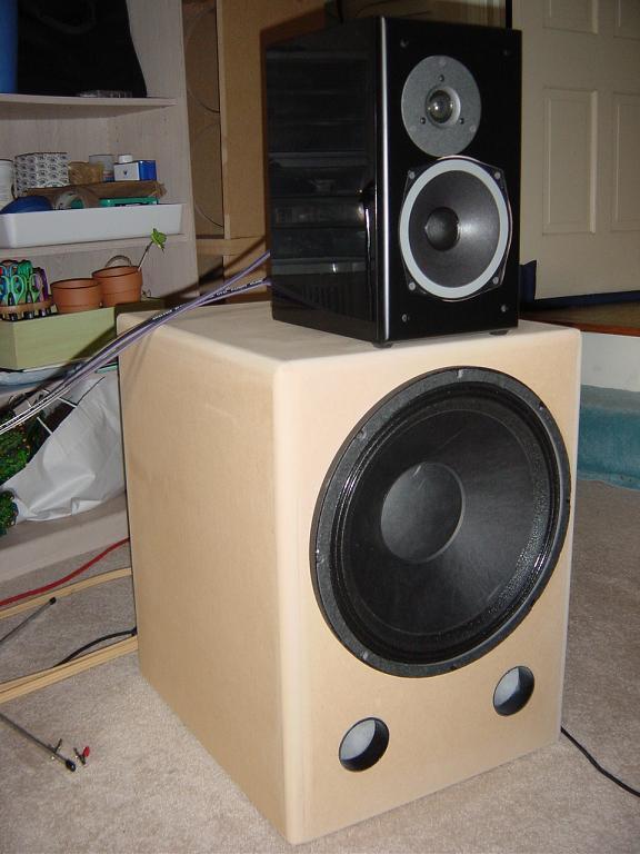

Hello,
For those interested, here is a photo of my latest three way….
They uses the Morel Supreme 110 tweeters, the PHL 1120 6” midrange drivers and the Eminence Kappa Pro 15LF-2 bass drivers.
The tweeter / mid cabinet is an off the shelf Parts Express unit. The bass box is a 110L ported box...needs some finish 🙂
These speakers sound wise are the best I have come up with so far.
Branwell

Yes, the crossover is a Behringer DCX2496 Digital unit with an ATI 1806 6 channel amp and a custom built 6 channel volume control that goes between the Behringer and the amp.
Branwell

Hello Taco,
The tweeter is rated at 91.5db per watt. If we accept that as a reference then……
The mid range needed a full 6 db of baffle step correction. No surprise given the location in the room and the size of the cabinet. With the baffle step correction, the midrange matches the tweeter exactly needing no boost or reduction.
The bass needed 3db of baffle step and with that, needed 1 db of overall boost to match the mid and tweeter.
Given this, if you did a passive setup with these drivers in the same basic cabinet layout, you would be looking at at around a 91db per watt system.

Btw.Branwell, the bass box is real nice. I planned to make something like that but the current financial conditions ain't good, so I have to wait a bit.

Akunec,
That project was about 5 projects ago and given I’m going from memory, this info might not be all that accurate.
The bass to mid was in the low 300hz range, somewhere around 325hz with 24 db LR slopes. The mid to tweeter ended up somewhere around 2700hz with 12db LR slopes ( tweeter to mid polarity reversed ). There was also some time alignment, but I cant remember the exact delay.
For the most part, the only non baffle step related EQ in the system was for the breakup mode of the woofer ( notch filter EQ ) and a slight rise in the midrange ( shelf filter ) at a freq I cant remember ( I want to say the rise started at 2000hz ).
