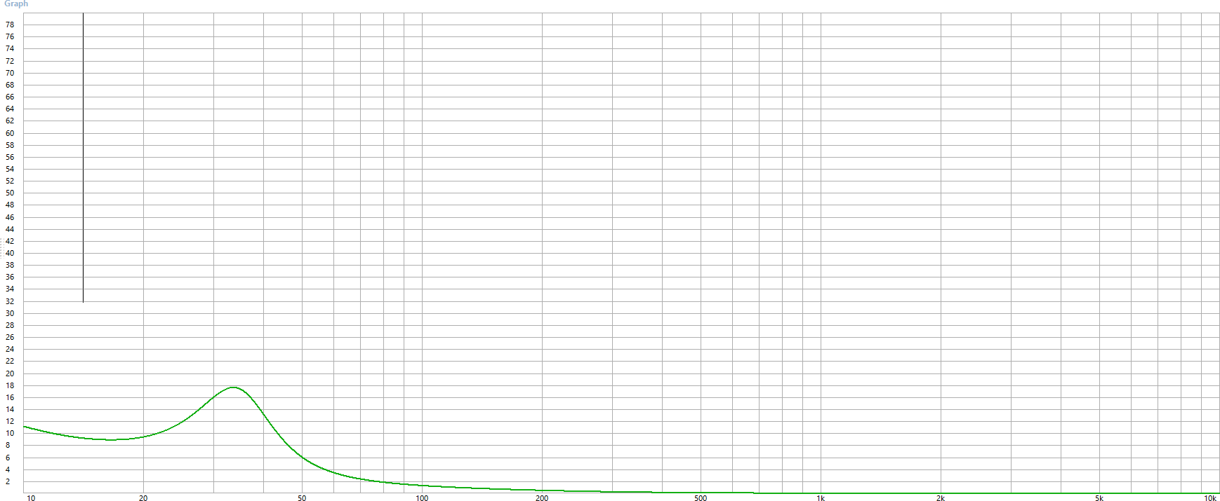

A few simulations in Winisd:

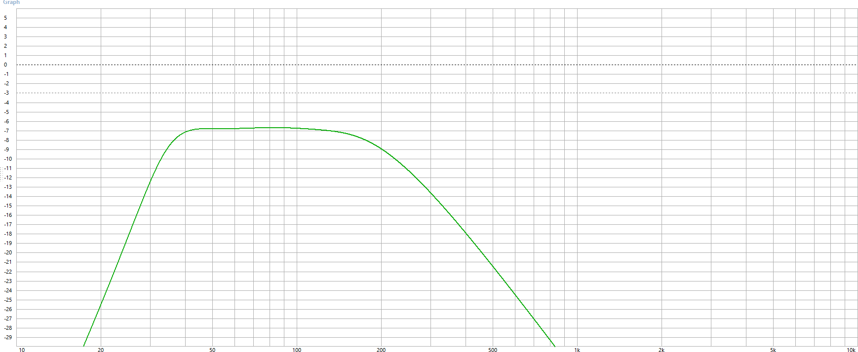

2*beyma 15p80fe in 250L tuned to 35Hz
Response

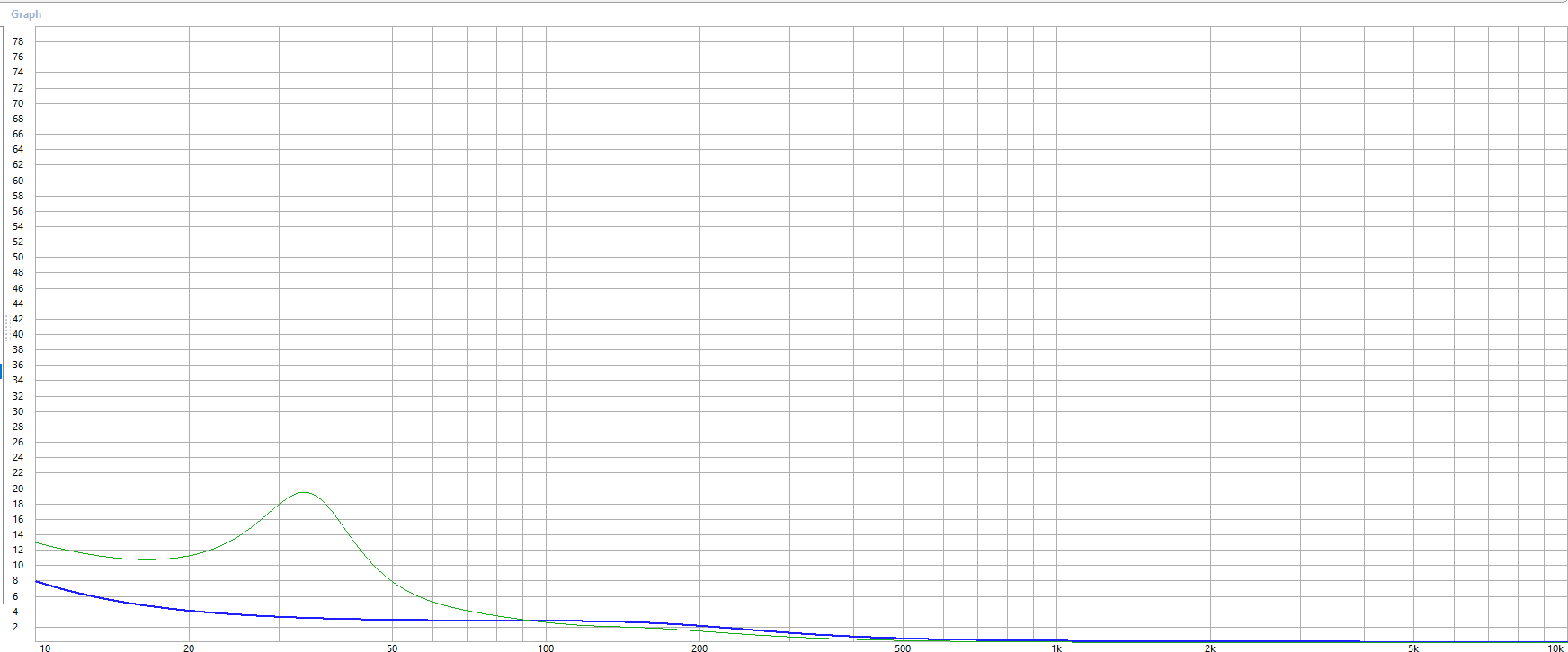

Group delay

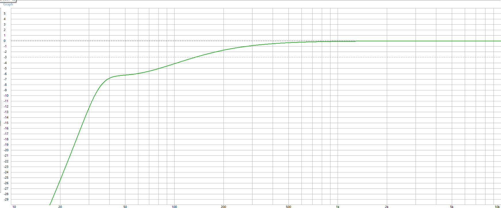

lo pass Butterworth 2nd order 150Hz and small filter @ 120Hz

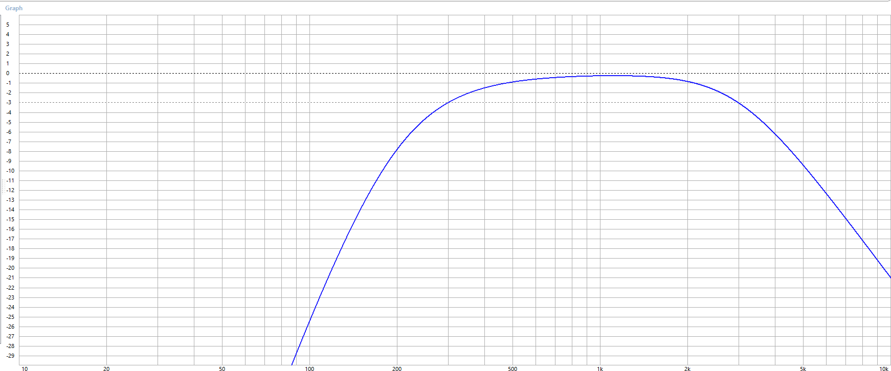

Then a few simulations of the 8m400 in a closed box of 5L (don't want to make this to small as it will have a boxy sound then.
and then the filtered response
filtered with butterworth 2nd order at 200Hz Hi-pass and 3000Hz Lo-pass

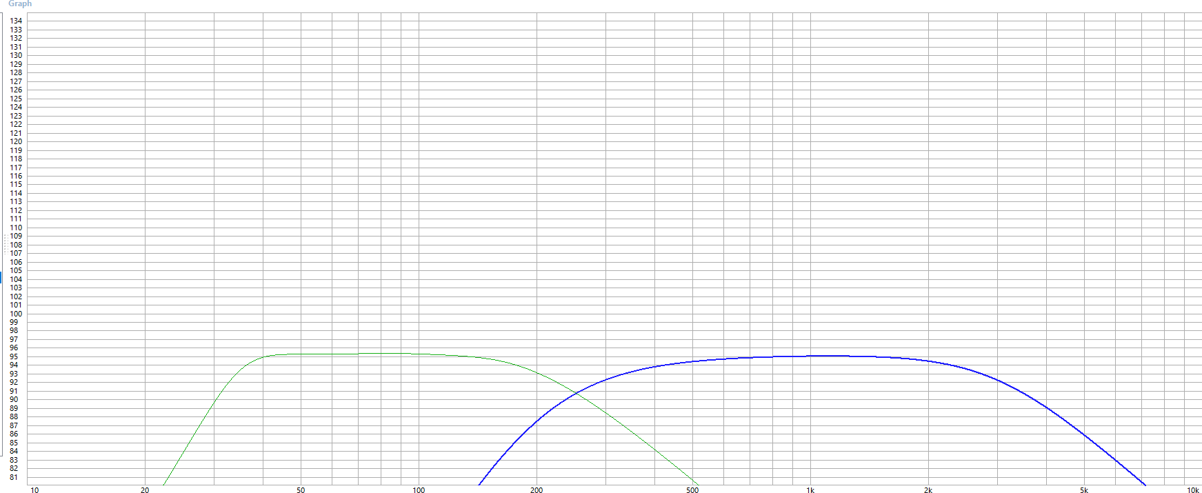

And putting the 2 simulations together:
8m400 has been padded down 3db.
altough the crossover frequency's are not exactly the same I think they would have a nice acoustically crossover of around 250Hz but When I would build this I would first try things out with a DSP and when that measures ok I would start designing the passive crossover.
Then there is also the group delay.
They almost overlap around the crossover frequency. Also keep in mind that the acoustical centre of the mid (blue line) is a little bit more forward then the 15 inch low woofers. So even if the mid has a little bit more group delay I think it wouldn't matter that much. The group delay also changes in the same way so I believe they would combine nicely.
Then the fountek driver wouldn't have problems crossing over at 3kHz and has more then enough sensitivity.

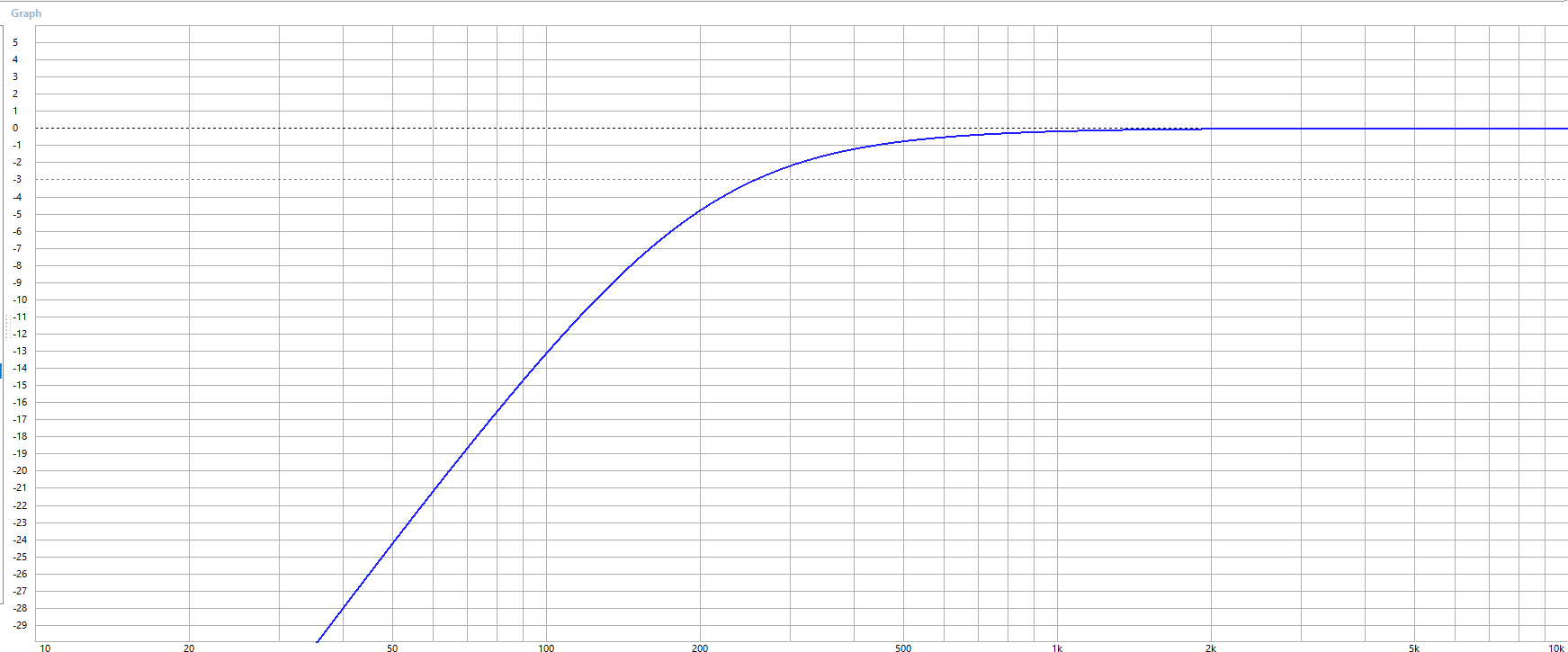

Response
Group delay

Some thoughts:
- Passive crossover <300Hz is going to be big and expensive.
- An 8" driver running up to 3kHz isn't going to work too well, either.
- I really hope you've got a measurement mic.
If it was mine, I'd use a 6" mid and put the crossovers at around 4-500Hz and 2kHz.
