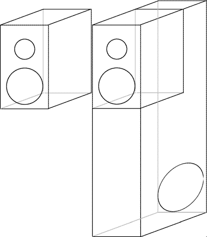

Is this a valid option?
Here are my thoughts for a future project for me, a beginner. I'm currently building some bookshelf speakers of someone else's proven design. I figured that I could build some tower speakers where the mid and tweeter portion are identical to the bookshelf's I'm building now, and in the space remaining below and behind that cabinet volume would be the voulme for a side firing 8" or 10". To avoid crossover design, I was planning on using a sub amp with speaker-level inputs and a built-in crossover, hopefully, a variable crossover.
What are the drawbacks of this? (Other than the cost of having to purchase two sub amps)
