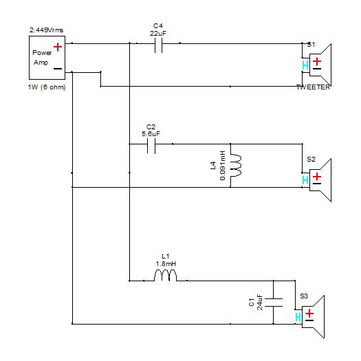

After watching a fair few videos and not doing enough technical reading I have come up with an idea for a 3 way monitor design, sorta based on a series that finished abruptly at stage 3 of 5 on the Kirby meets audio youtube channel.
Driver selection (based somewhat on what's available in Australia and cost with an simple requirement to keep them all the same make).
Dayton:
RS225P-8A Woofer Dayton Audio - RS225P-8A 8" Reference Paper Woofer 8 Ohm
RS100P-8 Mid woofer Dayton Audio - RS100P-8 4" Reference Paper Midwoofer 8 Ohm
ND25FA-4 Tweeter https://www.daytonaudio.com/product/1196/nd25fa-4-1-soft-dome-neodymium-tweeter-4-ohm
Crossover design using xsim (vituixcad has too steep a learning curve)
An overall cabinet size of 33.1cm x 42cm x 25.4cm (24.15litres)
I'll be making a pair.
I actually think I'm overcomplicating this as a three way and could get rid of the woofer and put in a bigger mid woofer (or two) and a simpler two way system, but what do I know?
Any constructive inputs would be appreciated
Thanks.

What are your crossover frequencies? Crossing over woofer-mid at the baffle step frequency may even out those RS225 bumps around 1KHz
the choice of drivers seems ok, but the xover is not suitable at all.
22uF will kill the tweeter,. it also has to be reduced in level by ca 6dB
The midrange has no elements to limit the treble, will interfere with the tweeter.
The bass is 6dB down because of the baffle step.
my suggestion woofer to mid in baffle step(550Hz @25cm width)
mid to high 2k
mid to high 2k
The tweeter needs at least a 2 element XO and a quick look say at around 3500/4k. 3500 would be preferable due to beaming issues but I'd be happy with 4k to protect the tweeter, so crossing the woofer around the 300/400 mark which is approximately baffle step for the box you have stated. Call it 350 to 3500 and that's a nice MR spread.
So 5.6uF on the tweeter and somewhere around 3.5mH to ground might work

I think trying to design a 3-way with these drivers but without some knowledge about crossovers or/and a way to acquire raw driver acoustic output in the desired cabinet is (way) too challenging. And a bit of a waste of effort.
There are a lot of designs out there, even with some of the drivers you picked. Use one of those. Or be prepared to learn and pull out some cash for a rudimentary measuring set.
Come to think of it: you gave the solution yourself: start with a 2-way, with the 180mmm Dayton paper cone. That is a fine driver too, the crossover would be fairly standard (but not off the shelf) and not too complicated (or expensive).

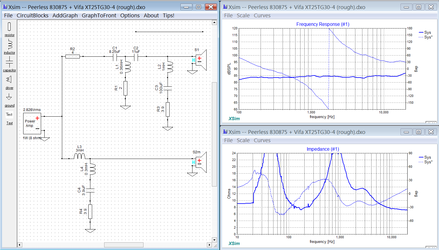

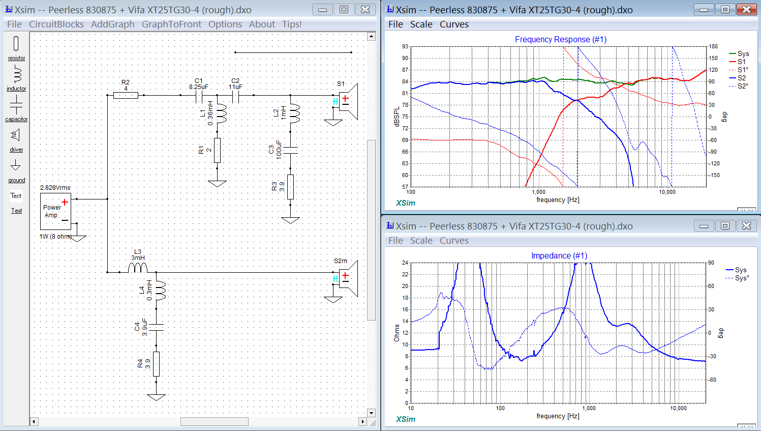

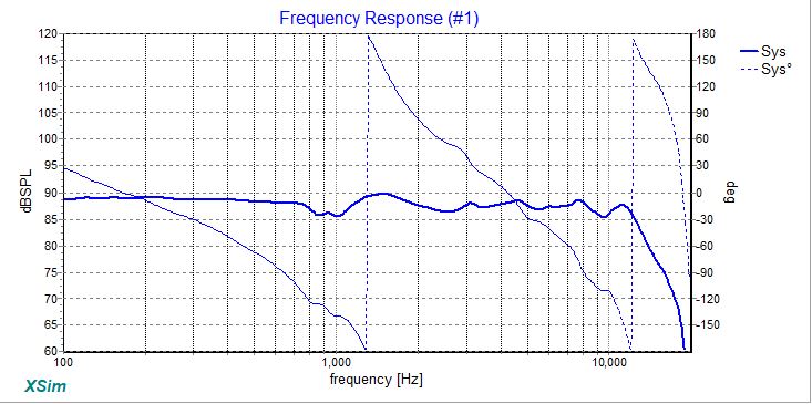

You might find it helpful to change your plot screen as shown between these screenshots.
Love the fact that your 2 way looks way more capable than my three way...
