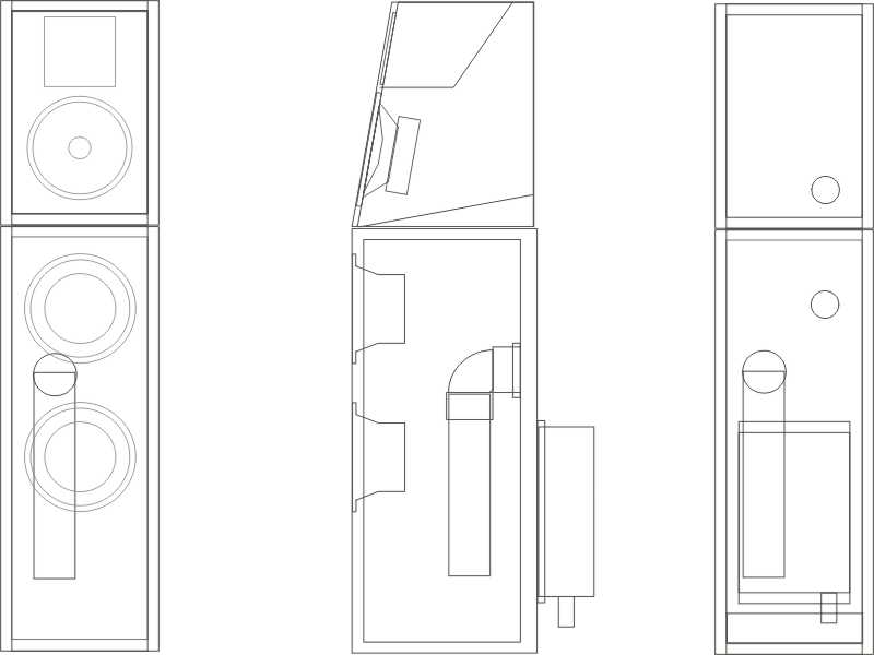

This is a plan view which gives you a bit of an idea.
Essentially the mid box is non-paralleled stuffed with wool/poly.
Crossover is 300hz 2nd order so the drivers dont do any bass.

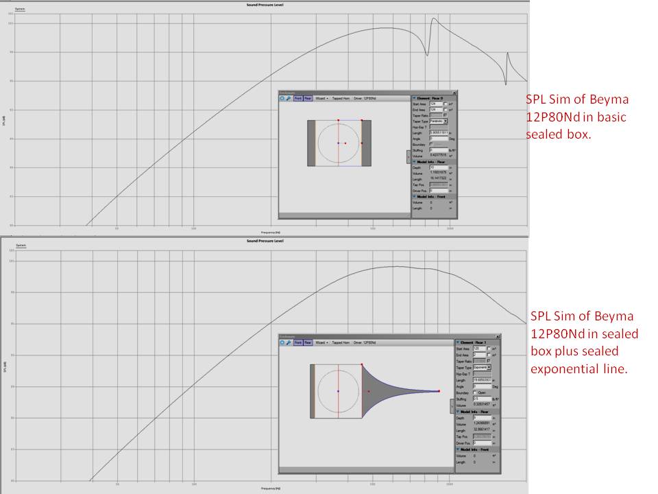

I ran a couple sims for the Beyma 12P80nd midbass to illustrate how "smoother" wide bandwidth midbass performance can be achieved using an exponential taper tube rear volume.
Google tapered tube for info.

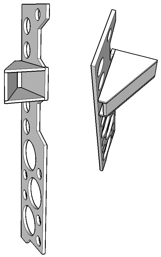

We have done quite a few FASTs with mid/tweeter TLs. We use them with the idea of sucking up the entire backwave & flattening the impedance peak(s). Damping starts out fairly light and gets denser as you approach the terminus. They are heavily tapered to achieve the longest effective line in the space available.
Here is a visualization i did of the midTL (and holeyBrace) in our last MTM.
dave
