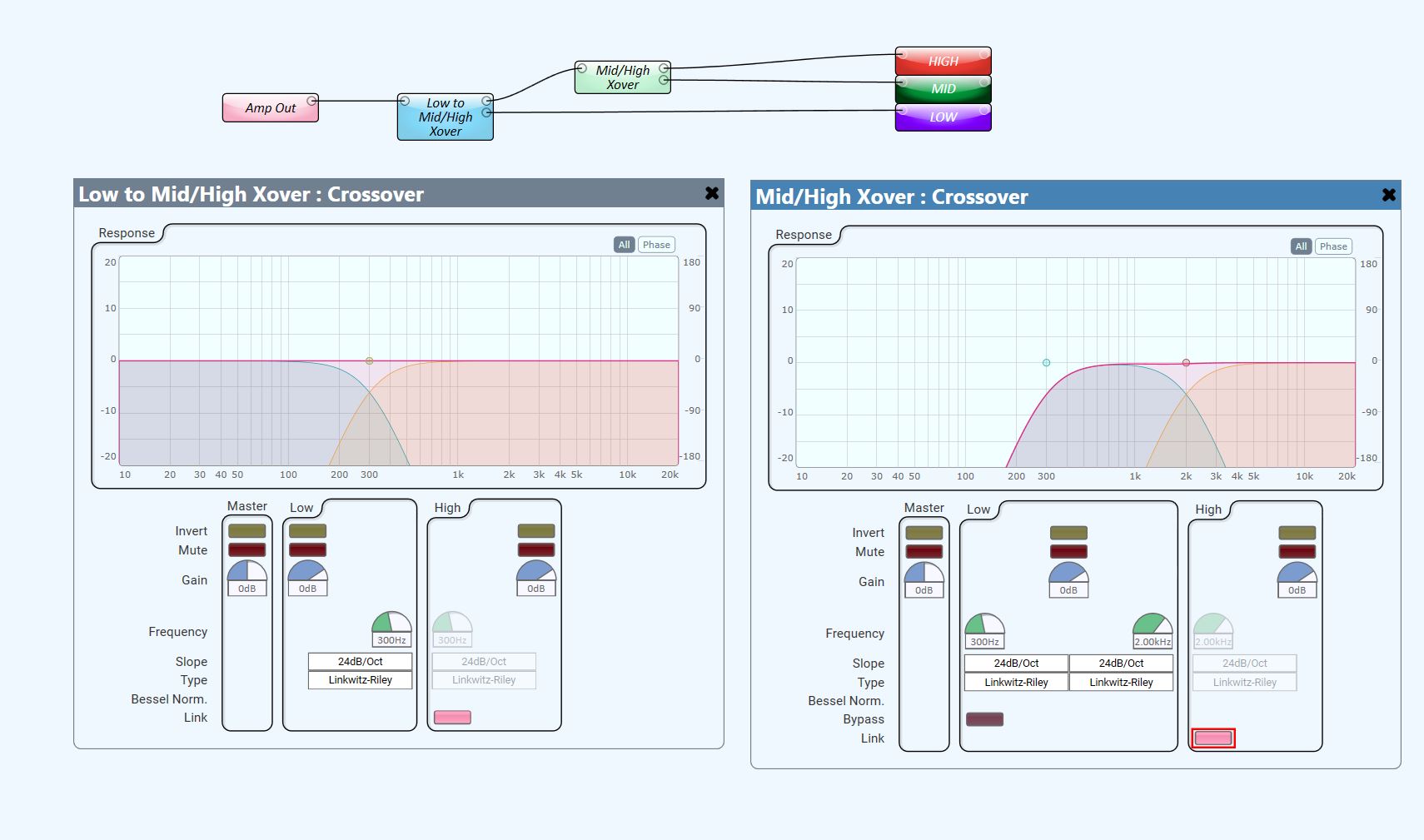

Hi, I have no experience (or desire) to work with passive xovers and impedance's.
But 3 way xovers, be they passive IIR or active IIR, deserve to be cascaded to minimize ripple.
Here's a schematic with xover points at 300Hz and 2kHz, using LR 24's to illustrate.
If i were to go passive, I'd try to think through the impedance implications in the schematic.
