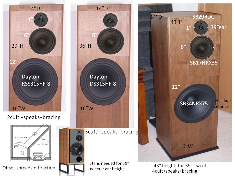

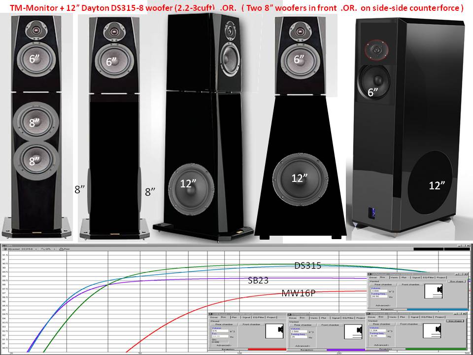

A Tale of Three sealed box 12" woofers.
--BOOM-BOOM BASS in 2cuft cabinet with 85db sensitivity. $135
Dayton RSS315HFA-8 will produce powerful F3=40Hz bass in sealed 2-cuft cabinet. Good motor with inductance-ring, but low efficiency from 195g Mms required for low F3 in a small volume. Favors 7" midrange. Great Basement speaker!
--BUDGET BASS in 3cuft cabinet with 89db sensitivity F3~44Hz . $75
Dayton DS315-8 will produce F3=44Hz bass in a sealed 3-cuft cabinet. Best performance/$$. Favors 6" midrange. Better build and specs than DC315-8.
--MUSICAL BASS in 4cuft cabinet with 89db sensitivity. $170
SB Acoustics SB34NRX75-6 will produce detailed+powerful F3=35Hz bass in a sealed 4-cuft cabinet. Great low inductance motor. Very musical with 89db sensitivity from 99g Mms. Big sealed floor stander = best sound. Can be used with high efficiency 5" midrange like Faital 5FE120, but might blend better with 6" midrange.
A 12" front facing woofer typically has ~13.5" screw rim and requires ~16" wide cabinet.

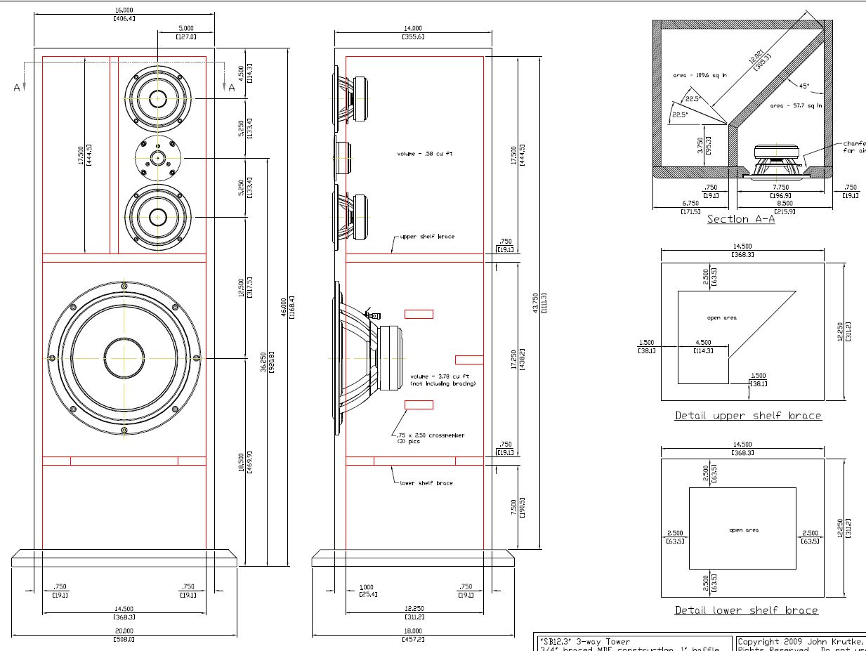

Speaker Expert "Zilch" designed a 3-way MTM-W with a 12" woofer in a sealed 4cuft floor standing cabinet which received good reviews. I would never build an MTM but the basic cabinet construction can be adapted to a TMW three way with different heights.

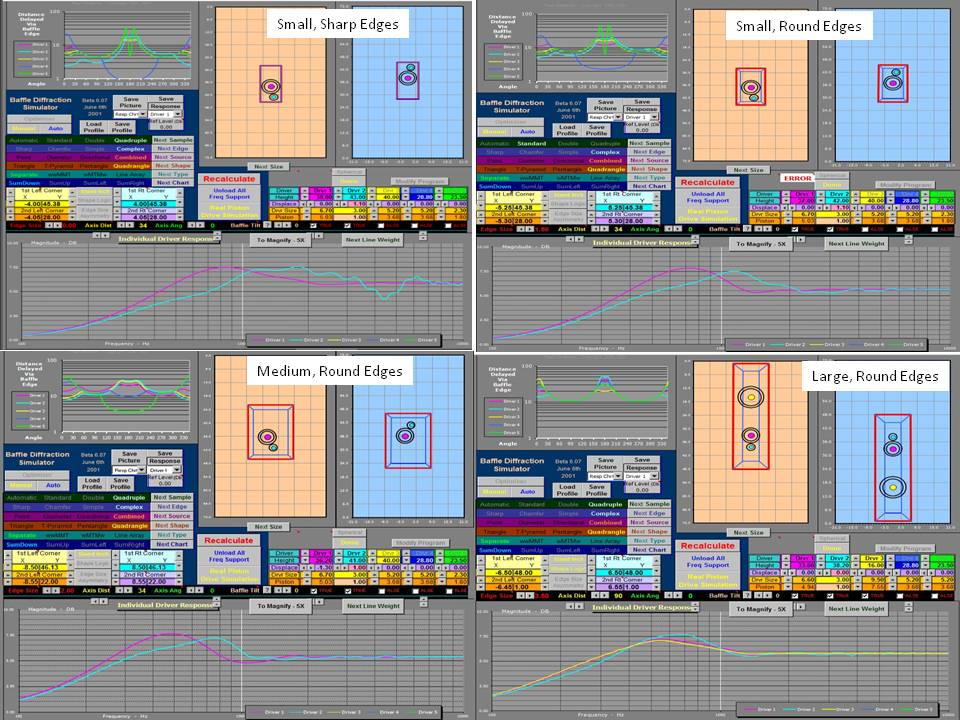

Attached a few baffle diffraction sims which illustrate how your goal of "very flat reponse" requires well engineered cabinets.

Simulation of these beveled-edge cabinets show good diffraction control with simple cuts.
