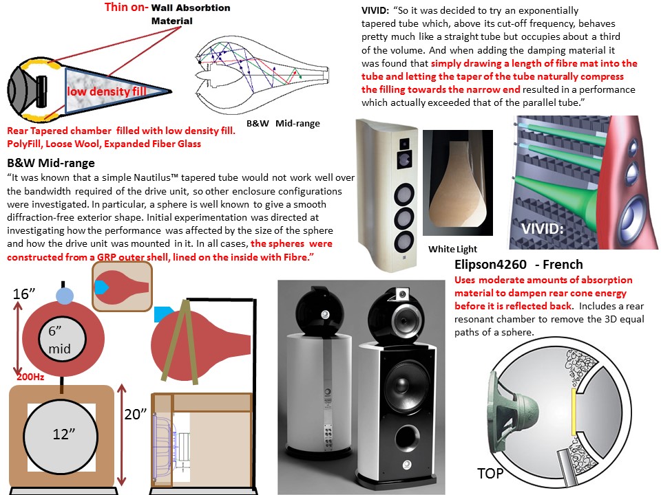

Since you want physical time alignment between the tweeter and midrange with LR2/LR2, consider a low diffraction sphere as used by B&W. Ikea Bowls are common in the USA.
With a passive LR2 crossover using AWG-15 inductor on the midrange, a 4-ohm high efficiency design will produce greater details and dynamics. Most amplifiers deliver significantly higher transient current into a 4-ohm load.
1" SB26STCN-C000-4 44mm diameter LR2/LR2 at 2000Hz
6" Satori MR16P-4 Nelson Pass: "Very impressed with the sound of this midrange."
12” SB34NRXL75-8 very musical = worth the extra cost. 91db sensitivity

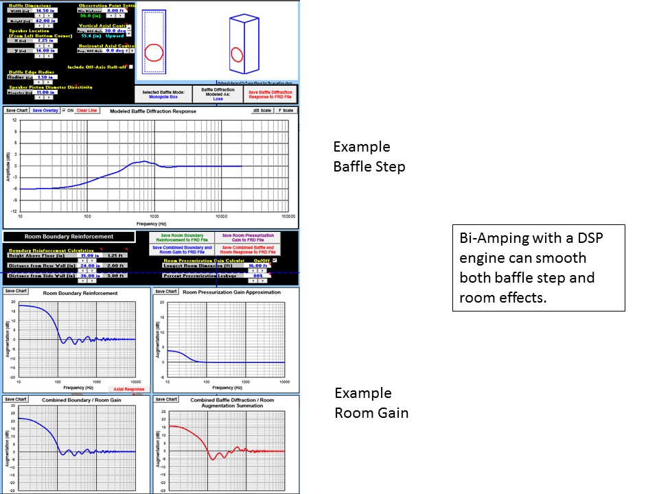

Isn't the 91dB sensitivity of the woofer going to be too low compared to mid's 92dB if I factor in the Baffle Step loss?
This Baffle Step Loss would most likely be happening from below 300Hz as a -6dB Low shelving for a 40cm wide front baffle. Then it would make sense to target much higher woofer sensitivity as I will cross it around 300Hz (or 8ohms Mid with lower sens), correct?
Yes, with the SB34 you need to attenuate the mid at least 3-4dB or probably more or get a higher sensitivity woofer(s). But it depends on your room acoustics and speaker placement too.

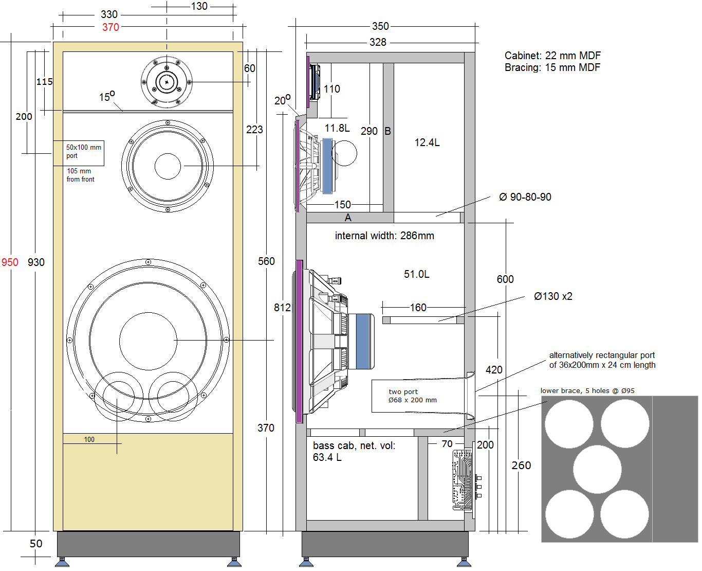

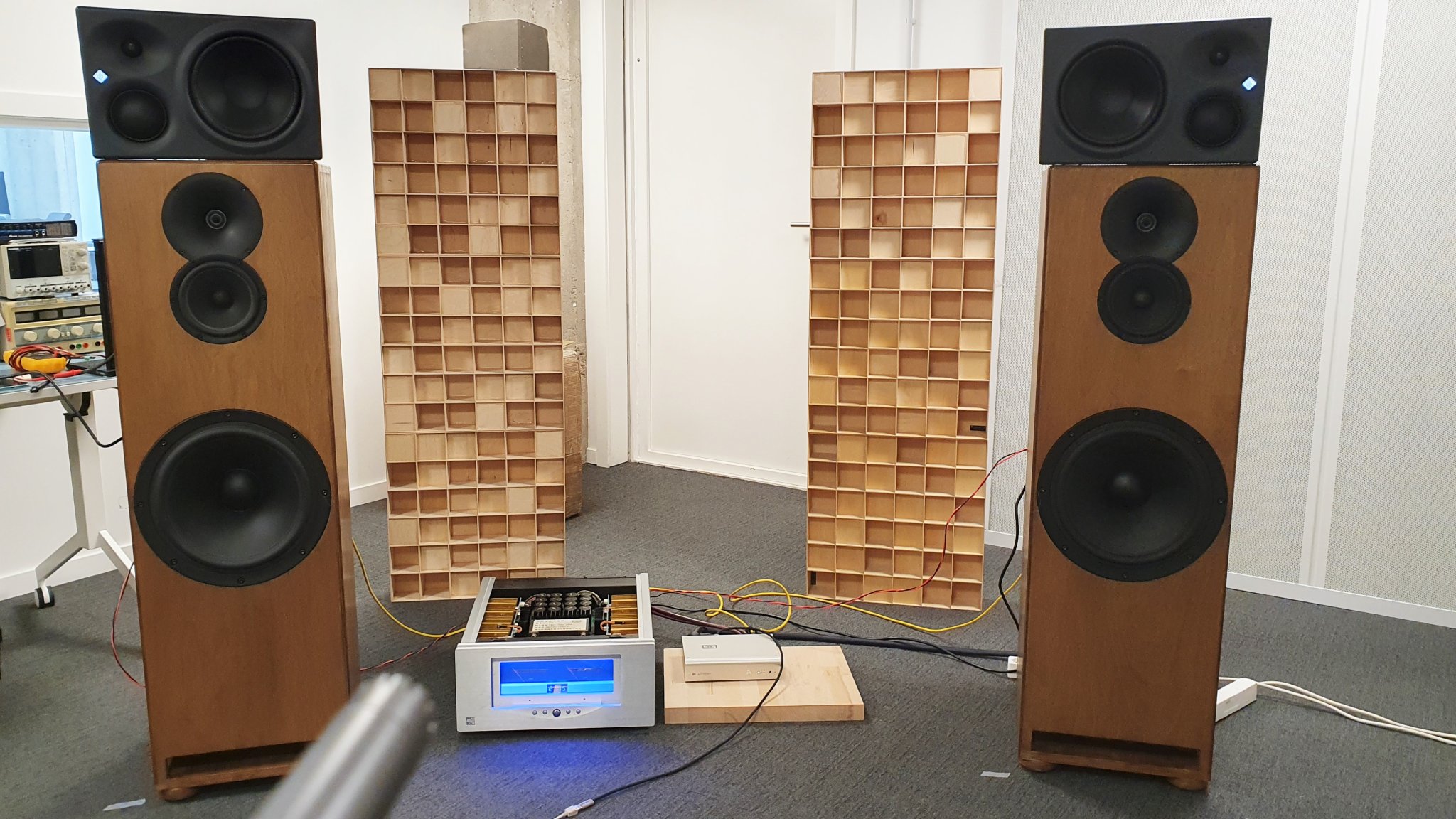

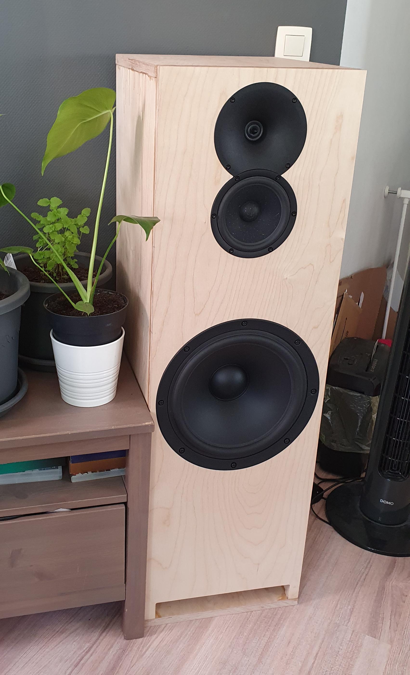

Fast forward 1 year later, after much research, thanks to the covid I kicked off this project.
Since posts on forums were a great source of information for me, I thought I would share a status update:
- 12" SB34NRXL75-8 in a 95L transmission line.
- 6.5" MR16P-8 in a closed box
- 1" R2604 83200 in the WG300 waveguide.
Cross overs ~ 250Hz and 2.2kHz.
Now, tweeter might be the weakest component of the bunch, which is where the WG300 really makes things easy to try other tweeters without changing the front bafle.
The WG300 also greatly improves sensitivity/distortion/directivity below 4kHz, which should mate well with MR16P.

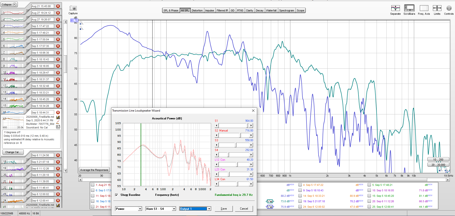

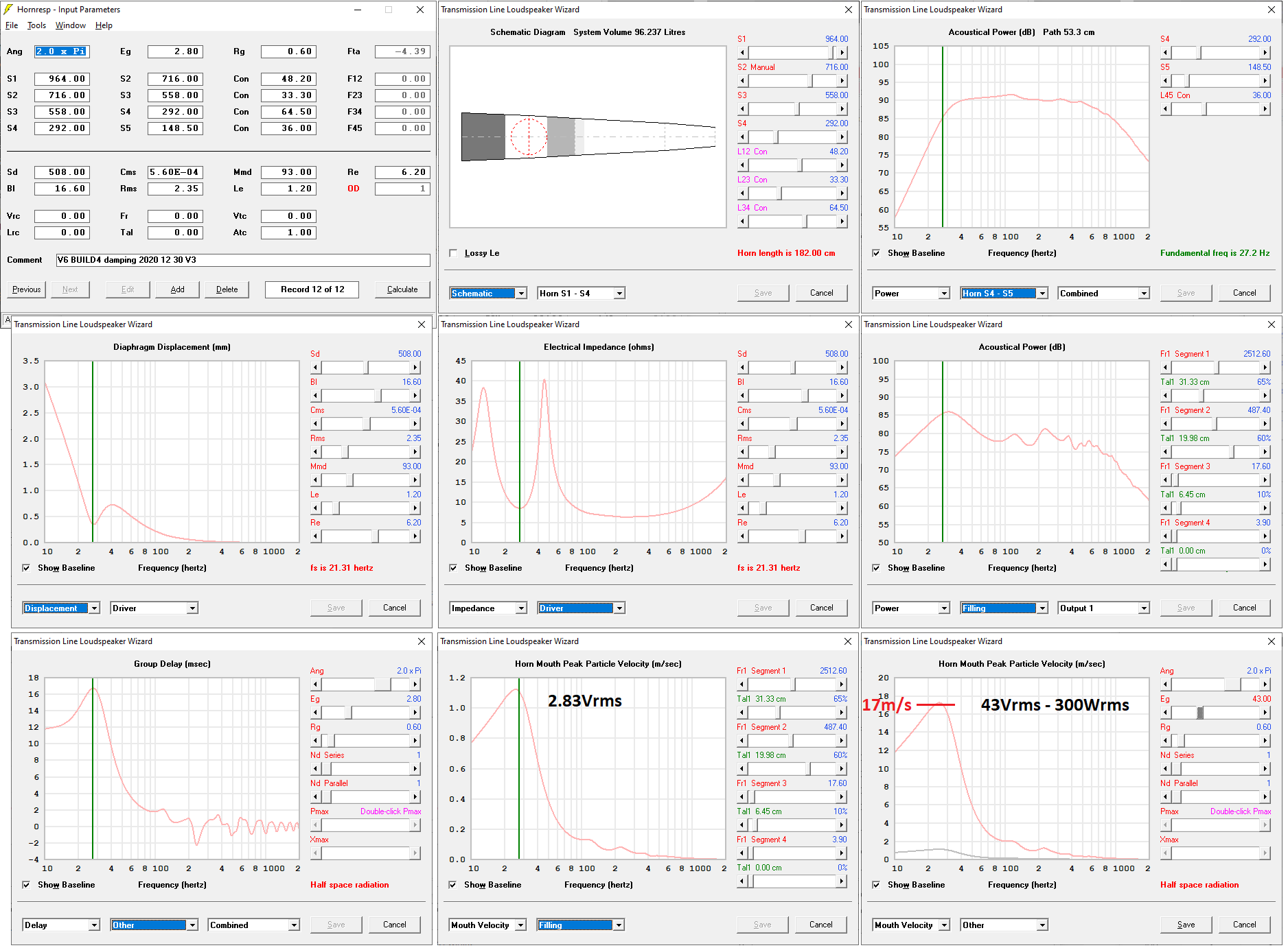

Transmission line properties:
Volume 95L
Ratio 1:6.3
Driver offset 0.21
Line length 1.87m
Diffraction is, I think, the only design point i would improve if I could go back in time, by offsetting both mids and tweeter to a side.
I have seen some poeple getting good improvements by using some foam on the front bafle close to the drivers. I might give it a try.

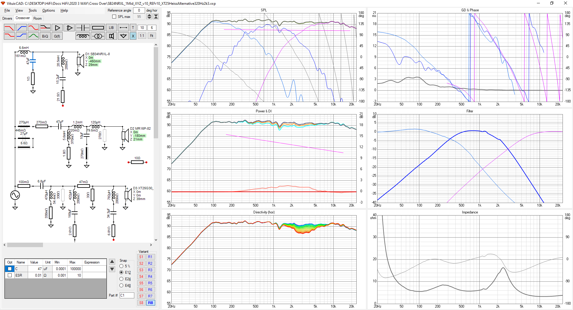

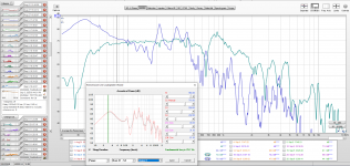

I attached a quick cross over draft (not my measurements) and, more exciting, a screenshot comparing woofer and transmission line's port between Hornresp simulation and real measurement (with litle to no damping here).
Happy to see a close match 🙂
Now I ll make some proper measurements to design the final cross over.
