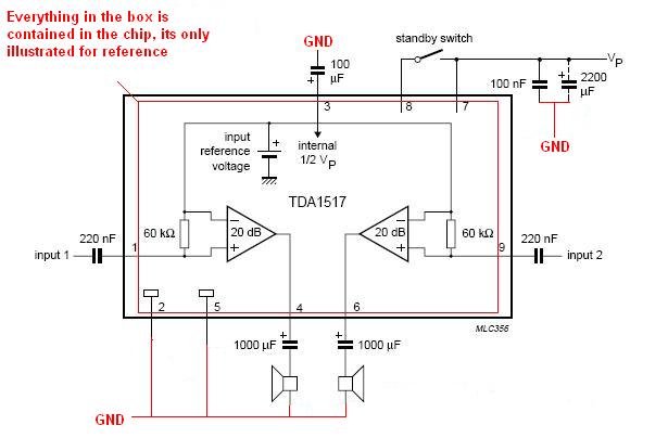

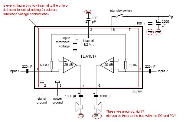

Well I think I understand the jest of it- and I do apologize but I'm still at a VERY VERY basic level of understanding. I thought it might be better to illustrate my questions, so I've attached a jpeg of the application note.

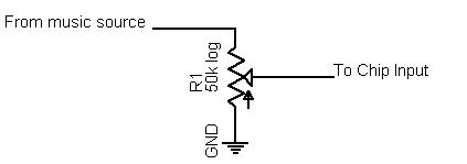

The other question I had was how did you control the volume as I don't see a rheostat anywhere in the diagram?

I attached an image showing the hookups to the chip and for volume control. The volume control image shows for only one channel. You will probably want to control both channels from one knob, so you would need to use a potentiometer that is "double ganged", meaning that there are two sets of variable resistors, but the wipers are controlled by only one shaft.
