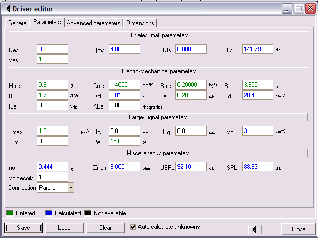

I have a $8 OB on cardboard setup in my workshop with the PC, and want to toss a sub into this. This is separate from the boxes on stands and 2 OB projects that are elsewhere in the house.
Just for fun I am going to take two 3" Chinese widebands, get a long length of PVC with 3/16ths thick walls, and place one on each end. They will be mechanically out of phase so that one on one end pushes out, the other is pushing in.
What I cannot find are calculators to figure this project as a sealed sub since it's a cylinder 75mm in diametre and 3 to 4 metres in length.
Maybe I will lay it down on the floor behind the PC and workbench, maybe I will stand it up in a corner. Who knows. It will cost under $15.
Drivers I will use have an Fs of 113-118 or so, will use a passive XO to feed the $8 high end upper octaves, and a SS amp to power the upper octaves and separate SS one for lower octaves.
What I expect is that with an amp and XO and a bass EQ on the amp, that I will be able to get this setup to extend well below 118 to the point of destroying these small drivers. Since they won't have any air pushing back as they will be out of phase, it's up to me to see if I will play them loud enough to separate the cone from coil. They will operate much as an OB in that regard. Over driving them is always a risk.
That said, I am trying to find calcs to model the FR of these.
Since my mids/woofers for the upper octaves roll off at the same frequency, [these are 3" $1.50 cheap-o yellow paper cone drivers scavenged from some old TV speakers] with a similar Fs for the drivers in the OB (not the ones that will be used in the sub) and all have very similar specs, I want to see what FR I can expect from a tube of 3 or 4 metres or so in length that is 75mm in diametre with 2 identical 75mm drivers 3 or 4 metres apart capping a long tube.
I suspect I will be able to 'ask' these drivers to do what they cannot, to the point of destruction. I want to calculate what that FR would be, how low/loud.
Any suggestions, tips tricks or hints will be most welcome!
TIA
Sub driver specs
Fms 118.5
Qms 3.75

According to this calculator, the two small drivers will make only 78dB SPL at 50Hz at 2mm excursion, with LF boost. That should work OK. 50Hz is satisfying for a desktop system, and the sealed bass will rolloff at only 12dB so it will sound lower.
Piston Excursion calculator

Running the calcs these types of drivers are better suited for a ported box, but I want to see what happens with a longer sono tube, and I can always cut the tube down to size and use it for something else. Will use one or two, bipolar or dipolar, etc, to hear the results.
QUESTION
What measurement for diametre would I use?
That of the cone before it connects to the surround? Of the middle of the surround? The outer edge of the surround? The face plate?

FWIW, using the more accurate Mms, Cms, BL, etc., specs, Fs = ~141.79 Hz, Qts = 0.8 and calculates a Sd = 28.4 cm^2.

Diameter is measured from the middle of the surround. Diameter is only relevant to calculating the swept area (Sd,) which GM has kindly provided.
I actually just typed in 3" to the piston calc, and calculated SPL @50Hz. So your actual diameter might be smaller and the SPL at 50Hz even softer. It's hard to make subwoofer from 3", but where there's a will there's a way.

I am fine with the lowered sensitivity and low volume levels that won't exceed 80dB often.
I doubt I can get this driver down to 30hz even with aggressive EQ and a dB level of 60. Should be interesting to see. In an enclosed 3.5L box these drivers get down to 55hz at respectable volume levels. They roll off severely below 55hz.
