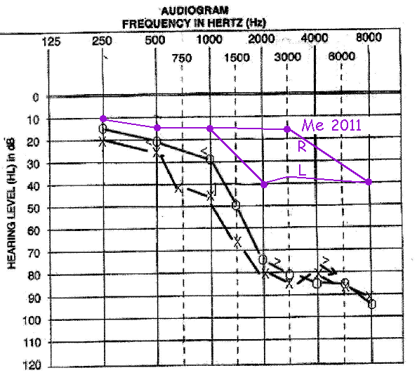

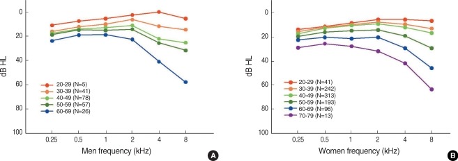

Have you looked at shape and depth of typical hearing losses?
Survey:
Me and my dad:
Note that Dad had a 45dB/Oct slope from 1kHz to 2kHz... no simple filter can boost that. (Or even half of that, since an old-old starting guide is to correct half the loss.)
And the electronic issues the others will point out. All your gain is at the end. You have loss where none is needed. Inappropriate values. Inconsistent drawing.
There's enough confusion and wrong-thinking in the hearing aid field. Don't add to it.
