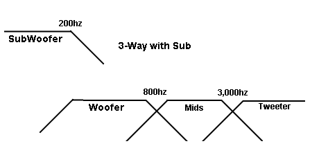

What makes a speaker a HALF-Way is when one of the drivers share PART of the range of the other driver.
In this case Bass-1 and Bass-2 share PART of a frequency range.
A 4-way with the same drivers gives a isolate frequency range to the Bass-1 driver or in some cases the Bass-1 might actually be a Subwoofer -
I suspect in your case, if you could set it up as a Low-Bass (30liter vented) and a Mid-Bass (15liter sealed). But the output of those two drivers in those diverse cabinets will not be the same.

Given the Frequency Response of the drivers, it seems clear you are building a Low-Bass/Mid-Bass/Tweeter system, not a more standard Woofer/Midrange/Tweeter system.
If you want to make the 7" bass drivers into a HALF-Way system that can certainly be done. Typically the crossover is at the Baffle Step of the Cabinet. But you are already building a Low-Bas/Mid-Bass system (7" Low-Bass, 5.5" Mid-Bass).
Though other here are more expert than I am, I question whether you can make a effective Crossover between the 15M/4631 and the 6600 AirCirc. The 15M/4631 has a large bump in the response above 1khz, that is going to have to be dealt with using additional Crossover components. That implies that the Mid/High Crossover is going to have to be pretty low. Too low to effectively merge with the Tweeter. Though others may disagree, but I don't think so.
The 18W/8531 7" Low-Bass look good up to 1000hz, but they also have a resonance bump above 1khz. Again, that is going to have to be dealt with in the crossover. And the Low/Mid crossover is also going to have to be pretty low.
The most critical aspect is the Mid-Bass to High Crossover. I'm not sure that is going to work. The Mid-Bass won't go high enough, and the Tweeter won't go low enough.

Next you need to decide what you are designing? 2.5-way, 3.0-way (W/M/T), or a 3.0-way (LB/MB/T), or a 3.5-way, or some other configuration?
Generally Woofer/Midrange/Tweeter have higher crossover, typically 500hz and 4000hz or 800hz and ~5000hz.
Low-Bass/Mid-Bass/Tweeter usually have lower crossovers. Metaphorically they are like a 2-way speaker with a Low-Bass driver added. So the crossover might be in the 200 to 300hz range, with Mid-Bass/Tweeter in the 1600hz to 2400hz range.
I just can't see your original speakers in a Woofer/Midrange/Tweeter configuration. The best you can hope for is a Low-Bass/Mid-Bass/Tweeter, and even that is going to be a stretch.
