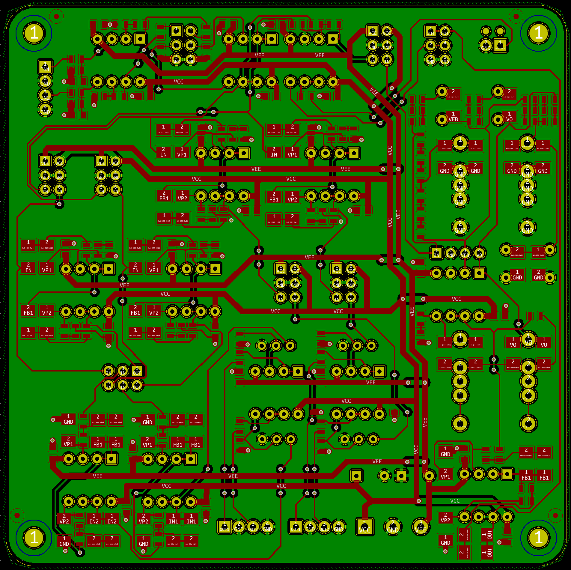

I am putting together a PCB for a set of LR4 crossovers with a view to assembling a 2.1 computer-speaker set, with the fronts being two-way actively crossed over. Or you could think of it as a 3-way system with the LF channels mixed and run through a Linkwitz Transform.
If anyone with a clue has a few spare minutes, I would appreciate any input on the design as it progresses - it is on github. The files are for KiCad, but there's a PDF of the schematic which should be readable by anyone. I haven't started on layout for this board yet.

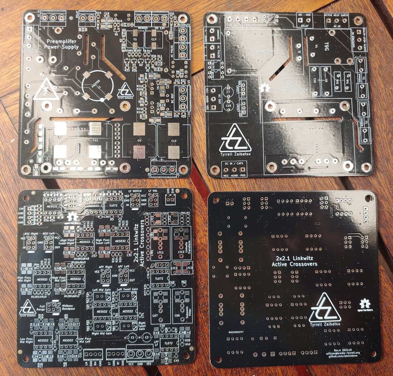

I will be getting a batch of blank boards made up in China and populating them by hand; reflow solder on a hotplate. Assuming they work, I may put the leftovers blank boards up for sale.

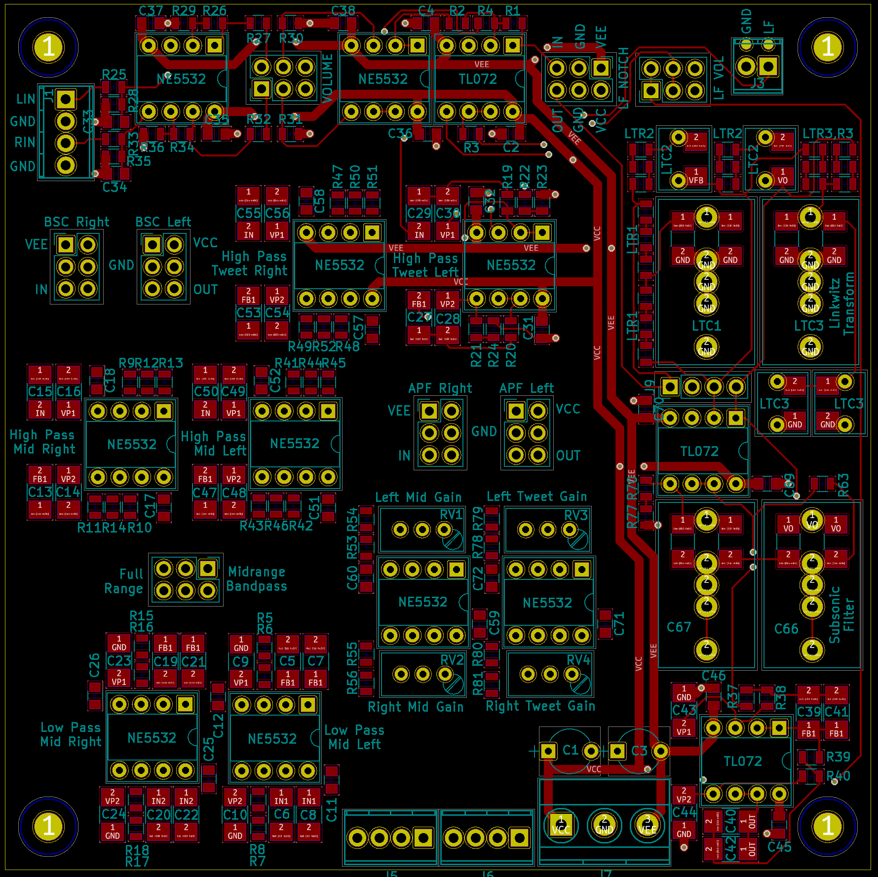

Progress is being made... I have placed and about half-routed the filter board.

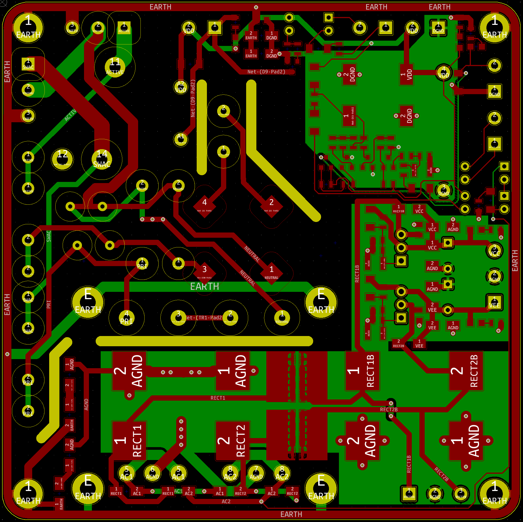

I moved all the power supply stuff to a separate board, which you can also find on github. It's a combination of linear regulated PSU to run the preamp stuff, plus a 12V switchmode brick for running control circuits (mute relays, fans, etc), and some logic to control the muting relays.
There are PDF schematic and PNG screenshots of the layouts of both boards in the github links for those without kicad, and a screenshot of the filter board partial layout is attached.

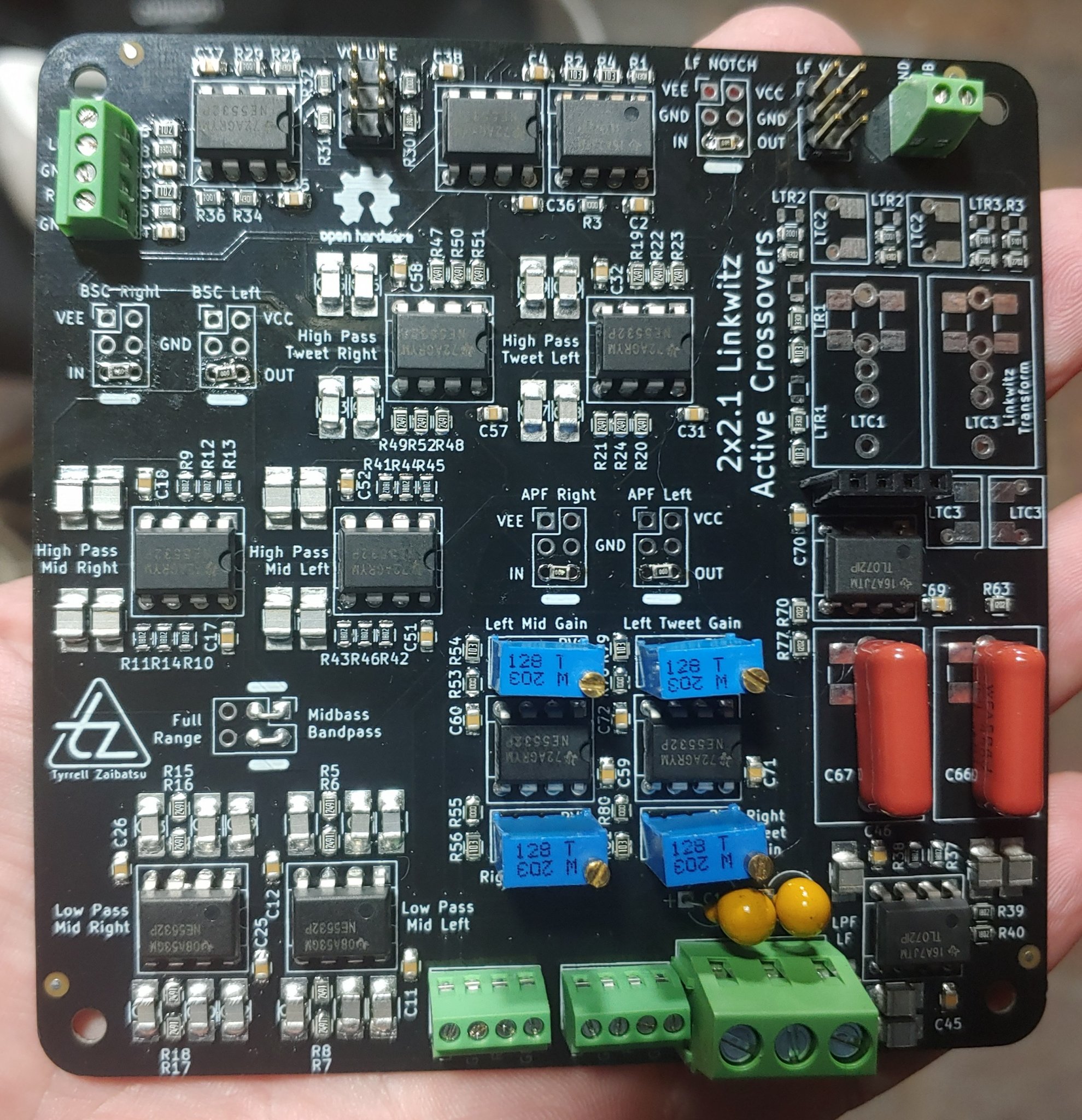

Prototype is assembled, bench-tested (signal generators and measuring voltage levels at various frequencies) and seems to be working, though it hasn't actually been plugged into any speakers as yet.
You can see the Linkwitz Transform section is basically unpopulated and there is a 4-pin header at the right which allows me to plug in a passive filter pack and experiment with different gains and shelving frequencies. I intend to tune that a bit using room measurements before committing to final values that are soldered to the board.
Similarly, the BSC, APF and Notch plugin sockets are bypassed with 0R. I could add filters on daughterboards to each of those in future if necessary but I suspect it will never happen.

Looking good - bit of a mix of SMT and through-hole - I probably would have opted for SMT opamps, or socketed the through-hole ones (simply because you can if though-hole). What dielectric did you choose for the caps in the filter sections? I tend to go for PPS as they perform close to PP (which are not compatible with SMT due to the melting point).Prototype is assembled, bench-tested (signal generators and measuring voltage levels at various frequencies) and seems to be working, though it hasn't actually been plugged into any speakers as yet.
Yeah it's a "use up what's on my shelf" kind of design. Plan A was to use sockets (and to offload spare boards to like-minded nerds on diyaudio who tend to have stacks of spare DIP opamps), and I have heaps of sockets, but I couldn't find them until two days after I soldered it together 🙂
It's not like I'm some opamp-swapping mad-scientist, I have 40yo ears that DGAF about subtle differences of noise level between NE5532, TL072 or the goldplated stuff, so soldering them down is fine unless the design didn't work, which it did so that's all good! If I did it again, the opamps would be SOIC just to save me 10 minutes with the iron 🙂
Yes, the SMD filter caps are PPS; they are Panasonic ECHUX series in 2% tolerance. Resistors in the signal path are mostly thin-film metal, mostly 0.5%, except for where I've made up weird values in the linkwitz transform from multiple handpicked resistors from an eBay sampler book which may well be thick-film though they all measure better than 1% and have 4-digit codes. Who knows.
I wish KiCad had a similar concept for board layout as it does for nested sheets. As you can see here, there are multiple copies of distinct blocks (LR4 in Sallen-Key topology) which are easy to represent as schematic sub-sheets, but I had to lay out each one separately by hand 🙁
