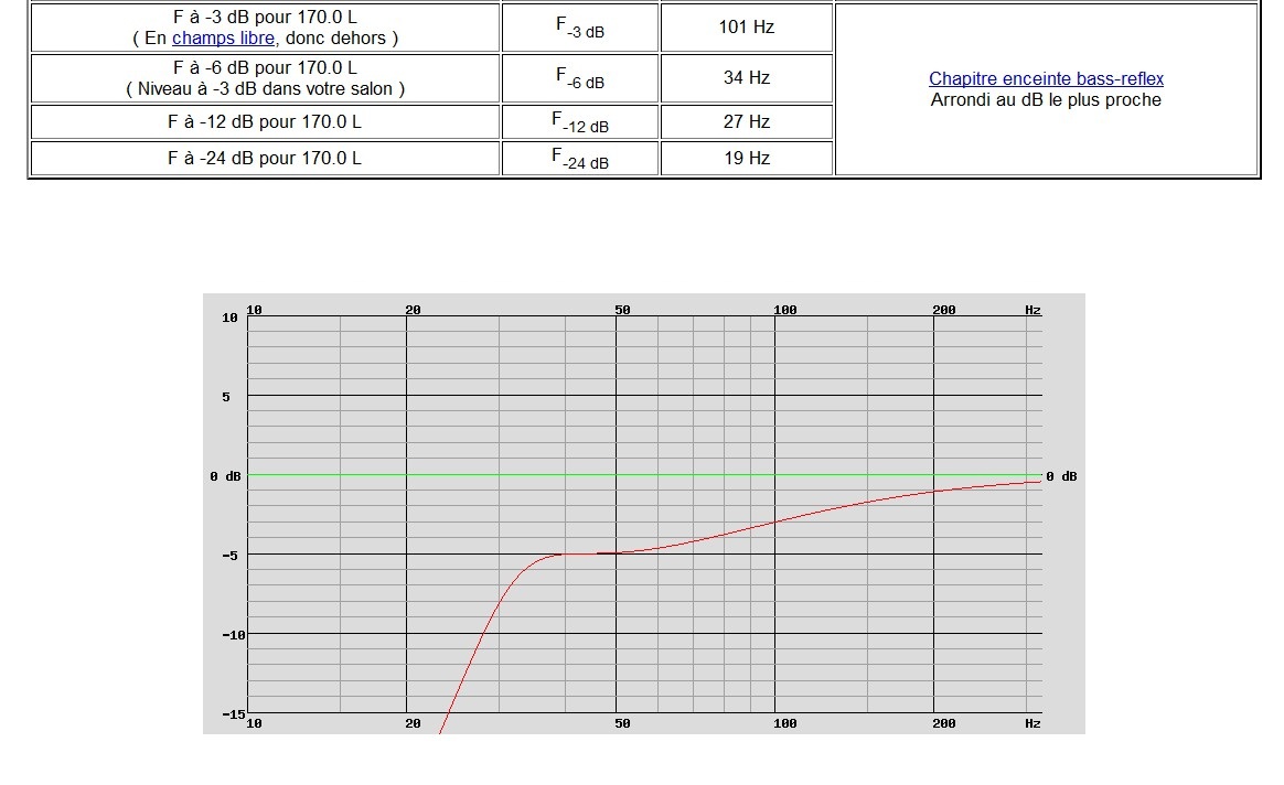

This are simulated proposals and I don't see it being a good sub as you imply (F3 being superior to 50Hz i.e. 55Hz).
You say ""4 18" subs in test boxes (170l) "", I guess you have 2x18" in a 170L box 85L for each driver. 😉

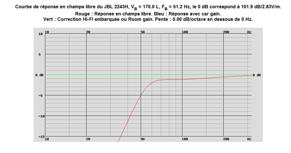

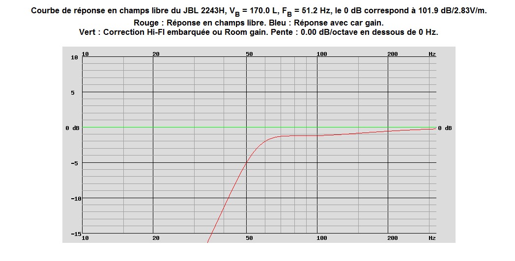

Again, one JBL 2243H, VB = 85.0 L, FB = 50 Hz, 95.5 dB/2.83V/m each,
F3=54Hz, F6=47Hz (-3dB in room), F12=38Hz, F24=26Hz.
With 2x parallel JBL 2243H, VB = 170.0 L, FB = 51 Hz, 101.9 dB/2.83V/m.
F3=56Hz, F6=48Hz (-3dB in room), F12=39Hz, F24=27Hz and this is pushing the envelope.
I would go with the horns (as a concept). It's this what you were expecting?
(Note, I don't have experience with active manipulation and DSP, and I don't know what to expect...)

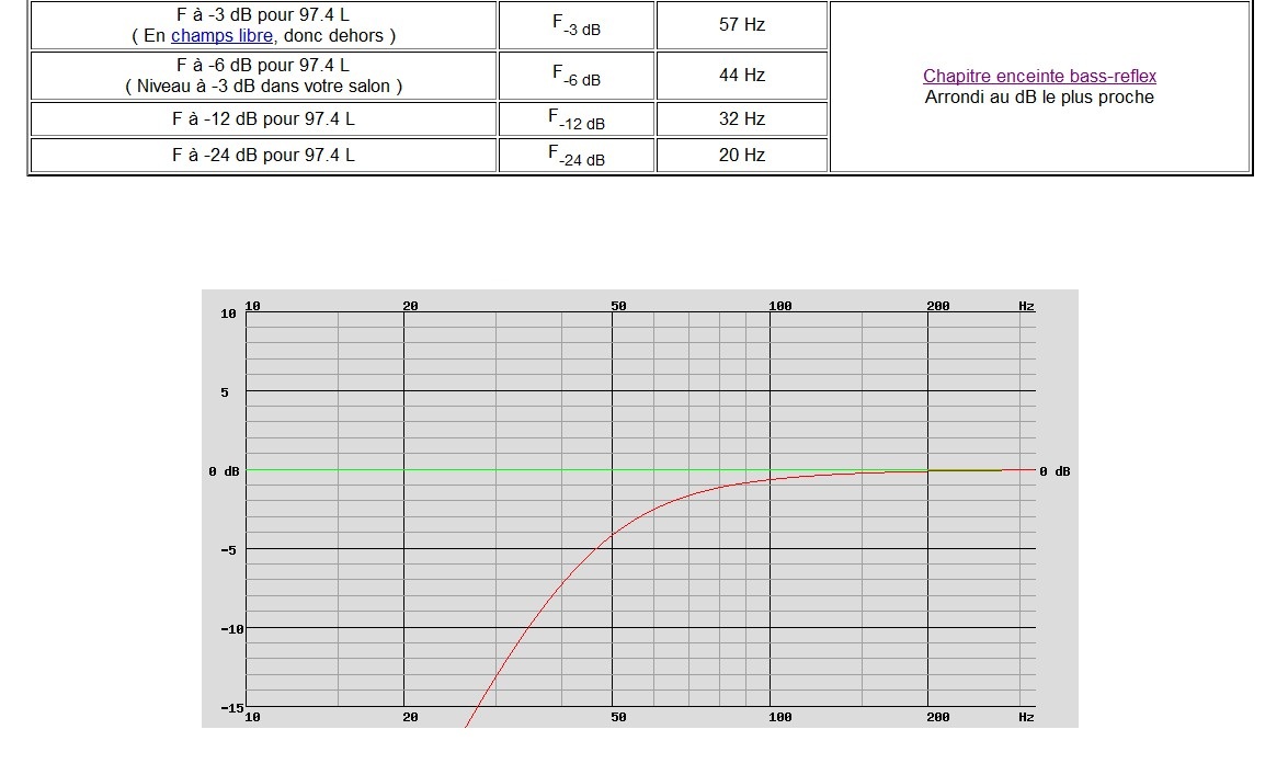

These are they, on fig.1 a 2242 driver in a small box: JBL 2242H, VB = 97.4 L, FB = 37.6 Hz
(F3=57Hz, F6=44Hz, F12=32Hz, F24=20Hz)
On fig.2 the 18" 2243 in a small box: JBL 2243H, VB = 45.7 L, FB = 45.8 Hz
(F3=75Hz, F6=58Hz, F12=42Hz, F24=25Hz)
Note: they are just example simulations always having in mind that functions/alignments objectives for both passive filtering and active amplification/DSP (in this case) are rather different.

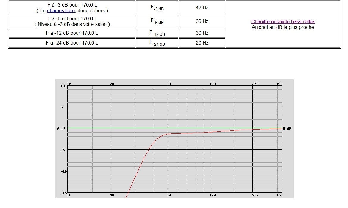

In a similarly designed box (170 L), notice that this his only a comparison and not an optimized enclosure/alignment for the designated driver, we have for the same two drivers JBL 2242 vs. JBL 2243,
(drivers are similar in SPL calculated at 95.4(1)/95.5(2) dB/2.83V/m)
Fig.3 JBL 2242H, VB = 170.0 L, FB = 39.5 Hz freq. output
Fig.4 JBL 2243H, VB = 170.0 L, FB = 32.0 Hz freq. output
Also notice the high attenuation >5dB of the low frequencies, with alignments close to 30Hz tunning, in the second case.
(JBL 2243 and...) JBL 2242 share the same motor but have a lighter cone, raising the Fs to 35Hz and increasing the sensitivity.
That is the case, increased sensitivity. If you look at the graphs the 2243 is 5dB's down at lower frequencies.
But if you look closely (fig.3) for the 2242 at 30Hz you have attenuat. 11dB's and for (fig.4) the 2243@30Hz (same frequency) you have -8dB's. I don't know if that is what you are expressing in your comment?!

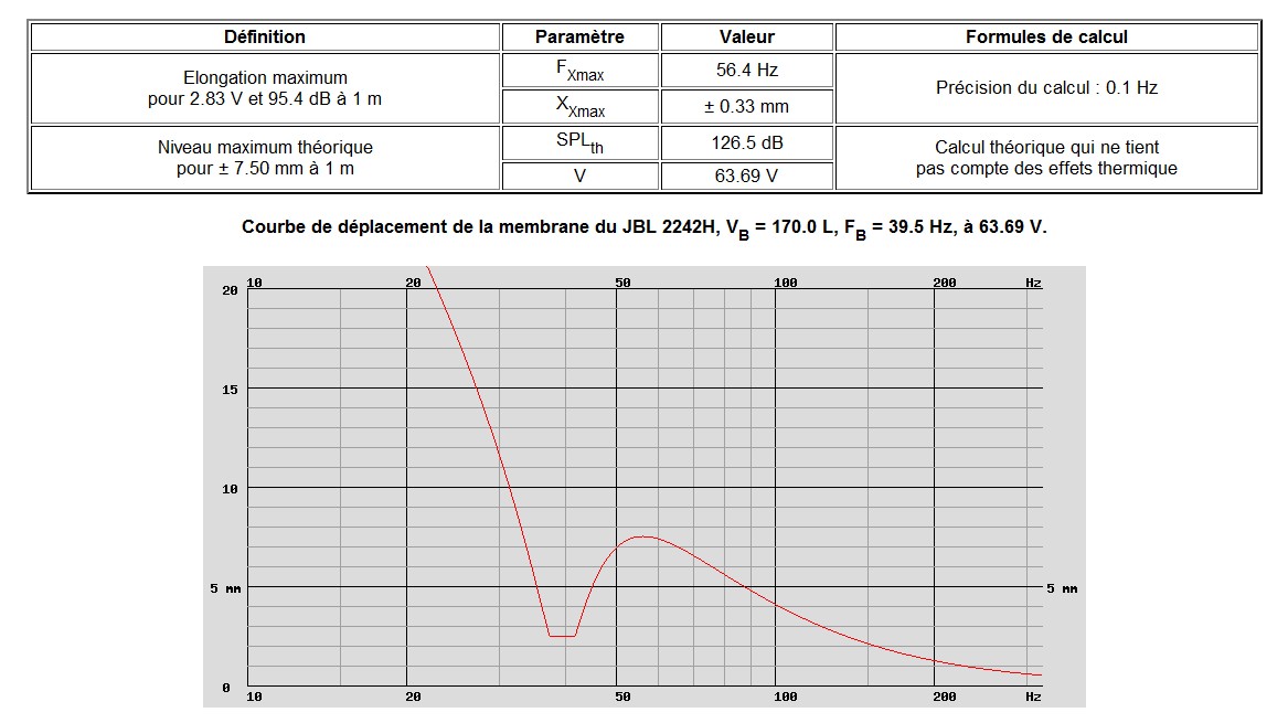

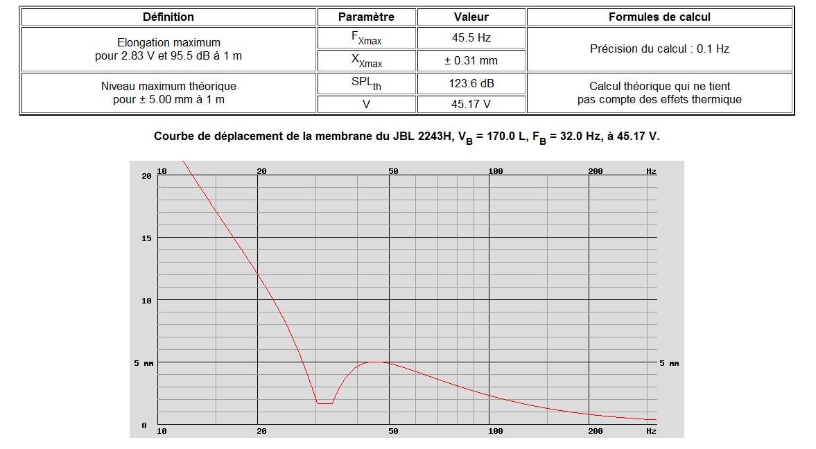

Fig.5, fig.6 for the cone displacement or excursion, showing the maximum excursion in the ~30's for the 2242 and in the -20's for the 2243, this one having lower excursion (at 30Hz 11.5mm for 2242 and 5.0mm< for 2243) for a similar volume designed (170L) box and considering different FB as above.
Fig.5 JBL 2242H, VB = 170.0 L, FB = 39.5 Hz excursion
Fig.6 JBL 2243H, VB = 170.0 L, FB = 32.0 Hz excursion
