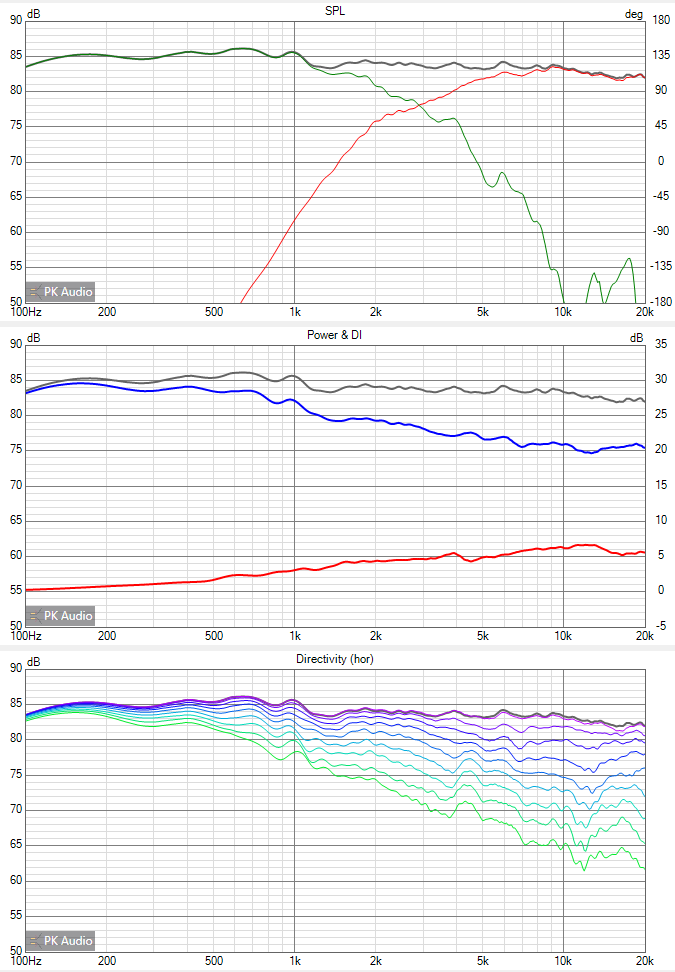

Here is another prototype 2way project I work on.
W18NX003 is excellent unit and is basically perfect in all aspects of the performace. It is Purifi level of performance. Finally the Seas drivers with performance matching the price.
T25B in WG measures very linear on and off axis, and the distortion is great too.

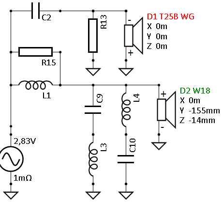

The crossover is again quite simple, and both units are very easy to work with.
The cabinet volume is 19L, tuning ~38Hz.
First listening tests were very promising.

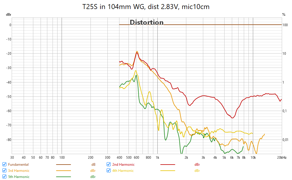

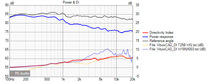

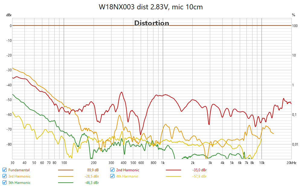

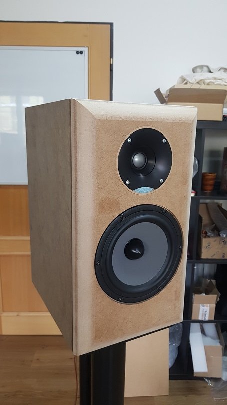

Why the blue under the tweeter ?

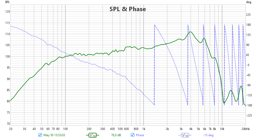

What's the response in sub bass ?
Can you communicate large spectrum ?
Have you picture of the crossover or schematic picture ?

I got this WG from the friend of mine, I helped him with the measurements of the several iterations of the WG. He had several pairs, this one had cutout for close CtC with 150mm midrange. The blue is the piece of foam to fill in the gap.
400e for 1unit is a lot. But this kind of performance does not come for free. Purifi PTT6.5 costs the same. So far Seas units always lacked something in the performance, but W18NX003 and W22NY003 are on par with Purifi etc. So there is an alternative. W18 is great choice for small 2way or midrange in larger 3way.
Bass quality and character is very similar to PTT6.5W
Here is the crossover schematics.
