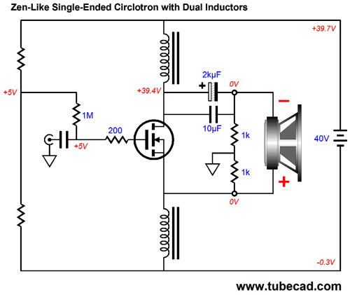

Beast can be controlled with last schm I posted in Singing Bush thread
Choked Singing Bush, and dissipation can be reasonable
though, without actually having Da Beast on bench, we can only superguess where sweet spot could be
