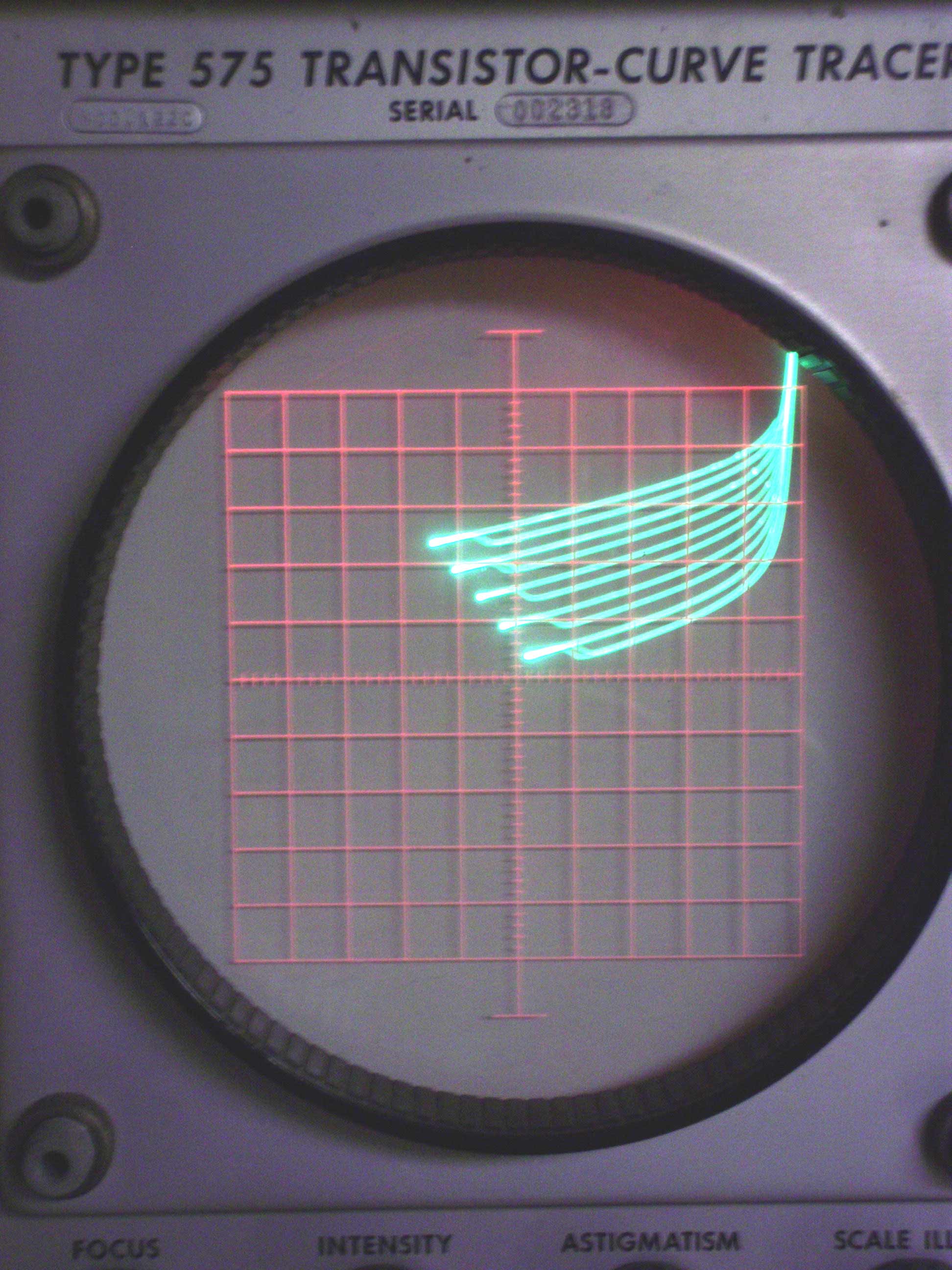

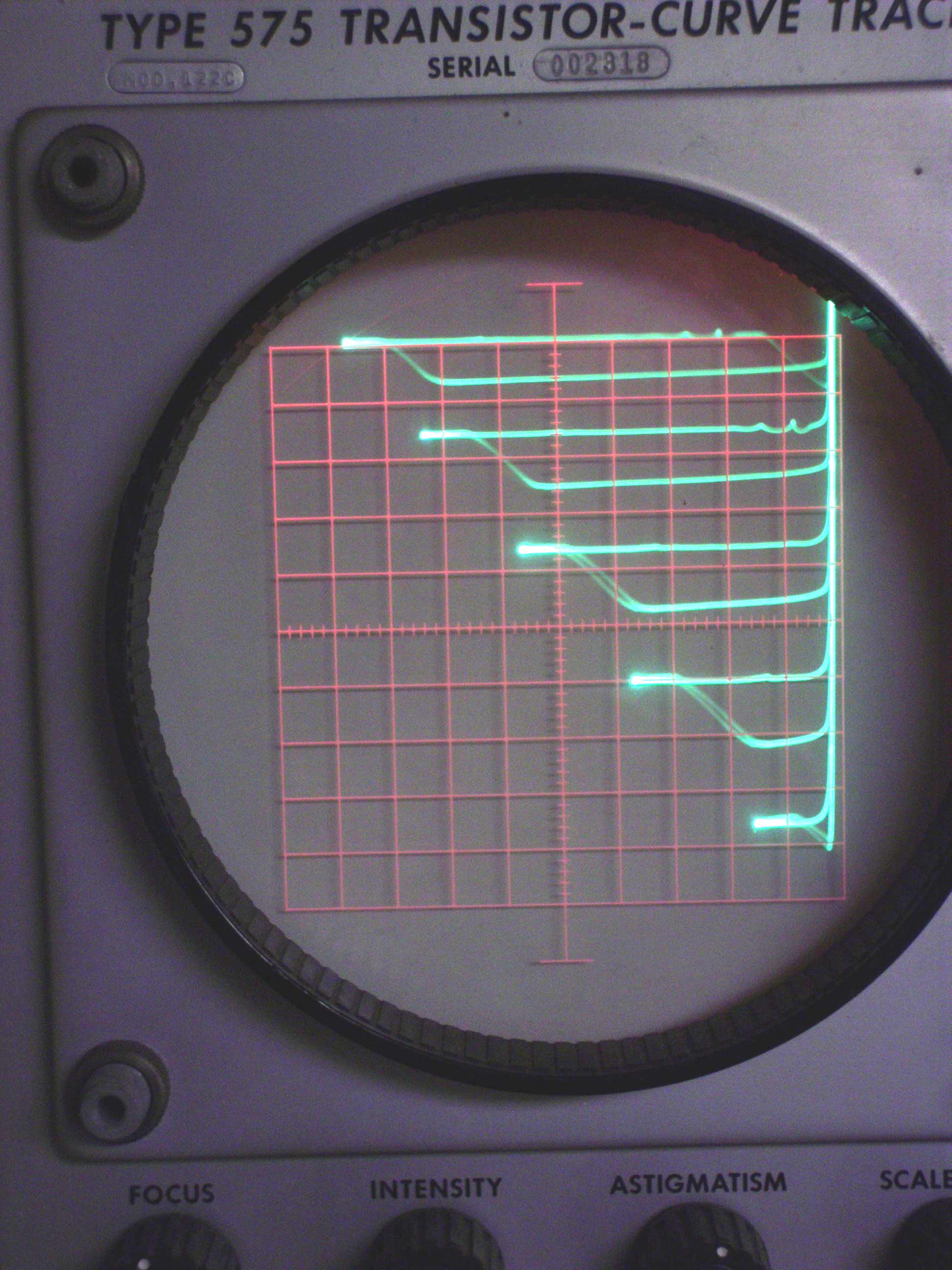

I just bought a quantity from various Asian suppliers and found that the alleged 2SJ74BL did not look like my NOS 2SJ74 on the curve tracer by any stretch of the imagination.
The alleged 2SK170BL, some of which came from a reputable US source as well, has the same physical appearances as described BUT looked good on the curve tracer. This does not mean that they are real 2SK170 Toshibas.
I have no good way to measure the NF, and that would perhaps be definitive. It was suggested to measure the Rds ON, but I have not done that.
The Idss group did match, fwiw, on both devices.
Left most pic is asian sourced 2SJ74
Right pic is NOS Toshiba.
SAME settings on tracer...

I'm afraid that a lot of people have already bought these devices from ebay sources, and maybe distributors. For all I know these are actually Toshiba, but perhaps defective dies or other part numbers renumbered. They do look a bit like 2SJ103's curves in the Toshiba book.
But for amps the K170s ought to work just fine, if they have curves like the ones I bought.
