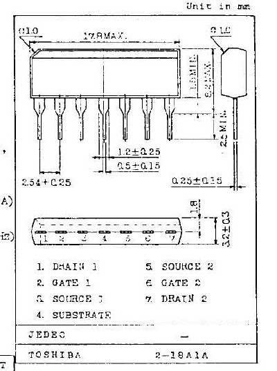

Here you go, the DGS#SGD pinout is standard for this package type.
VDS=-50V, 2*0.2W,gm=12 mS typ.
Idss: Y=1-3,GR=2.6-6.5,BL=6-14mA.

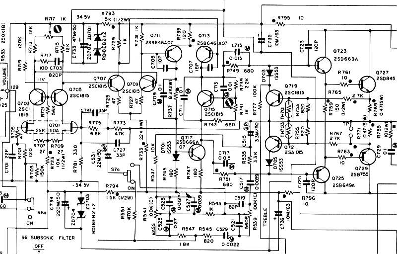

any one succesfuly substituted 2 jfets for this dual?
matching might be the main thing to consider.
it is used on power amp input diff any advice?
2SK150 is a single chip JFET and has transconductance of ~8mS@1mA, ~12mS@2mA while maintaining low noise. Something comes close to this is two matched 2SK117 pasted together (of course, the drift would be worse). Toshiba lists 2SK389 as a substitute for 2SK150 but 2SK389 has higher transconductance so the frequency response would be different. Pasting together two matching 2SK170 is a good substitute for 2SK389 electronically (except for the drift). uPA63 or uPA68 are good substitute but I don't know where one can get them. Good luck!

Interesting amp, never seen a schematic with a K150 on the input, only as cascode devices for higher octane dual JFETs.
