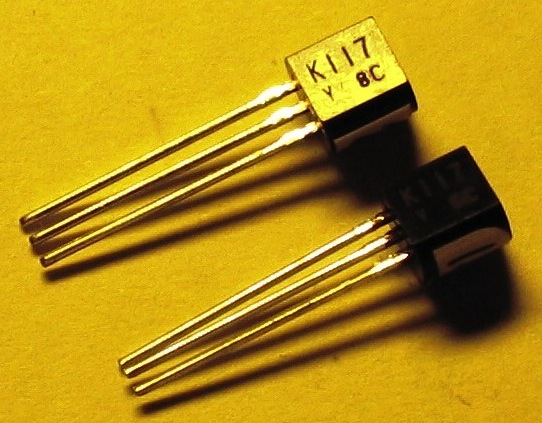

Seems it was all my fault...the 2SK117Y comes in the TO-92L package, and apparently has no defineable specifications that I can discern. If I want a 2SK117 in a TO-92 package, I have to order the 2SK117GR.
Don't ask why the focus seems to be on the device package...my explanation that the package was NOT my primary objection, that the device does not meet published electrical specifiations, always seemed to go right over their head. No matter what I wrote, it always came back to the device package ('You want TO-92? You order 2SK117GR"
I give up. These devices are going in the trash, and I do not recommend dealing with these people (http://www.utsource.net). I'm only out $25, but it still chaps my a**.
I dare to disagree.
http://www.semicon.toshiba.co.jp/docs/datasheet/en/Transistor/2SK117_en_datasheet_071101.pdf
2SK117Y is TO92, 1.2-3mA Idss.
The photo shows 2 of the 30 2SK117Ys that I bought from a Japanese source. All were measured; max Idss 2.6mA, min 1.4mA.
They do exist, just very difficult to get.
Patrick
I dare to disagree.
Patrick
