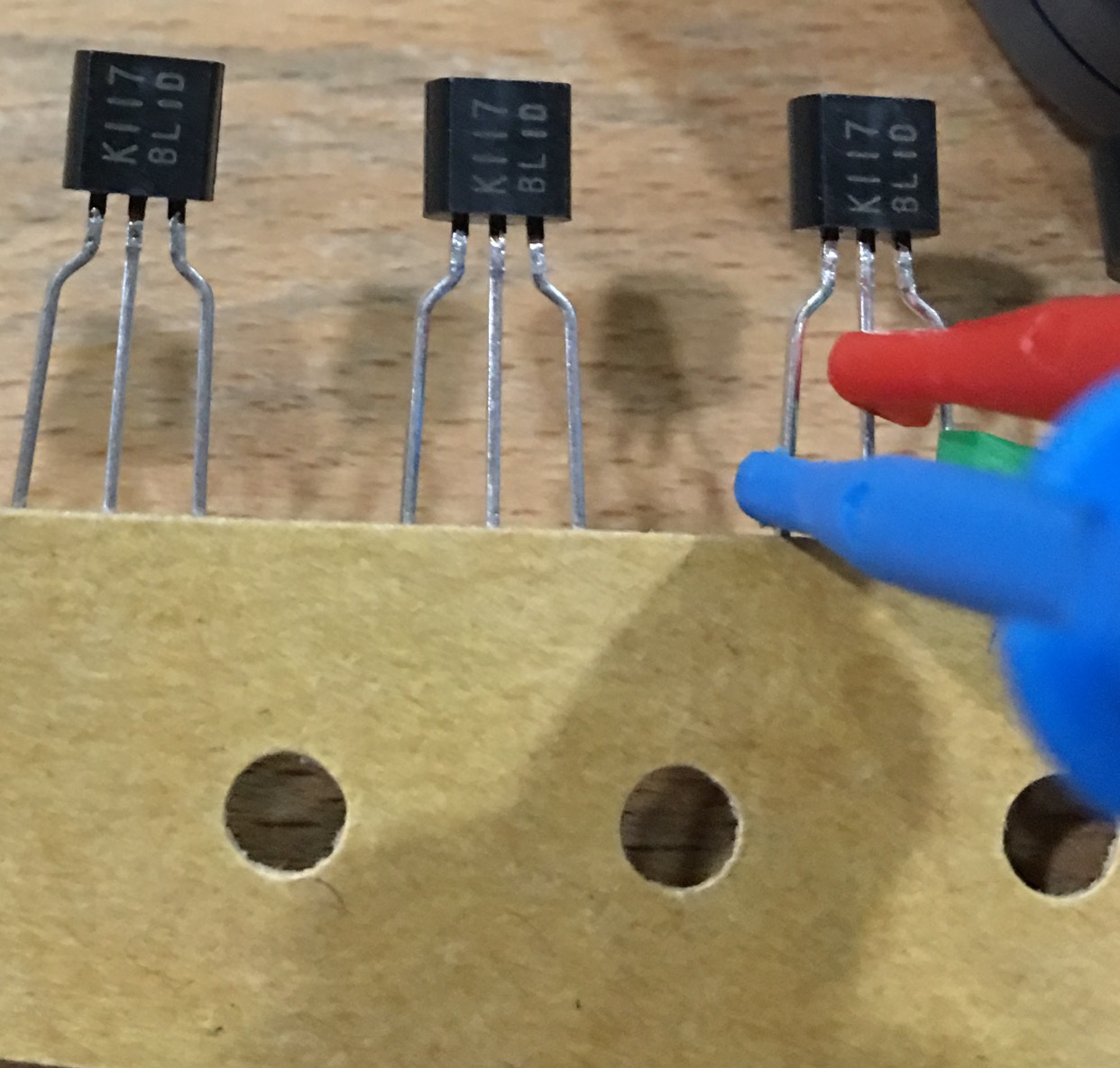

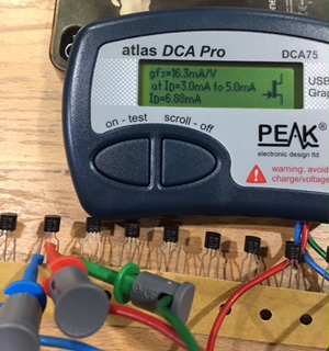

Some pix for your ref.
Thanks prakit,
I need 4-6 pairs, happy to pay more if matched, let me know what you want.
I'll PM you to arrange.
Appreciate it greatly.
I will take 3 matched quads if possible.
