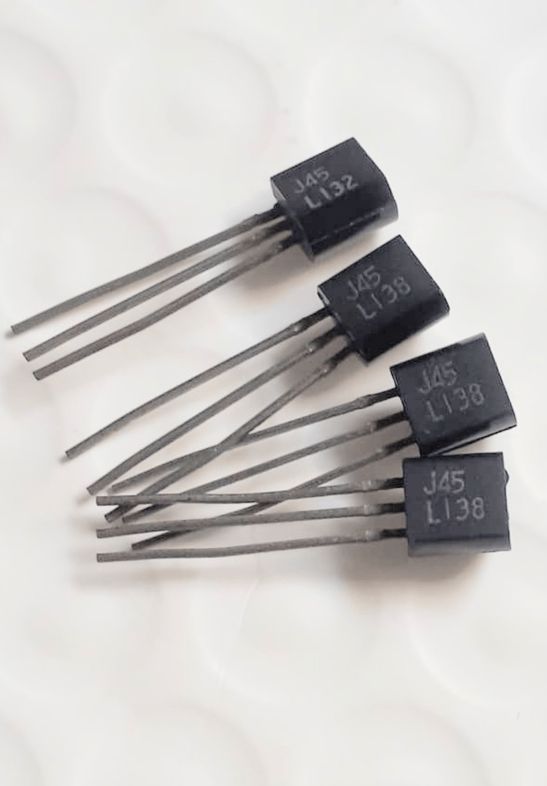

I have some 2SJ45's. Specs are almost identical to 2SJ44 (except for the noise voltage). If you want to give them a try, I have a few matched quad ones with an Idss range like your 2SK163.
BTW, are you sure those 2SK163's you have has an Idss rank of N?
Based on the Idss samples you've got, they should fall into the rank L.

@bango Thanks for the offer and info! I took another look and you’re absolutely right - mine are L grade. I may take you up on the J45 offer. I’ll reach out in a few days and see if we can work something out.
