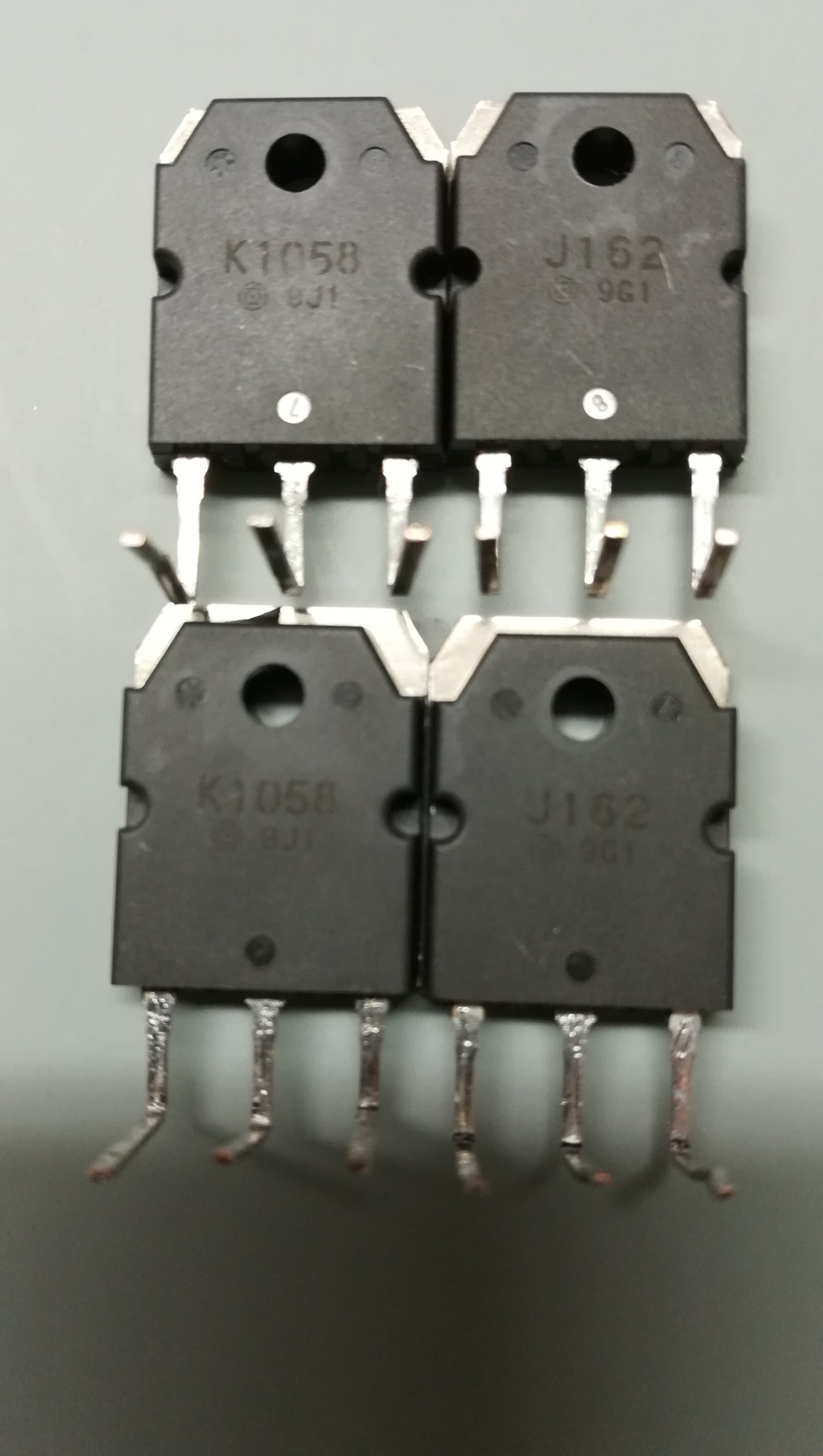

These days if you buy them from eBay or Amazon expect fakes unless you know the actual supplier involved is good. A good quality photo is needed to look for the signs of re-marking - most re-marked chips are matt black finish before the printing, most original chips are as cast in the mould, either shiny or explicit texture. Re-marking involves abrasive or solvent resurfacing before printing, losing the original finish.
A good image of known-good devices is useful to check against - details of lead frame and epoxy moulding vary between manufacturers and plants.
Fakes usually have an fixed datecode which can help identify. The printing style may be somewhat different too.
Non matching pinout is GROSS and screams regular switching HexFet or similar instead of expected Audio ones.

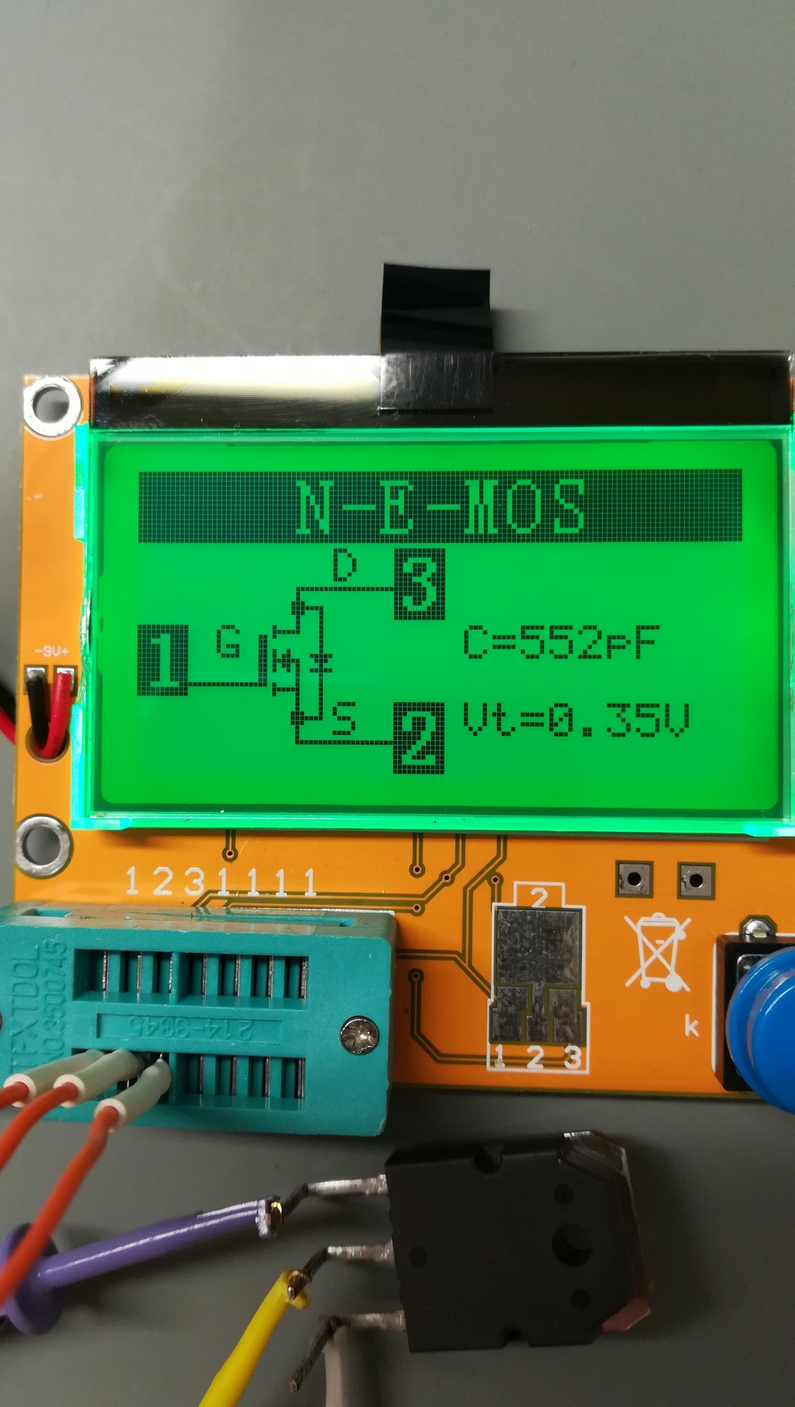

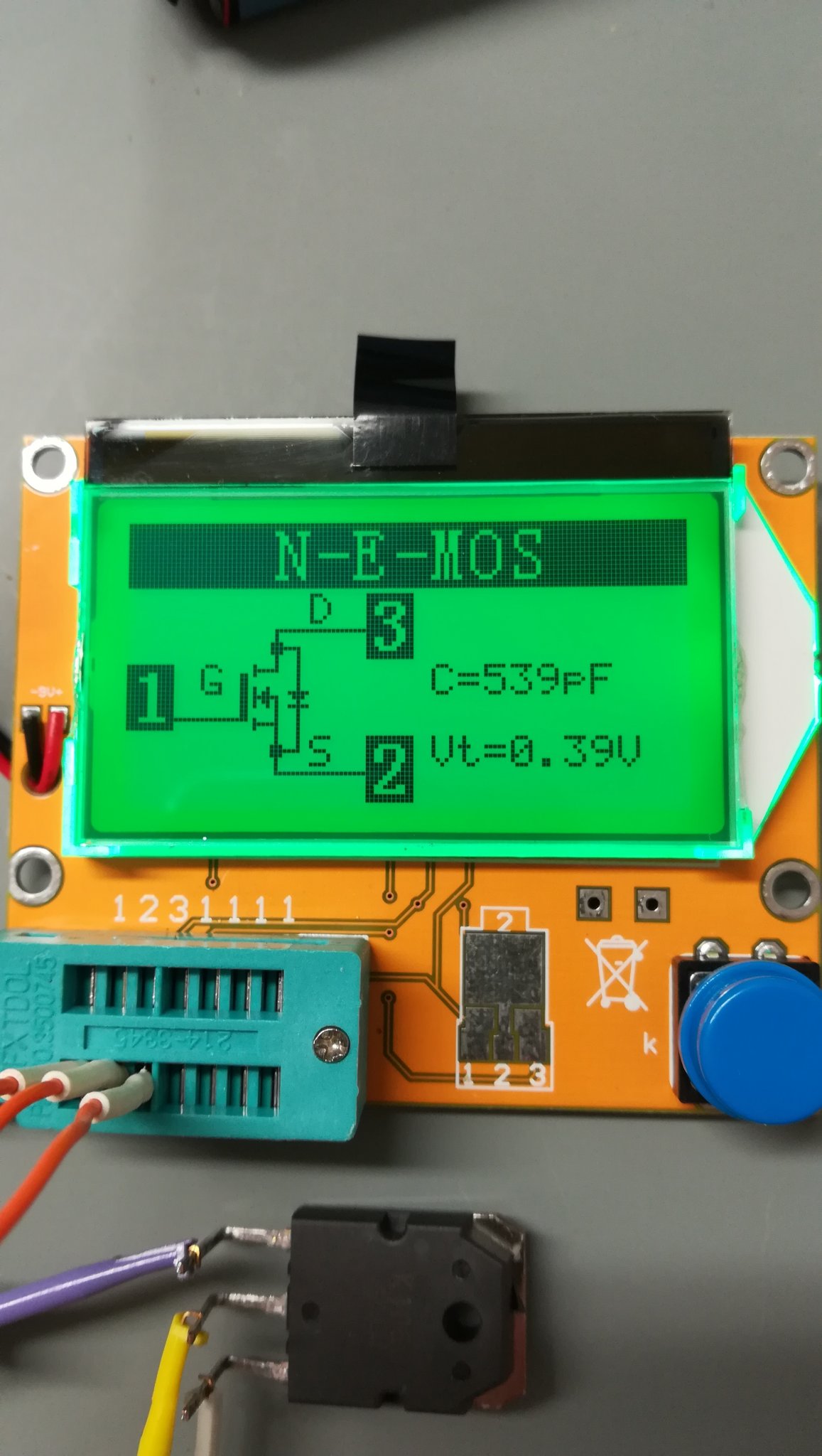

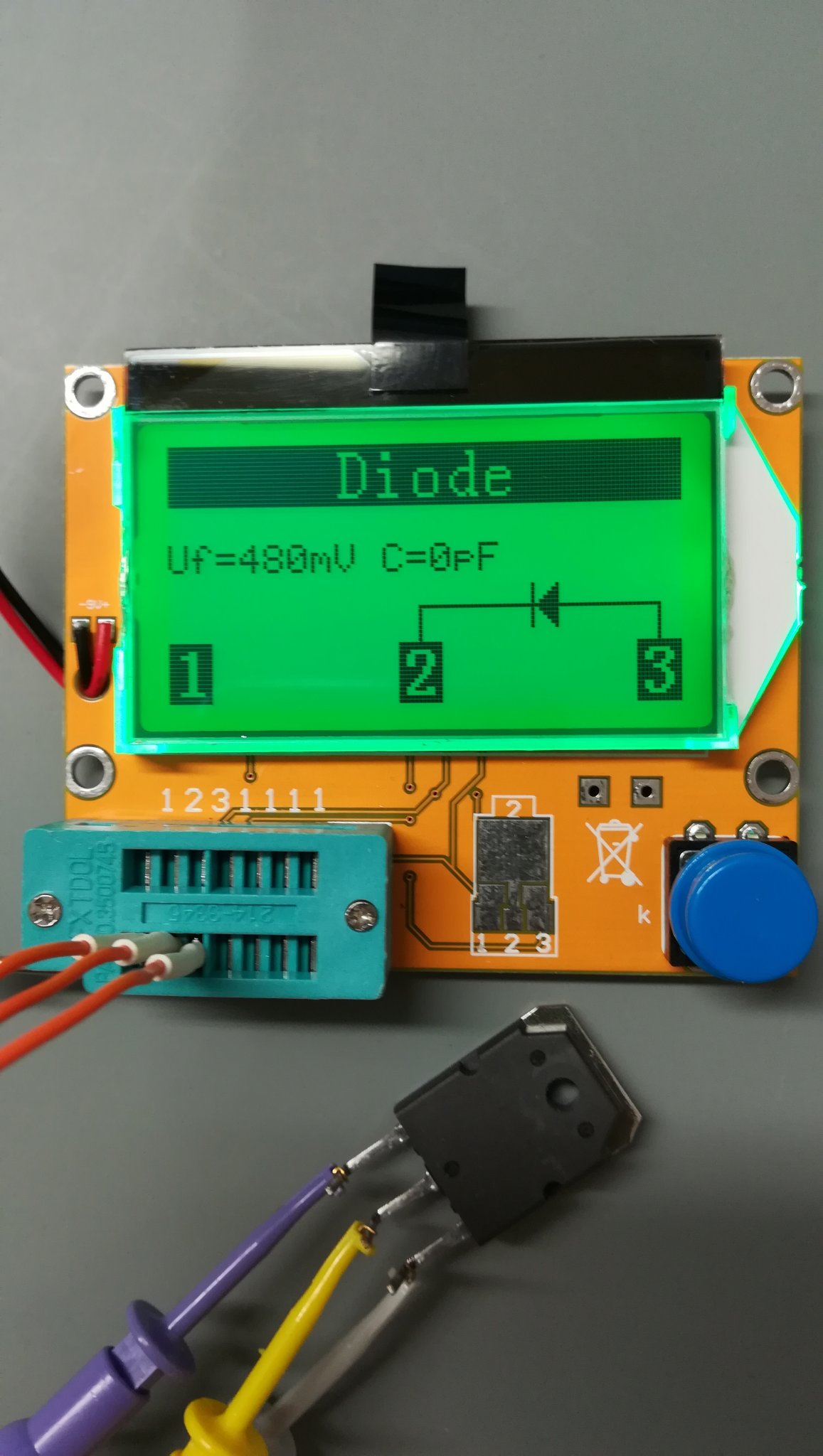

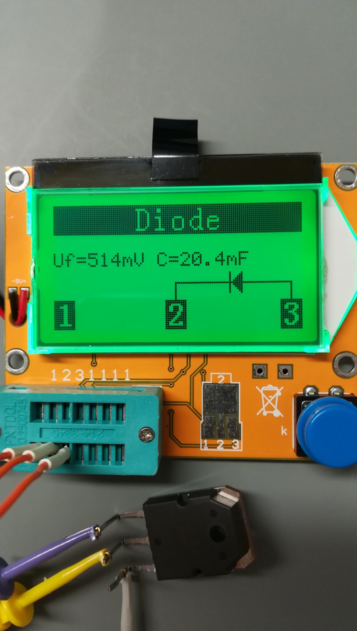

Martin, then you really need to make your best to clarify the situation.
First of, show us the actual pinout, simply draw it on the any photo on your phone or in MS paint, that's the main keystone.
Next, try to perform actual Id/Vgs curve at simple point. One AA battery (+ to gate, - to source of N type 2SK1058 and - to gate and + to source of 2SJ162) and one 18650 or any car 12V accu.
This voltage must provide something inbetween 200-800 mA drain current, more like to 500 ma with a tendency to fall while device will heat up.
It will be better if you can make a photo of the overall test bench.

Hi Gentlemen,
I have two pairs 2sk1058/2sj162 and need your help to clear the question wether they are fake or not?
The two first pics show testing of 2sk1058, the next two - 2sj162.
Testing with DMM does not provide clear results.
Thx in advance
