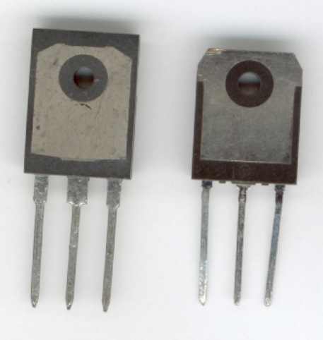

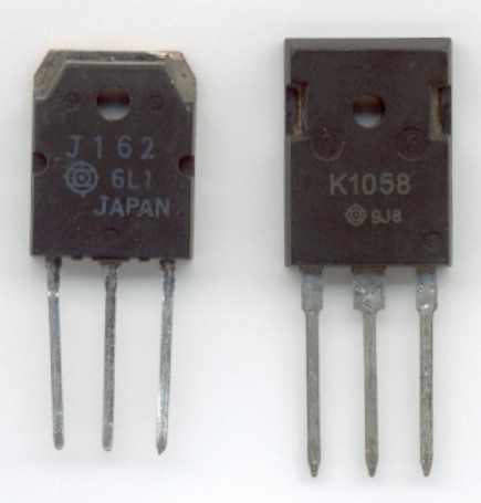

I just bought 2 pairs of Hitachi Lateral Mosfets 2SJ162 and 2SK1058... I hope.
As you can tell, I am suspicious. Why? Because of the price, markings, and shape of the 2SK1058.
1) The 2SK1058 is shaped differently than the diagram in the datasheet.
2) The markings are different from a picture I that I saw.(I have only seen the one pair, mind you)
3) The price was too good to be true!
Is it possible? Did I stumble upon the fabled free lunch?
Here's is the pic of the pair I've seen:

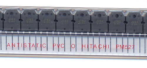

I hope they are not fakes, because they look just like
the batch I bought!
I bought mine from a local distributor that I was directed
to from Hitachi, so I would hope they are real.

Not sure about the 2SK1058. When I said mine looked the same
I was refering to the first pic (2SJ162 and 2SK1058 in same package).
Tim
Tim
The one on the right appears to be in a TO-264 case instead of the standard TO-3P case that most of the japanese semi manufacturers use.
I can't see hitachi switching case styles and keeping the same part number, as there are pretty significant differences in the lead spacing between TO-3P/TO-247 and TO-264 if I remember correctly, not to mention the different package outline that could "break" some designs using them.
There are "generic" chinese made clones of some japanese semis, such as the 2sa1302/2sc3281, but they don't have the Toshiba logo on them, and don't really "pretend" to be real devices. The TO-264 packaged device you have there DOES have a real Hitachi logo on it, so it's either a real device (seems unlikely, but you never know), or a fake.
Out of curiosity, did you buy those locally, Sean? I've been meaning to get some and was thinking about hitting pacificsemi up for a few. 🙂
One way to check of course would be to crack a complementary pair open and have a look at the dies -- if they're very similar, they hopefully will be real.
However, if they are real, you can be happy that you have at least one in the TO-264 package, as it's superior to the TO-3P in terms of thermal resistance and current handling (larger/thicker leads)
Edit: It's interesting to note that the lettering on the TO-264 packaged one actually looks like the known good ones, and the one in the correct TO-3P package style looks like it has odd lettering compared to the samples you posted above. Weird!

Fakes
I would say the 2SK1058 is a dud part! Hitachi never used this packing! Anyway, if you need the 2SKs and 2SJs in small quantities, I may be able to help you out as they're still somewhat available over here in Malaysia and my regular supplier services factories! I've used his parts without any problems at all. The price I believe is around USD8/- each but I'm not sure about postage though.

I've also got a pair of suspicious 2SK1058 & 2SJ162. There are from a supplier that sold me the autentic and great sounding 2SK1530 & 2SJ201 that i've been using in my bedroom amplifier for months.
The 2SK1058 has the hitachi logo but does not have the lateral holes, while the 2SJ162 has only "J162" and "7B4" and is identical to all pictures exept in that it does not have any logo.
This amp is for a present so i really need to be sure that these transistors are reliable and that they do have negative tempco.
Any experience with similar-looking fakes?
