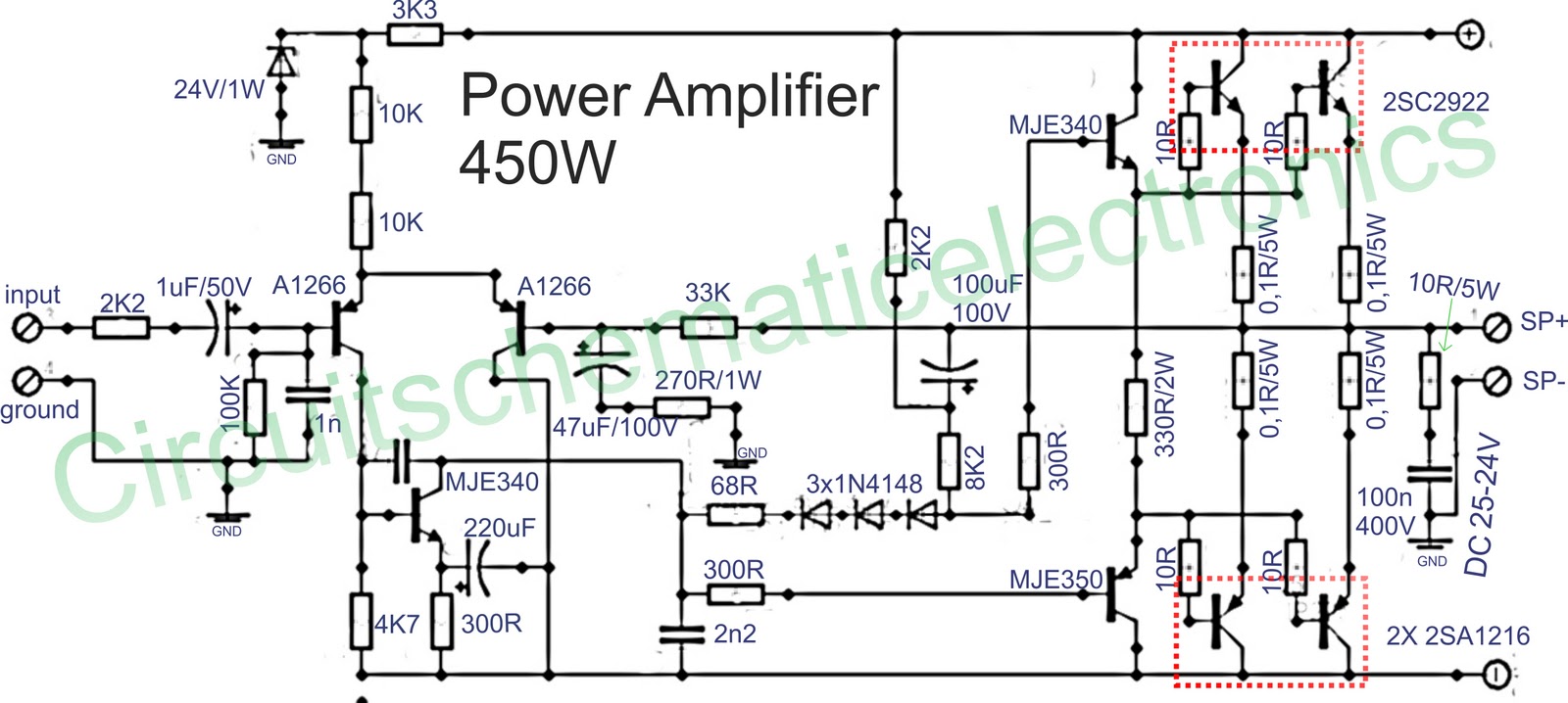

i found this on web. any one build amp with these transistors?
The design is not optimal. VAS transistor choice, how to compensated, etc. Better you build Honey Badger, OS's design. You can found it in this forum.
Sanken beasts

thanks for reply guys. any one have better design with these transistors?

Thanks vzaichenko. third one is much better. i have another question, can i use 2922/1216 in DX amp?
I believe - would not be a problem, they are pretty versatile - fast, powerful, relatively low Cob. However, better ask Carlos (destroyer X) - he is the author 😉
