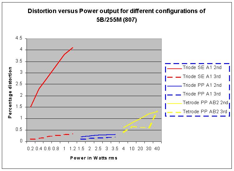

I have been playing with a design for a friend using 5B/255M valves. These are basically a loctal version of 807 beam power tetrodes. My initial design and breadboard was a PP amplifier and it performed very well - but I thought I should knock up a SE version to compare with, in case he prefered that. The SE was not bad but was clearly worse than the PP. To try and see a little of what was going on here I measured the distortion in both modes and found the PP to be much, much lower for 2nd harmonic and about half as much third harmonic too, so I'm not surprised that the PP sounds better (in this case).
So then I thought I would try the out of fashion Tetrode Class AB2 PP just for fun. So I tweaked it to Class AB2 added a smidgeon of feedback (6dB) and sat down to listen.... I was very surprised! It sounds really good. Actually really really good! Close to the A1 pp and better than the SE! So to measuring again. Surprise it has a nice distortion spectrum! Second higher than A1 PP but much less than SE, third nicely less than second... hmm...
My speakers are fullrange about 7ohms impedance in a reflex cabinet and about 95dB sensitivity. Source battery powered CD player. All amplifiers fixed bias and IT interstage. Driver tubes 6N6P. PP amps are PP throughout.
Here is the graph of the measurements.

Interesting post, and one which basically tallies with both what I've read, and what I've measured myself in the past. The 807 is one of my fave tubes (I have boxes of them in all flavours). The STC 807 datasheet (5.5M) might be of interest if you haven't already seen it. Excellent data with lots of graphs of different output stage configurations and distortions for 2H and 3H
If you have the facilities, it's very interesting to note the higher harmonic content in the different configurations, and how they change with level.
I'd be interested in seeing your schem for the A1 PP if that's possible.

The Ra-a was 7.5K also in AB2. I didn't measure any other harmonics as my kit at home doesn't do it. I guess I could take it into work and put the Spectrum analyser on the output... Work is a bit busy at present so it might be a couple of weeks before we get to that. I'm curious as to the extent of crossover distortion and to the upper harmonic signature too. Through my speakers I doubt I pushed it beyond 10 watts at most. I was surprised at how relaxed it sounded and how good it's imaging was. I'm very impressed with the 5B/255Ms. BTW I didn't run them very hot - only 450volts on the anode and 250 on the screen grid. Also after 40watts the 3rd harmonic climbed away but the second had peaked and dropped down by about 30% after that...

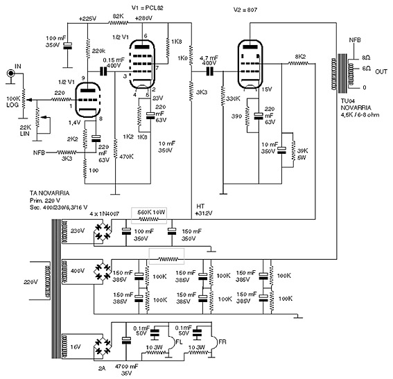

Ciao Filippo,
Forgive my replying in english. My Italian is almost non-existent despite living in Roma for one year...
Your circuit is a nice SE one. Have you tried the 807 in triode mode as well as tetrode mode? If you have, what did you find of the difference in sound?
I like your site and have often referred to it for ideas for circuits.

Hi James
also my english is pretty rough...
i didn't try the triode connection because the HT is too high. I choose an high HT for achieve a class A2 driving with an high polarization. Actually the cathode voltage is approax 15V, and the high swing of the PCL82 can drive the 807 into the positive grid area and the low R load on the anode of the driver permits also a good current if the grid of the 807 need it.
ciao
Filippo

Hi Filippo,
Good point about the high B+ on the 807. I have been told that in triode mode one can run the screen grid over it's normal voltage rating but I wouldn't like to go too far over it!
I like the PCL82 valve! My office system is an ECL82 SE design and works very well.
ciao
James
