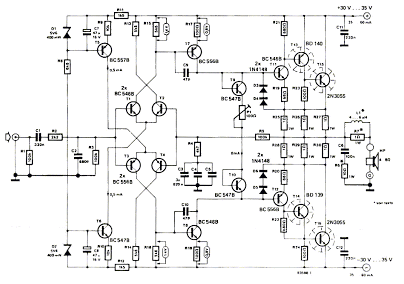

Hello, i'm seeking for a way to apply a few of these chips i have in the scrap box, and was wondering of a nice amplifier, maybe around 100W. I will gladly sacrifice power to have better quality, but with these parts, i know there are limitations 🙂
Seen a few around the internet, but failed to get the complete project, that is:
Schematic, pcb, parts list, layout and some sort of alignment indications if necessary.
Would be appreciate some pointers to a nice proven project.

More than one pair will be needed to get 100W, and the 60V maximum voltage will make it tough to even get 100W into 4Ω.
Perhaps you might build a bridge amp for 8Ω?

100W/2N3055 seems to be an evergreen formula for amplifiers that has been around more than 40 years. A single pair of 2N3055s will produce 40W into 8R and more into 4R but that's actually plenty of noise - more than enough in most homes.
This is a favourite design that dates back to around 1980 - I know of 4 stereo builds still working too!

Hello Ian,
You just provided the schematics of my all time favorite Elektor design. I built it almost entirely with components from my scrapbox. The whole thing did ot cost me more than a handful of (now) Euro's. The design came without a PCB, but that was quite simple making a layout that roughly followed the schematic.
One of the very few amps I built that performed flawlessly right from the start.
A very very nice design that rivalled my Crimson 608 a somewhat comparable design with the famous Quad Triples as an output stage.
Around 1981 a design with complementary triple output stages (305/2955) was published in WW by a certain gentlemen named B. Cody, if memory serves me well..
Both the Elektor and WW designs are highly recommended for building.
BTW😀o not let the "a 100 mHz output device is necessary for hifi" guys scare you off.

.................maybe around 100W. .................
More than one pair will be needed to get 100W, and the 60V maximum voltage will make it tough to even get 100W into 4Ω.................
A single pair of 100W BJT output devices will get you a reliable 40W amplifier that can tolerate severe reactance speakers.100W/2N3055 ............. A single pair of 2N3055s will produce 40W into 8R ................
2pr gets you upto 80W and 3pair gets upto 120W
These higher power versions will be limited by the maximum supply rail voltage.
A 100Vce0 device should not be used on supply rails exceeding ±49Vdc
If you want to use a 35-0-35Vac transformer then I recommend you use >120Vce0 transistors. But do check the temperature de-rated SOA at the supply rail voltage. Some are terrible when operated at half max Vce0.
Good to know someone else likes it too, for a design that seemed unpromising so long ago. It's actually the Crescendo design adapted to use craptanium BJT output transistors. I think though, it has much better performance and SQ than typical EF2 2N3055/MJ2955 complementary designs, which is why I suggest it in preference.......You just provided the schematics of my all time favorite Elektor design....Eelco
There's a larger image of the article here: http://www.diyaudio.com/forums/solid-state/242341-audio-amplifier-2n3005-3.html

The Elektor amplifier looks good, and I would add some emitter degeneration resistors to the diff pairs.
(an easy mod similar to the Leach amplifier design)
