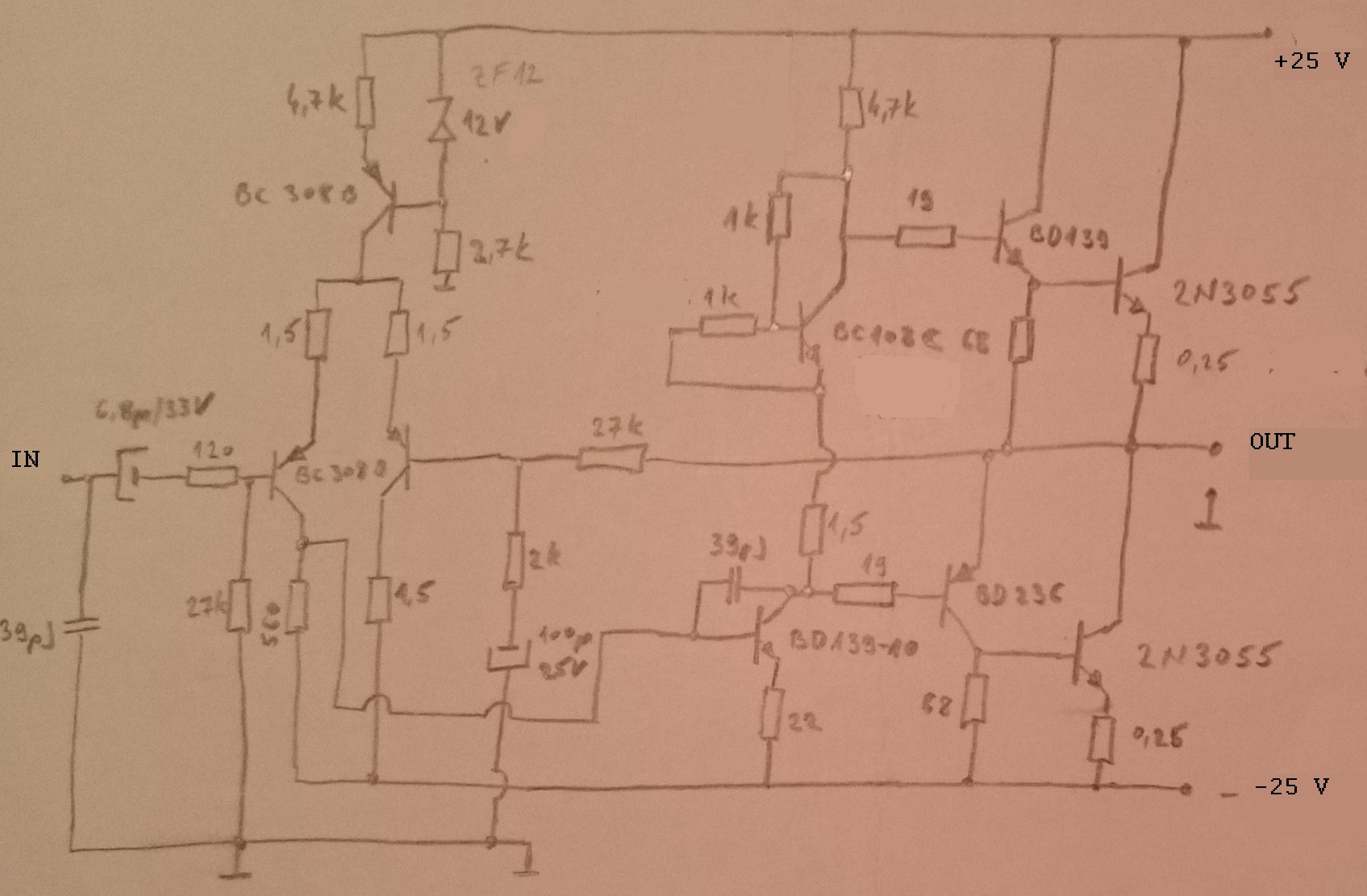

Thank you for your advice.
Ok, main problem is speaker protection. I use uPC1237 for protection.
I use this amp for quite a long time without problems, and it's have pretty clear sound.
Now I want more power, about 100-150W on 8Ohm, and searching for simple but good amplifier schematic.

Glad your old circuit worked for you, it looked competent if low power. You possibly had original slow Ft 2n3055 so you didn't need the OT base resistors .
For 150-200 W/ch, honeybadger comes as a board or kit from diyaudio store, see the sticky thread up top of the forum. Diyaudio store is a button on the top options line. Honeybadger does require a center tap transformer, so buy the speaker protection circuit add on kit. The PWB is a little long for my existing enclosures, but two would fit in a metal fold top file cabinet, for example, a $5 solution to the packaging problem. I need metal packaging, I'm close to a street where CB radio enthusiasts drive by emitting annoying RF signals .
UPC1237 is a good fault sensor, to trigger a relay disconnect of speakers on DC detect. When I tried to buy some there weren't any in stock. For a 1300 W amp with ****y crowbar to ground protection I find the 8 v silicon bilateral switch (diac) bs08d from powerex to be a modern in stock sense solution. The sbs is fed from the speaker line by a resistor/capacitor to ground time delay filter, and the signal out the back triggers a latching circuit to turn on the disconnect relay drive. I'm using a bidirectional input (two LED's back to back) optoisolator to trigger the set of my 74HC74 latch. Power up reset triggers the reset line of the latch, and toggle is grounded. An HC part will put out about a milliamp to energize something, I use PN2222 transistors to drive red/green indicators, and in series some FET driver IC's.

This circuit will not reproduce positive voltage swings properly due to a missing detail: It lacks the usual bootstrap (or alternatively a current source) from the output to the VAS.

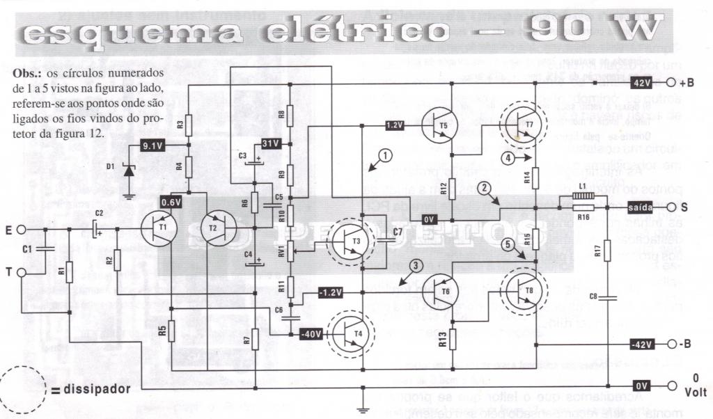

I make this amplifier, and not to start working properly. Always something burn. terrible amplifier.

Hi
I really do not understand why this amplifier 2N3773 works problems.
1. I use Bulb Tester 60W, and everything was fine.
2. I set quiescent current about 75 mA, 50 mV over R14 and R15 resistor
3. Output voltage cca 3mV
4. I put on the base of the output transistor 10 Ohm resistor, to prevent oscillations.
I find this same schematic with voltage level, schematic is attached.
On this schematic driver transistor have a driving voltage 1,2V and -1,2V , but in my amplifier I have
1,25V and -0,62V.
I do not understand why I can not have the same voltage as shown in the schematic.
I decided for this amplifier because of output power and because it is not complicated and is similar to my old amplifier. (schematic is on first post in this thread).
I gave up on this amplifier, burned me 10 transistors and a few resistors.

If you don't have a wiring error (difficult with a PCB but not inpossible) then check for oscillation at the base of Q8, the place where the DC voltage is -0.6 instead of -1.2. DVM miss a lot of what goes on.
Short the input, put on light bulb limiter box, check that point with a scope. No scope, (I don't have one working) check with 2VAc scale of an analog voltmeter. Connect negative of analog voltmeter to analog ground through a 0.47 uf capacitor. (analog voltmeter will read DC voltage on AC scales).
If significant voltage, and you can't hear anything in the speaker, try again with a 390 pf capacitor blocking the negative probe. If still have significant AC voltage, you have ultrasonic oscillation.
A similar amp, engineered out more carefully is the Panasonic Sa-73. Perhaps you can take your current parts collectioni and make a few modifications to achieve that schematic. Thread is http://www.diyaudio.com/forums/soli...across-emitter-quasi-complimentary-stage.html

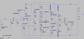

I forgot to mention that I worked simulation in LTspice, and I get same voltage level.
Here are the voltages provided by the simulation
Hi x2x
Your second schematic is an improvement > adds bootstrap bias but still missing a few details and parts values.
Going from memory I believe the PNP quasi pair needs a diode and parallel 100 ohm ( this will fix your different measurement concern -0.62 to -1.2 = a Vbe + missing diode )
so sorry The internet is a place of dubious schematics > Just copy the Dx or the original RCA data book (circa 1970) circuit. E.g. single pair of 2N3055 and +/- 42Vdc ~ 70W / 8 ohm
I wouldn't buy '2N3055' today you don't know what youll get really, there's much better genuine ON Semi for not much more.
