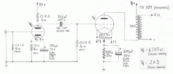

A very simple 6SN7, 2A3
Found an even simpler 2A3 amp, by combining these two schematics we can make a very easy to build amp.
First off, thanks to Alessandro Galavottis very straightforward design for 1/2 of a single 6SN7 for a driver, going to a 2A3.
We can use his design for the front end & the angela design for the 2A3. Still working on number crunching for a merged schematic as I'd like to use the easily available Hammond transformers.
_____________________________________Rick.........

As to my previous post we unfortunately can't 'tweak the 6SL7 circuit to accept a 6SN7 as it would require a full redesign.
Yes 2A3s' in parallel will increase the power output (not the 6SN7s') , but we need to take into consideration if the 6SN7 can drive the increased load, furthur you would need to get two more 2A3s'! And you can't mismatch brands.
Just search "SE 2A3 tube amp"..there are lots of these out there.....especially the 6SN7 variety.
The Angela and Galavottis can be put together...using the Angelas tube rectifyed PS, & the Galavottis amp circuit.the only caveat is dropping the PS from 350VDC to 324VDC....

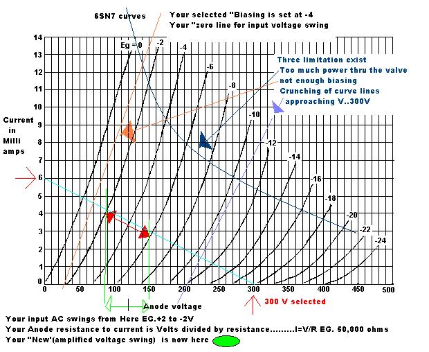

Its' not "bad" , just different, the 6SL7 is a high mu (Amplification factor), and can hold a lower anode voltage (Low power).
The 6SN7 is a lower mu (20 vs. 70) and can manage some 450 volts. You have to take into consideration these values when designing your amp. Like tearing thru anode curves like these.........Part of designing an amp circuit.

You could always use the driver stage design from a typical 6SN7-300B circuit at slightly reduced voltage. Simply replace the 300B with a 2A3 and lower the voltage as reqd.
I have done this, the gain is a little high but otherwise it works fine.
