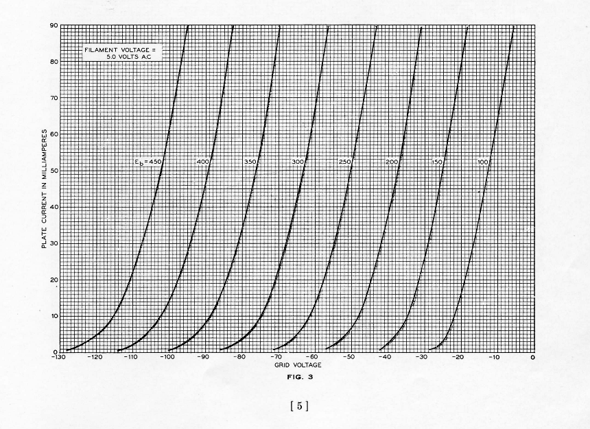

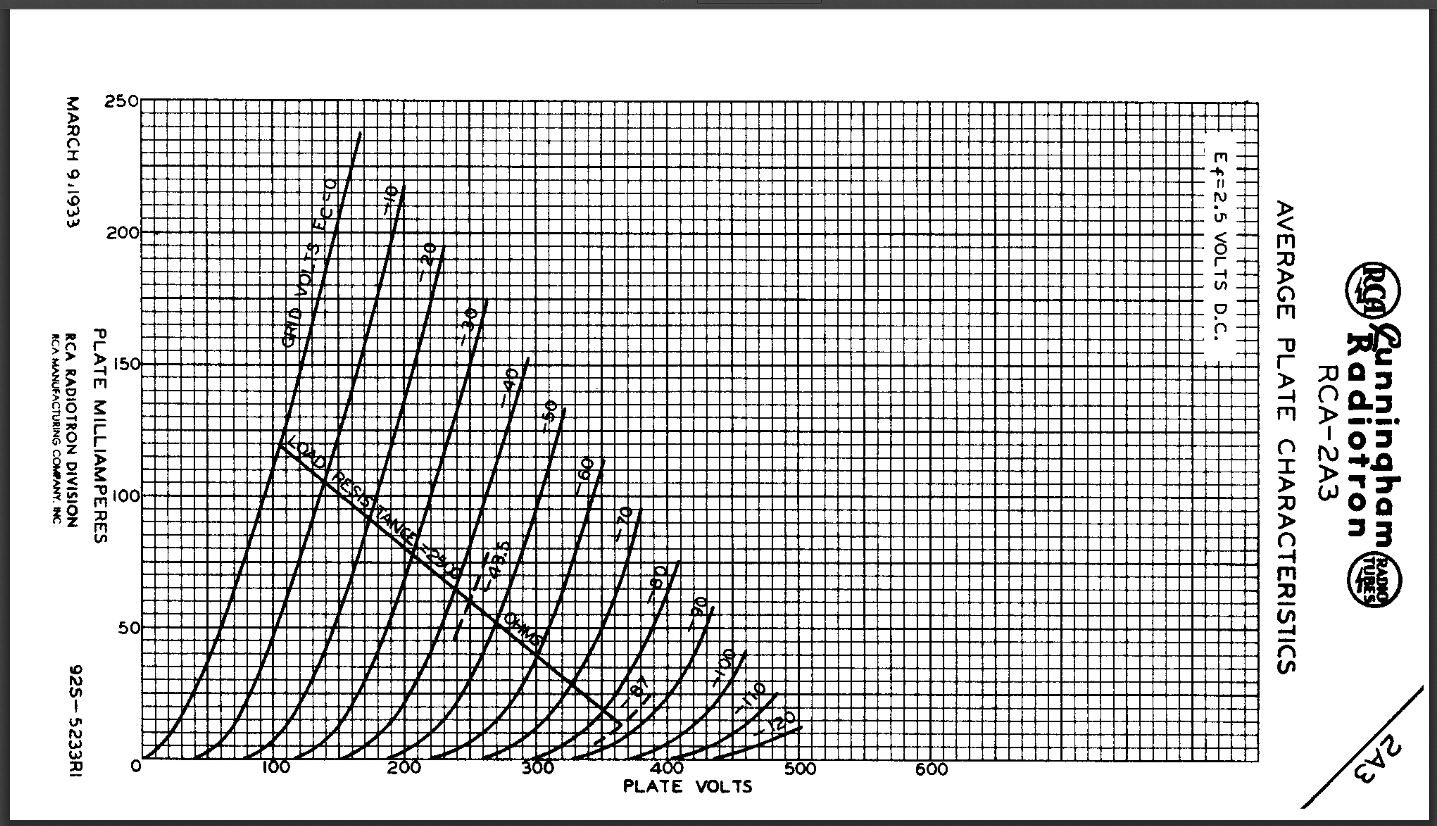

Obviously, between 2A3 and 300b.
If say we bias 300B at 350V A-K, 80 mA, -70V on G1, we need like 150V minimum P-P swing on it's grid. Let's assume that we have 200V available for A-K of 2A3, so with 1:1 interstage transformer we can merry them perfectly. The transformer must be designed for 50 mA current, 100V on 20 Hz RMS.
But since we use 2A3 that needs like 35V RMS signal, we need one more stage with amplification of 35-40.
Any other thoughts?

As I said in PM on FB, the best way to drive 300B by 2A3 is to use in A2 driving through an interstage transformer. Otherwise, forget about 2A3 and use some smaller tubes and A1, as people already suggested.
Any other thoughts?
