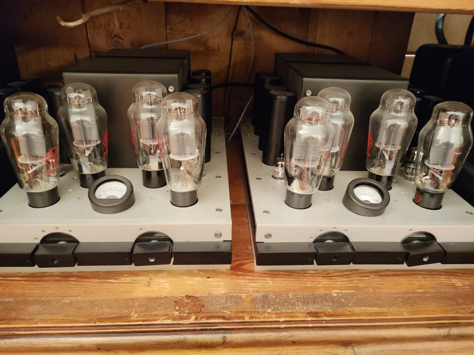

Hi! This is my very first post here. I'm so grateful for all the tips and ideas I've found here over the years, so I hope this post might give a little bit back.
I just finished a monoblock build of 2A3-40:s in push pull fixed bias, with a parallel coupled 5687 as input and driver, via a Tamura A-351 interstage and splitter. The power supply is choke input with a 8H 250 mA choke, but preceded by a small 0.5 uF 1500V PIO cap. Smoothing caps are one 100uF for the output, and two more for the input, all motor run caps.
I run the output tubes at 305V and about 65mA.
The sound is so powerful it's almost scary! It must be because of the choke input power supply, which I truly recommend. All iron is vintage from Japan, which means I use a step down transformer to power them here in Swden, but it works great!

The 2A3-40 ia good tube.
I don't like the chocke input but is a personal approach.

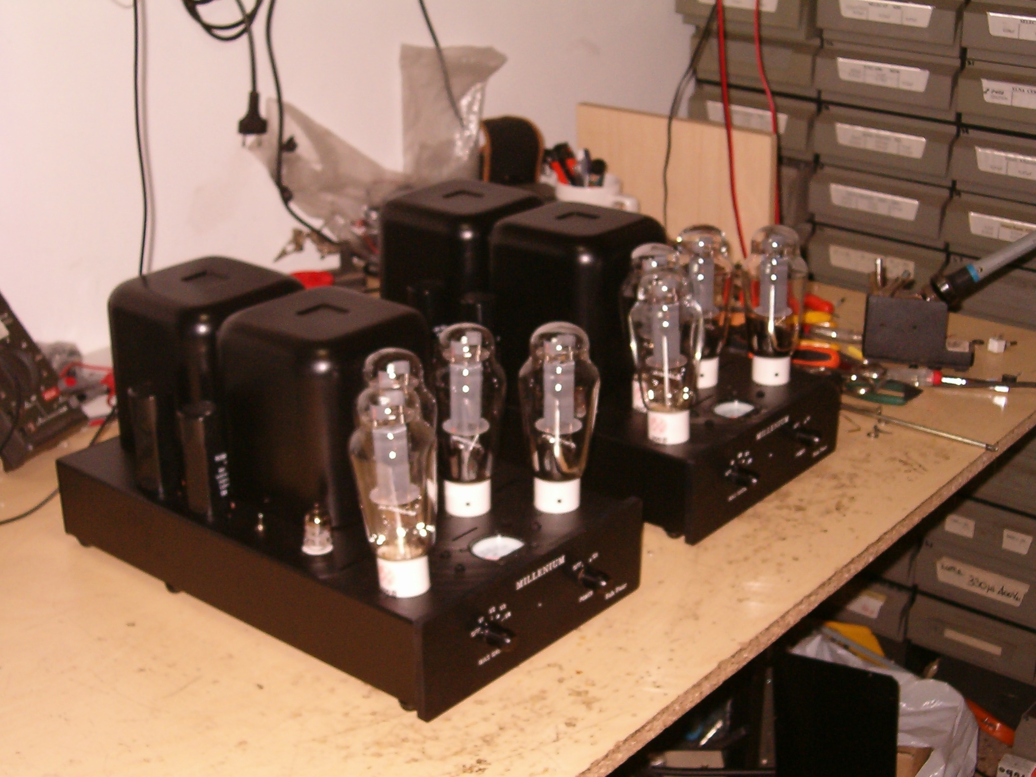

In photo two amps I built time ago, double p-p of 2A3-40

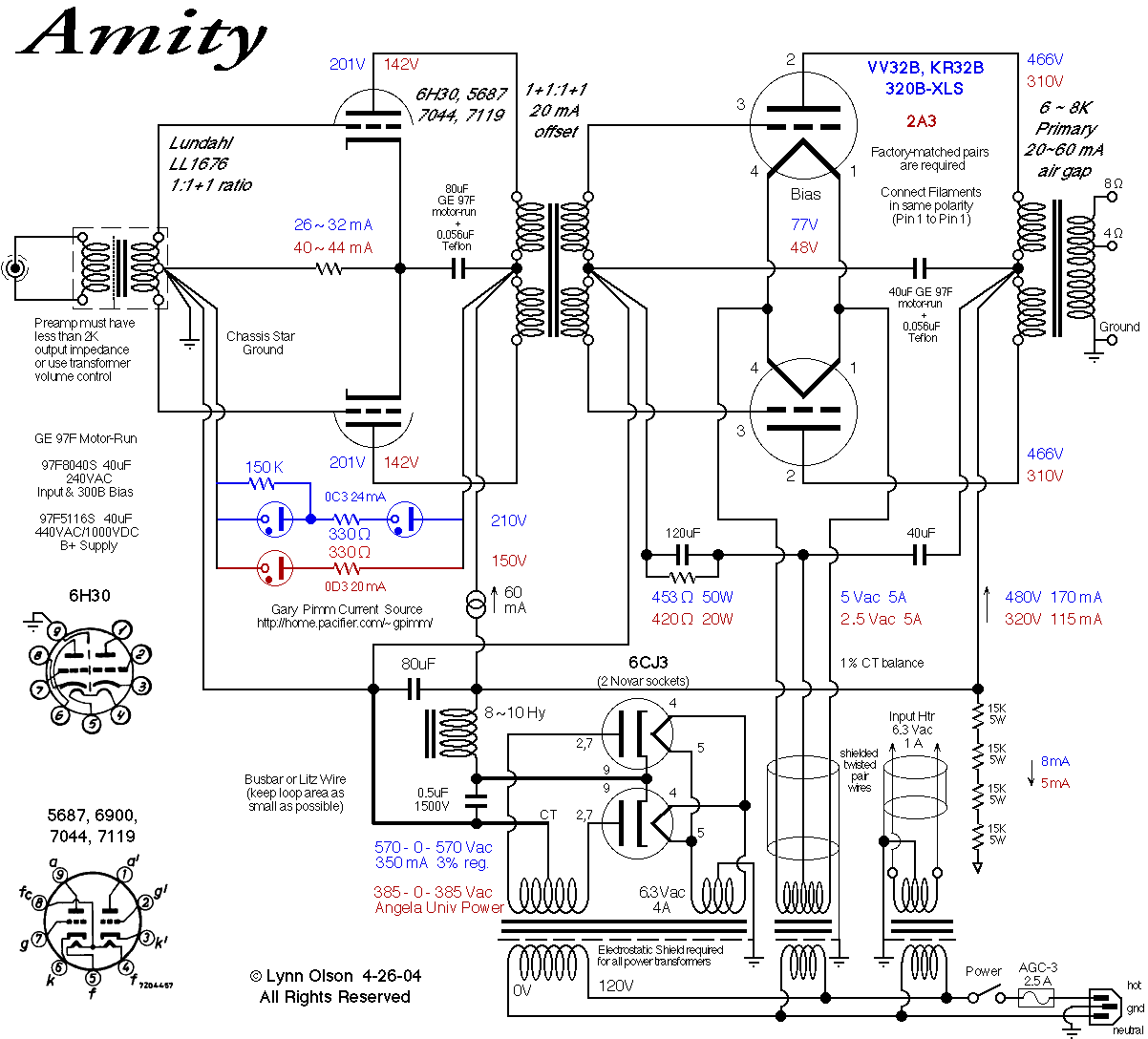

The choke is a Zebra and the power trans is a Sansui P30B, probably 50's stuff? I borrowed the idea of a small decoupling cap before the choke from Lynn Olson's Amity amp, but I'm actually not sure why he's using one. If it's mainly for switch off surge protection or for optimising the hum waveform, I don't know. I happened to have a nice Jensen pio pair that fit the bill perfectly, waiting to be used since 20 years or something.. I have bleeders in there at 4x18k, similar again to the Amity, and the rectifier is a GZ34 - so soft start B+.

The point of the small cap in front of the first choke is to reduce the AC ripple on the choke enough to avoid stressing it, while still acting as a choke-input supply. Originally, high-voltage choke-input supplies used "swinging" chokes, which were designed with variable inductance and could handle the ripple. A modern, inexpensive choke will sometimes "dance" or vibrate if used as an input choke.
Well yes, but I find it hard to believe Olsen would use an inadequate choke, given the high quality of the other components he uses. The value of that small cap was also chosen in relation to the value of the choke, so I suspect there's some kind of tuning going on as well.
It's not about the choke being inadequate or Lynn using cheap components. A swinging choke would be very expensive nowadays and difficult to source. It's simply to reduce some of the strain on a choke that wasn't necessarily designed for a choke-input design. The very small value of the cap has little effect on the output voltage of the supply.

I don't think that small a cap increases the rectifified voltage much, if at all, which is the point. Look at the design. 570-0-570, with choke input the rectified voltage would be 513vdc. Add the drop across the damper diodes, the choke and output transformer, and you're probably about right at his specified 466vdc for the output tubes. If the cap increased this by 40 volts he'd be way over that. In my experience you have to get above 1uF for the input cap for the supply to begin acting like a cap input supply.

0.5 uF: 60 Hz power mains; With 120Hz full wave rectification; Xc = 2650 Ohms
Just an estimation:
With an 80mA load, the peak to peak ripple is 2650 Ohms x 0.08A = 212V peak to peak; 106V on the average.
0.5uF before the choke almost certainly raise the B+ Voltage on a pseudo choke input power supply by at least 40V.
Pseudo, because of the 0.5uF.

Note: 0.5uF and 10H is resonant at 71Hz.
