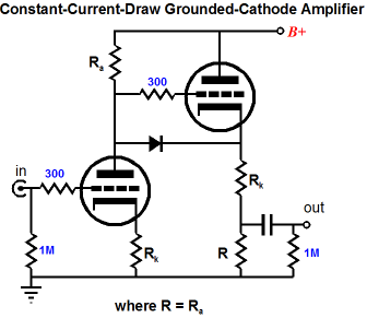

I got some 56's I was going to use for a gain stage in front of my buffer. How would these work as a Anode follower directly coupled to a 5687 cathode follower? Or maybe 2 56's in a CCD grounded cathode amplifier like this?

Thanks for all the info guys! I have about 100 globe 27's, probably 200-300 ST 27's, three globe 37's, twelve globe 56's, and a healthy smattering of ST 37's, 76's, 56's, and 27's. I tend to like the way they sound (like the Tung Sol round plate 6SN7) and they aren't really that hard to implement. Well, back to the preamp project!
