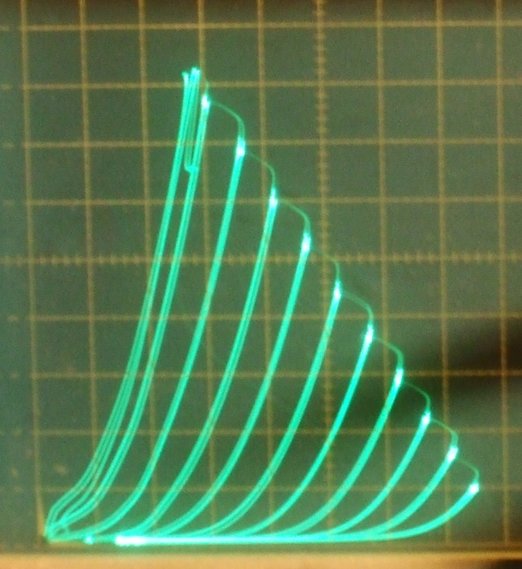

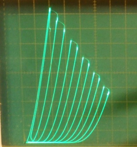

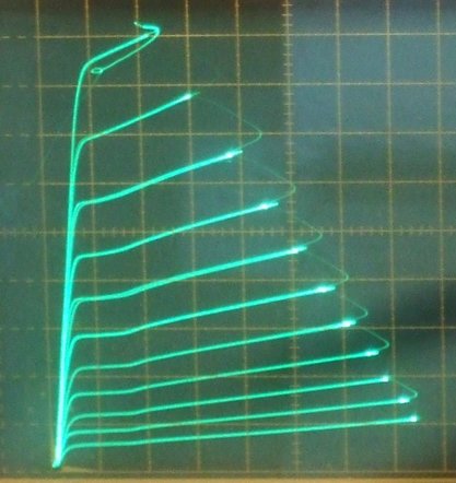

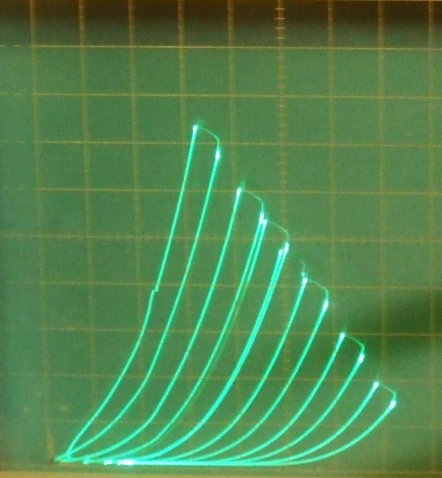

26DQ5 curves: pentode, triode, Schade (Mu 4) 50mA/div Vert., 50 V/div Horiz.
The 26DQ5/6DQ5 is fairly similar to the 6HJ5 (no cap): pentode, triode, Schade
ESRC has the 26DQ5 for $3 and Vacuumtubes.net has the 6HJ5 for $4, and also the 21LG6 for $4 (also similar)

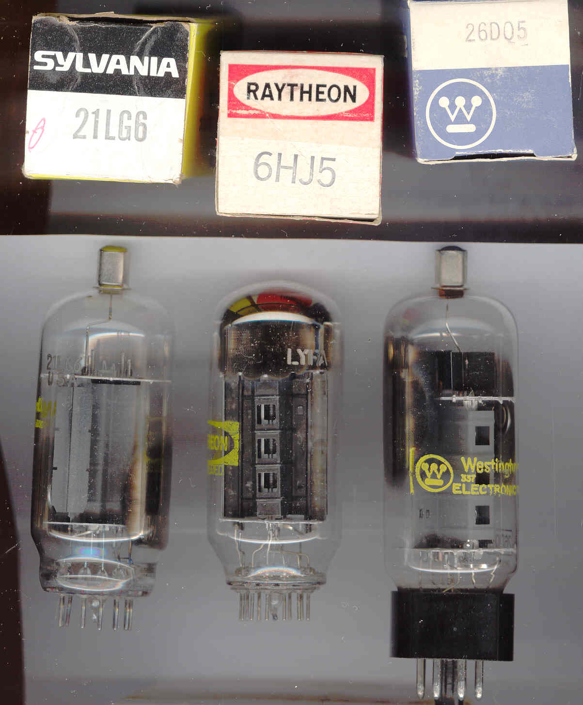

The 26DQ5 I got from ESRC were Westinghouse (Japan F5). Quite nice looking tubes. Octal.
Pics of the 26DQ5, 6HJ5, 21LG6 all quite similar tubes spec-wise. 6HJ5 has no plate cap., 21LG6 is 28 Watt P diss instead of 24 Watt and only 2 Amp heater.

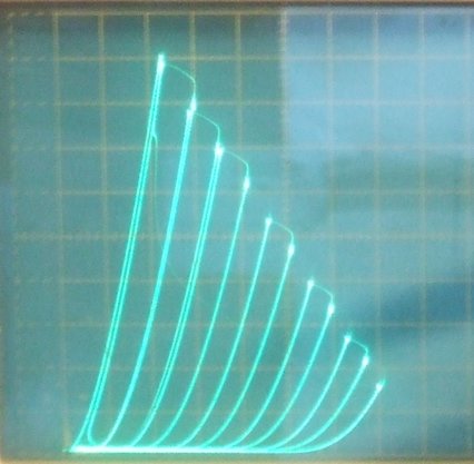

21LG6 pentode, triode, and Schade curves for comparison.

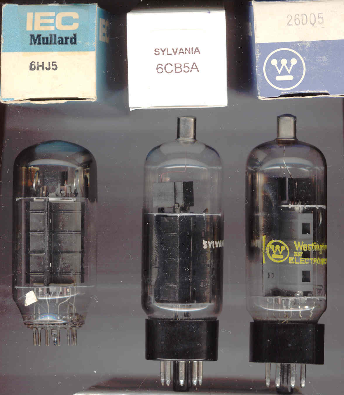

And some pics of 26DQ5, 6CB5, and 6HJ5 for comparison.

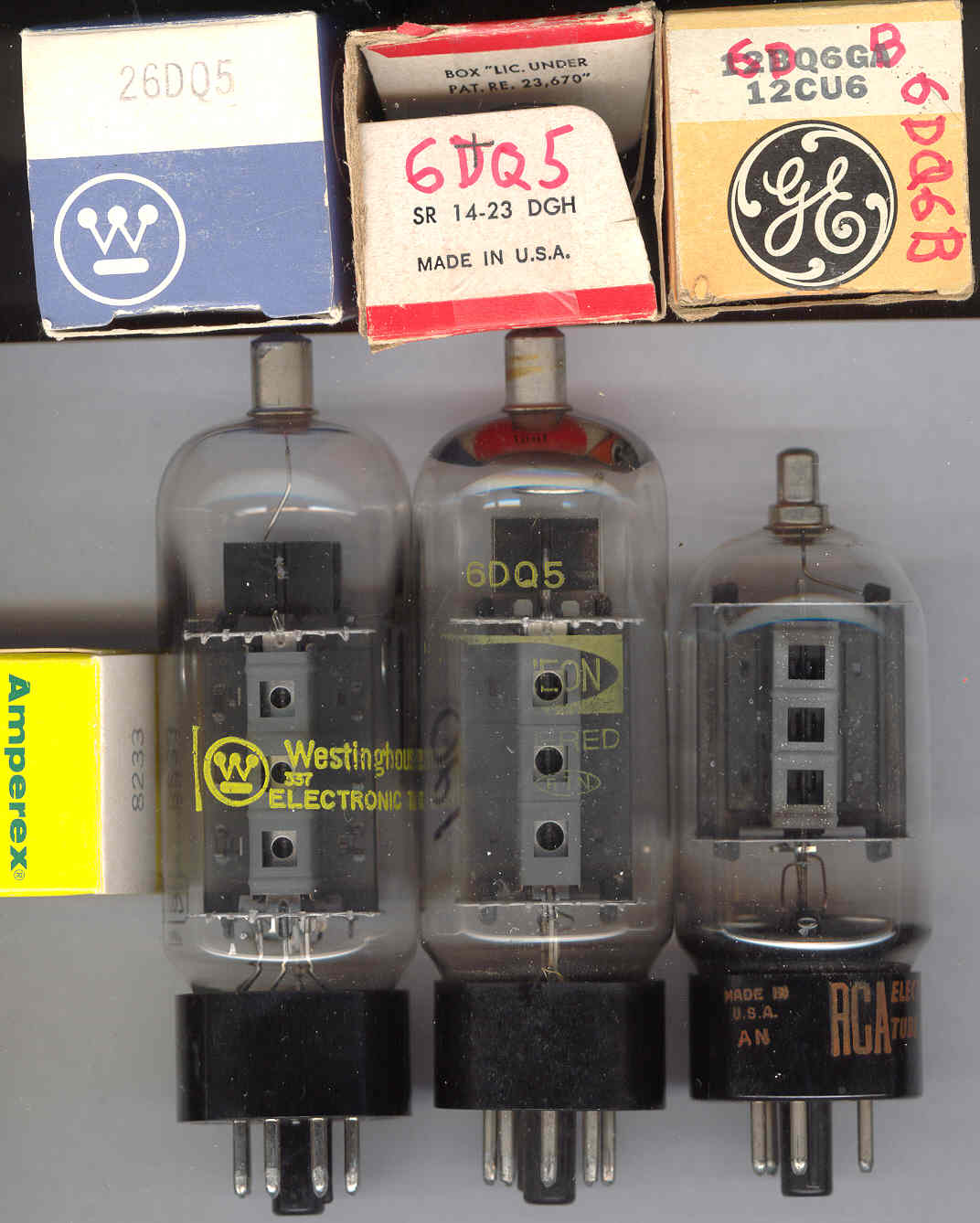

Here is a pic of the Westinghouse 26DQ5, a Raytheon 6DQ5, and an RCA 6DQ6 (wrong box came with it).
The 26DQ5 internals certainly look quite similar to the 6DQ5. Looking through the grid alignment holes, the grids appear to have the same aligned wire spacing and similar spacings from the cathode.
I'm pretty sure I compared these two tubes on the curve tracer before (usually against the 6HJ5), but I can put them on again.

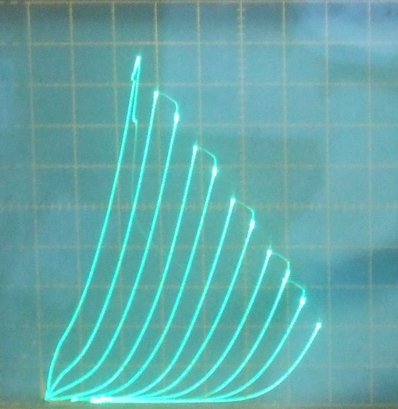

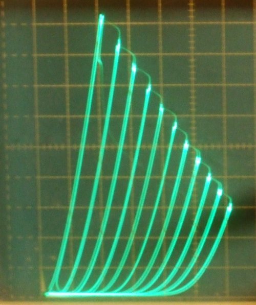

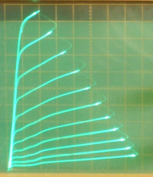

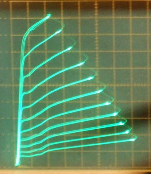

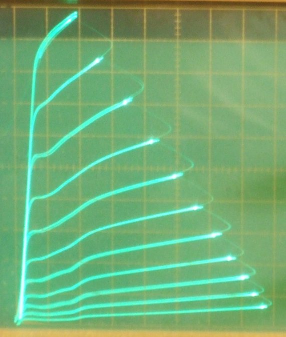

Here are the pentode curve traces for the Raytheon 6DQ5 and the Westinghouse 26DQ5.
For both: 50 mA/div Vertical, 50 V/div. Horiz., 110 V on g2, -3 V steps from 0V for g1
Looks like they would pass for a matched pair, they are so close. There's usually more spread in the characteristics within a given tube type. Just got lucky here.

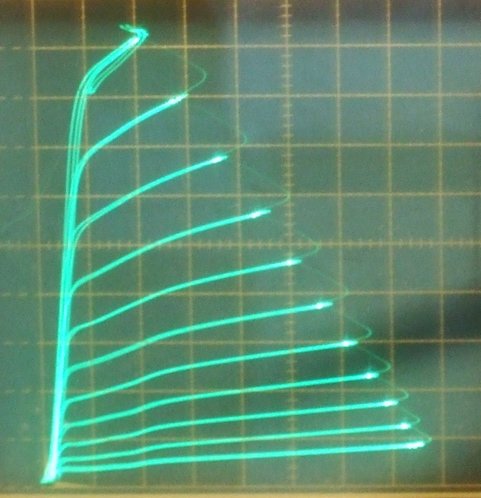

Also attached are the 6HJ5 and 21LG6 pentode curves for comparison. I'm sure they were 50 mA/div Vertical and 50 V/div Horiz. too, but the Vg2 and g1 steps might have been a little different. (taken years ago, no record) Their datasheet specs are quite similar though, so settings would not be off by much difference.
One point of interest between these similar tubes. The 26/6DQ5 does not have (internal) Barkhausen plates. The 6HJ5 has small ones, and the 21LG6 has the later deep pocket Barkhausen plates with an external wing fin for cooling. You can see the tetrode kinks improve from left to right. An RCA paper I saw explained that the Barkhausen plate evolution was found to reduce secondary emission, by causing most of the electron stream to hit the Bark plates at grazing incidence, then bounce to the plate for capture. The usual audio mythology says that the Barkhausen plates sound worse. I think they got that one wrong, but there may be a general increase in design gm with the later tubes that accounts for some increase in non-linearity (at least for some tubes). Two different phenomena. I'll take the Barkhausen plates, at least after checking the curves on the tracer.

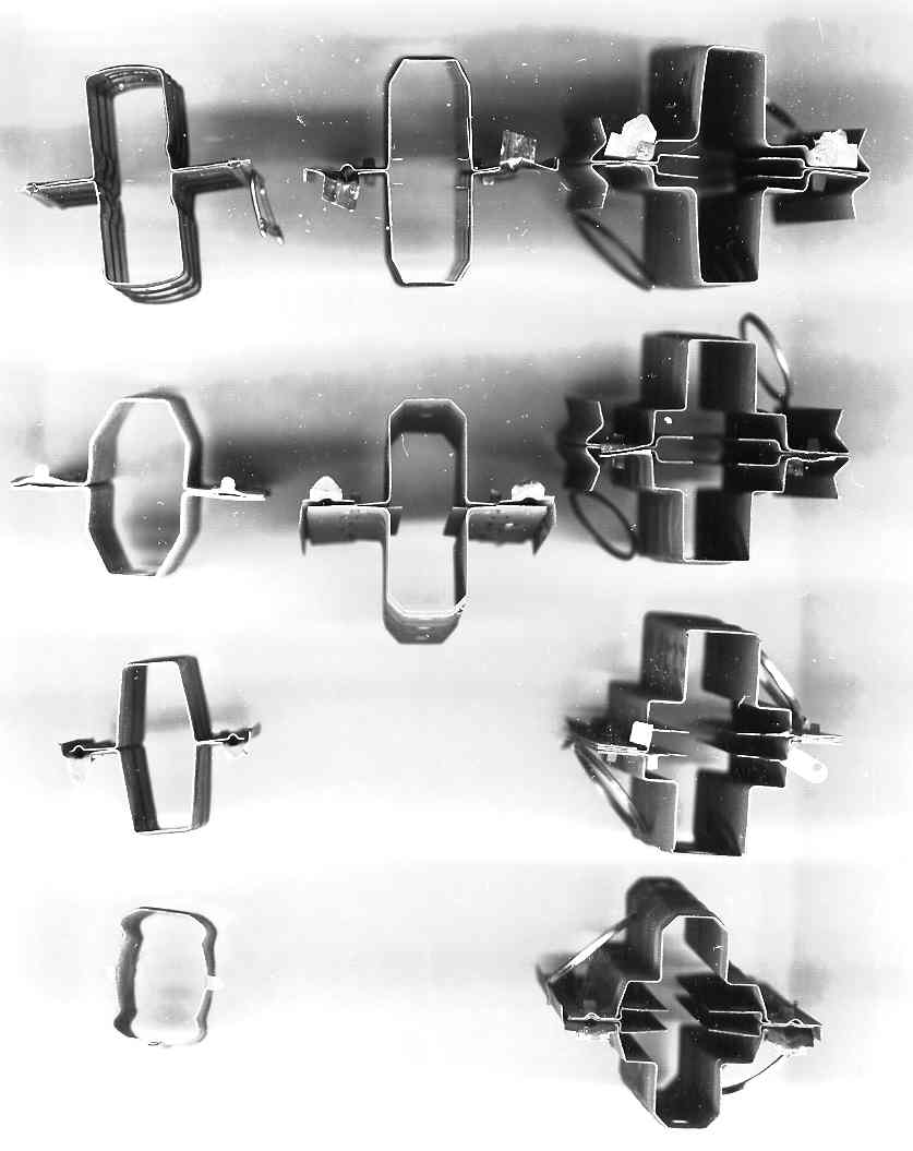

Just to illustrate, here are some plates.
Left ones do not have internal Barkhausen plates. Middle ones have the small Bark plates, and the right ones have the later deep pocket Barkhausen plates. Some tubes just put a small wrinkle or crease in the side of the plate itself.
The top two right ones (36MC6, 35LR6) also having the "wing fins" on the outside for cooling the Barkhausen plates directly.
Left side (top to bottom): 6BQ6, GU50, 6GF5, 6HB6
Middle: 6HJ5, 6GE5/6JN6
Right: 36MC6. 35LR6, 22JG6GA, 21JV6/21HB5
